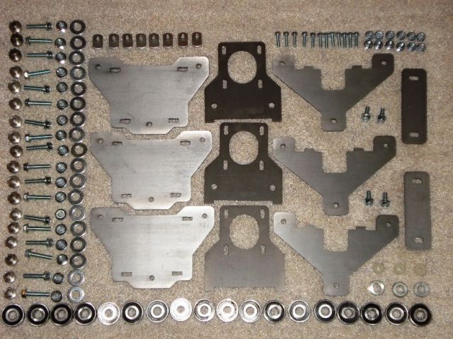

    that's a good price . working on my tracer this weekend so can make my plates to ride on the beams for the cnc table . got some pics so can run some prints to trace from .Click image for larger version.
ID:	6934 look fairly easy to make all ready have all the bearings and bolts and spacers.. bought a 100 roller bearings that should be enough lol

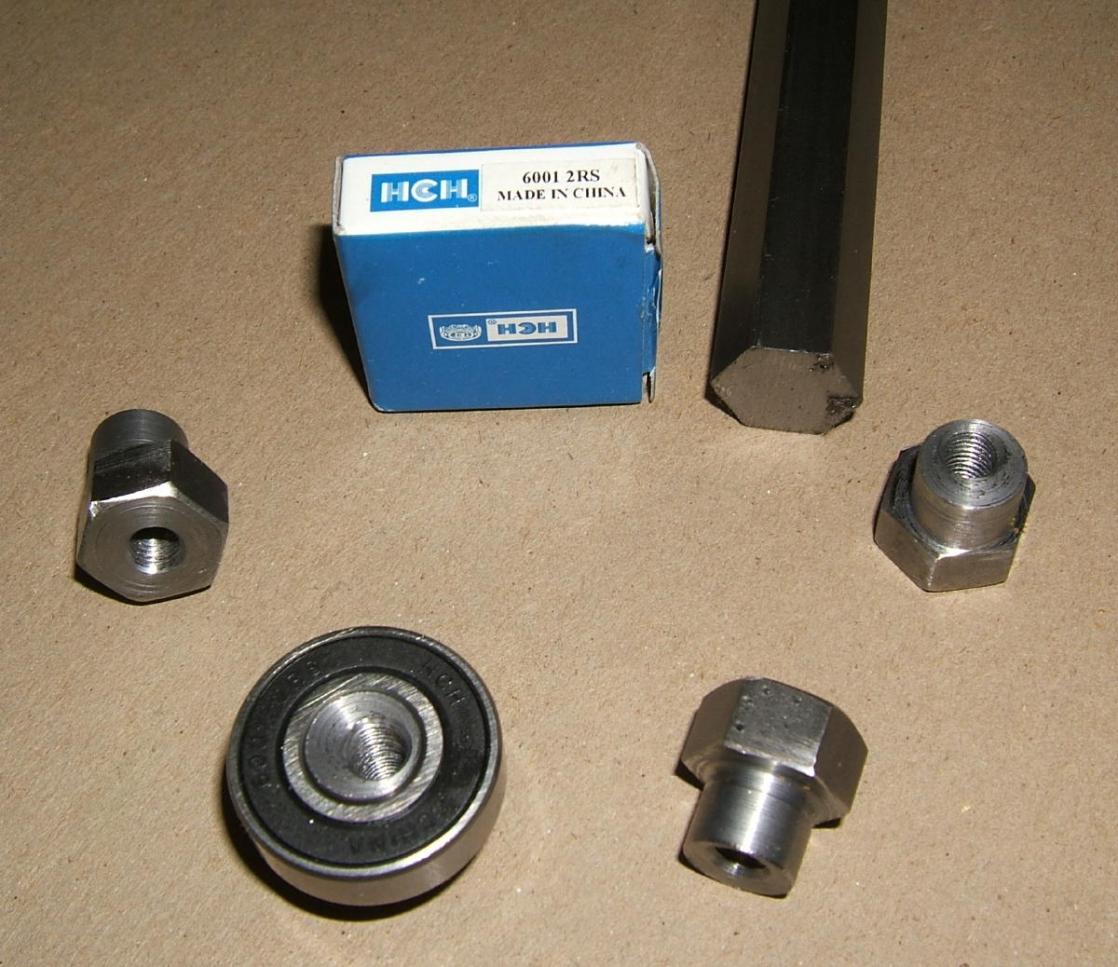

    Did a little machining today to make some eccentric bearing studs. Used on a CNC table for those who want to make their own.
    Eccentrics instead of slots for the bearing adjustments.
    Have fun
    Tom

    That is pretty cool. Great idea. Have you used eccentrics to make adjustments before? I'm curious how well they keep a set adjustment and whether they slip over time.
  9. #109
    they hold very well as long as clocked the rite direction. as rite direction excentric has to be in the direction as tightening on the bolt so it don't un tighten

    Got some work done today, I'm nearing the end of the fabrication phase. I'll be glad to get to the electronics phase!
    I decided it would be better to bolt the plates on instead of welding them. This will allow me to slide my carriages on and off without taking them apart on the rails.
    I needed to make sure my rails are properly spaced and the gantry would slide without getting in a bind.
    I was going to drill and tap holes for set screws; needless to say that sucks! I'm going to use the double sided tape that was required. I may go back and add set screws and loctite.
