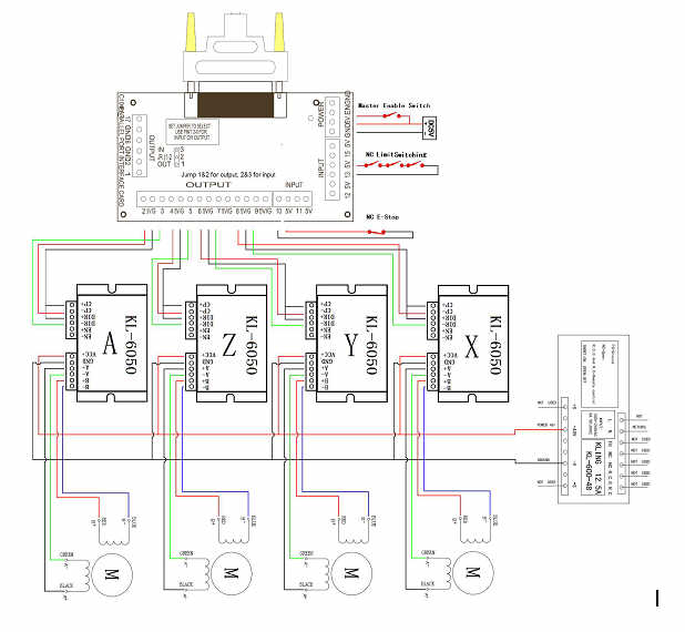

    I bought my stuff from Hubberd CNC talk to brent 916-368-2815.
    2--425 motor and drivers for them
    1---570 motror and driver
    power supply
    BOB board and power adaper.
    printer cable and software
    to my door $562.
    have fun
    Tom

    How did you wire your plasma cutter? Can you wire the torch without opening up the plasma cutter? Hubbard has some very good prices, and seems to have good reviews.

    Wiring the torch is simple if you use the one that came on your PC with a button on the torch.
    If it is an outside button just replace it with a small relay powered by the CNC electronics.
    If it’s inside just open the torch and find the 2 wires going to its switch and run them outside to a relay. Power on the plasma cutter machine when you ready to work, hook air to it and let the CNC computer run the torch when cutting. Check youtube and you will see many that did it that way. Many guys use the original torch and hook it that way.

    Thanks! I've been wondering why people have been opening up their machines to wire them up. Until I get a plasma cutter with a cnc port this is what I am going to do.
