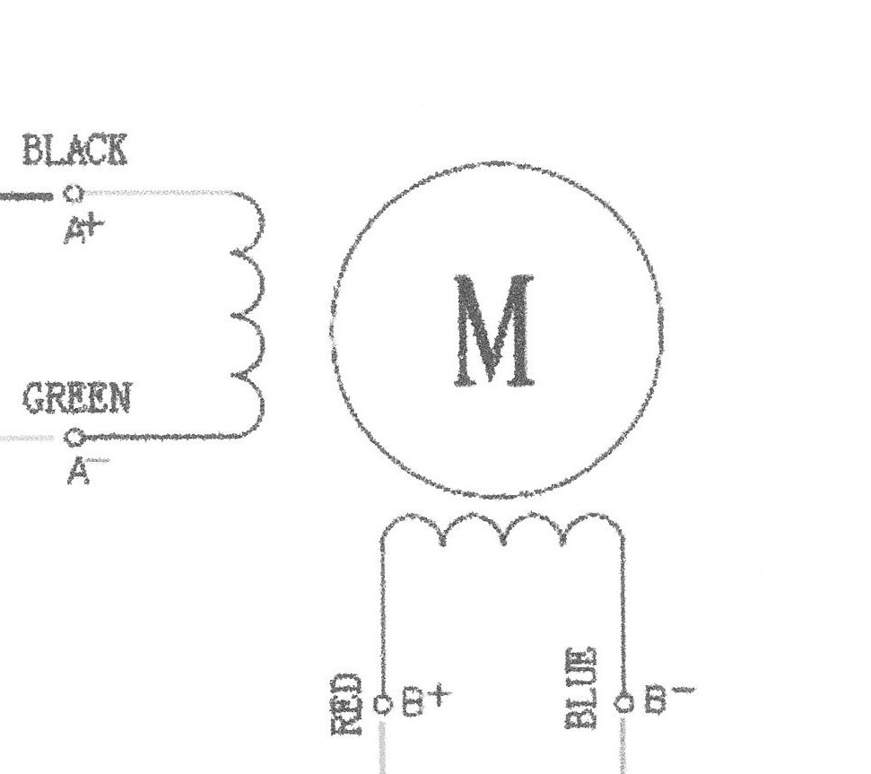

    You be getting close to making sparks. With mach 3 I would suggest you hook up the motors and do you setup for pin selection for the motors first. That way you don't need to think about any mechanical stuff or how fast they are going. These may help get you started.
    You select the pins under config. and ports & pins you must tell it the printer port which is 1 along with the other info (step port 1 and dir port 1 ) enable the axis you are using. X,Y & Z maybe A for the 4th.
    Load mach 3 and start it you will get a menu showing Mach 3 mil. Mach 3 turn, and plasma select plasma and use that until you get more info. All you changes will be kept in it. Or you can create another and call it what you want. If you want to copy or back it up its in the Mach 3 folder with a file extension of .XML (myplasma.xml example).
    Wire colors for the BOB to Driver inter connect.
    Plus 5 volts goes from BOB +5 volts output to each driver Pls+ wire color is orange. And from BOB + 5 volts to each driver Dir+ is a yellow wire.
    For driver X Pls- is violet, X Dir- is green Pins 2 and 3
    For driver Y Pls- is blue, Y Dir- is black Pins 3 and 4
    For driver Z Pls- is white, Z Dir- is red Pins 6 and 7
    All motor wiring is the same
    Driver output A+ is white, A- is red, B+ is green, B- is black
    The shields from each motor cable is only connected inside the controller to
    Have fun
    Tom

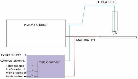

    I found some information on my THC so I'm getting close to figuring everything out.
    Here is a video of my THC working.
    The manufacturer's website, it's in Polish, but Chrome will translate into English.
    http://proma-elektronika.pl/cnc-plas...eight-control/

    wiring diagram.

    I spent some time on the phone with Jeremy from Probotix. I needed a little help for wiring up the plasma torch and THC. Eagle Plasma who sold me the THC was also helpful in wiring and MACH3 setup. So far I feel good about the Probotix kit and Eagle Plasma THC. I have a little bit left and hopefully weather permitting I can wrap this project up! After I get it up and running I will take it all apart and grind, clean, and paint!
    The relay board that will be wire to the start stop pins (1 & 2) on the CNC port.
    THC wired to the breakout board pins 10, 11, 12, and the negative for the common on the THC.
    10 - arc on
    11 - up
    12 - down and configured in Mach 3
    I have to wire the Torch Height Controller to my plasma cutter. My THC has to read full tip voltage and not divided arc voltage. I don't think I can use the CNC port on my PP60C to a proper voltage reading. I think I may be opening up the cutter so I can get a proper reading. The positive to read full voltage is that it will work with any plasma cutter. You can also adjust the height up and down while cutting, and this should help get good cuts.
