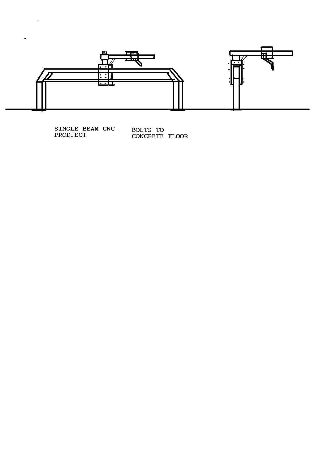

    yes but look at all the fun building it your self . I am going a different way on my build. to save space just using 1 rail system and making the upper arm unlach so can fold against the wall it will bolt to the concrete floor for support . a rough drawing of how i want to do it Click image for larger version.
    I guess one thing you'll need to be careful with is to ensure there absolutely isn't any play when the swing arm is locked and ready to cut.
    Sean, 5' x 8' is massive! (to me at least)

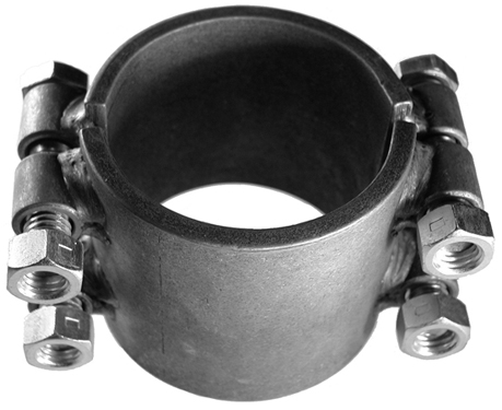

ID:	6817would most likely have cinch bolt clamps to lock it in place since they don't give or move when tightened . yes 5 x 8 is a big table takes up a lot of room
