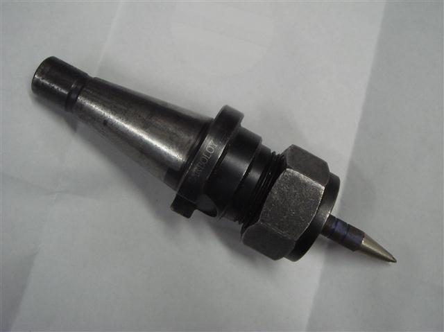

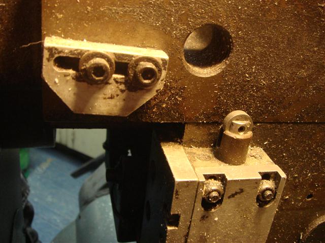

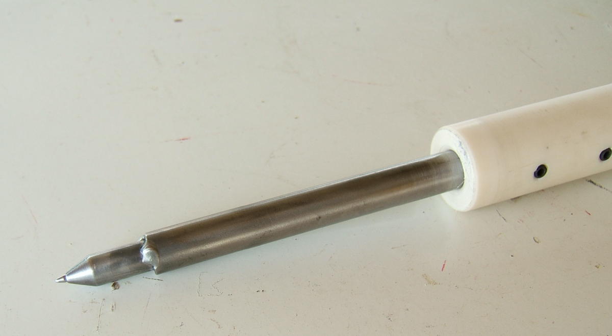

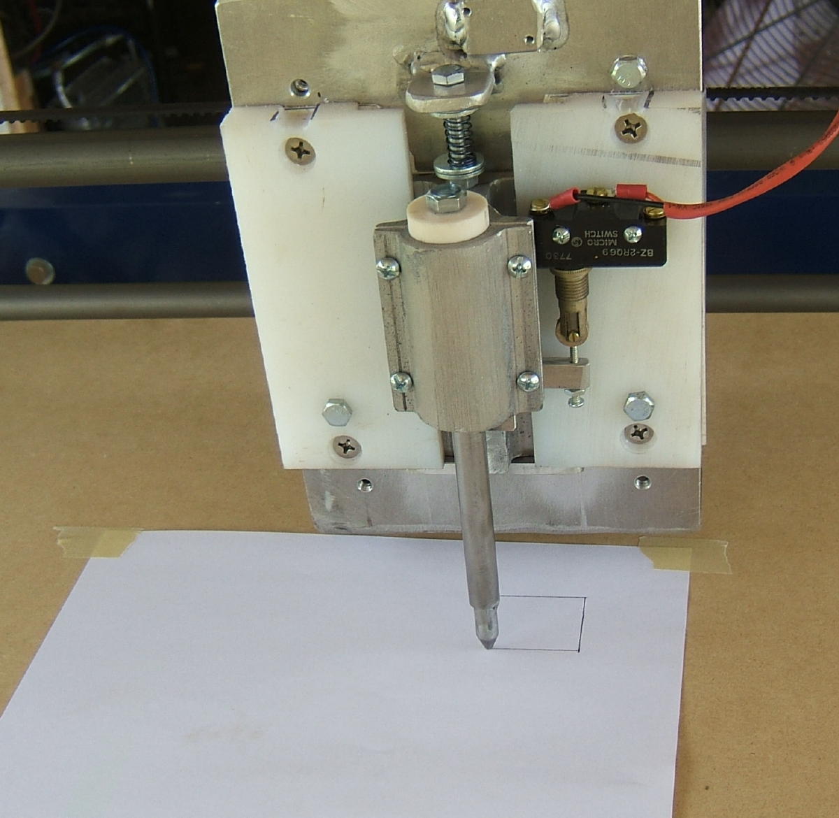

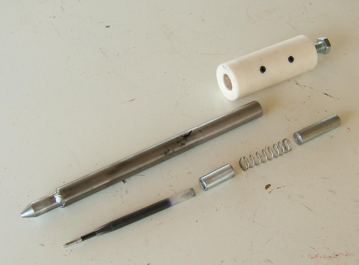

    Hi Sean
    I made a pen holder that fits in my torch holder so I can run routines and see what it looks like on paper. It also gives you a way to check the dimensions of the part cut. See the attached pictures of what I made and it has a spring in it and works with the floating head torch head.
    Have fun
    Tom

    I like that pen holder, that could come in handy. You could draw out patterns on paper or cardboard.
    Your right about sheet cam. For someone who has no experience with CNC and cam software it is fairly easy to pick up. Right now I have the table set up for the lower right hand corner because thats the location coordinates 0,0. The current setup is probably fine for running a single part, but it needs to be in the lower left hand corner. That would match the cad and cam software. I could change sheetcam to start in the lower right corner to match the current setup, but I want it to be right.

    I think you might be missing the point. Once you have your directions right, you can move the origin around from job to job between SheetCam and Mach and nothing will change. But right now you have a direction or two that are reversed. There are times where having the origin in a different place is real handy. Like if you have a part to cut that has some existing cuts or other things you have to line up on, like drilled or tapped holes. It's just more tools in your toolbox, as someone likes to say. Just imagine how you want your computer screen to lay on the table and that will tell you what your axis and directions need to be.
    Yeah, a pen holder can be handy at times.
    If you want to draw blueprints or patterns just dial your kerf setting down to zero and don't use lead-ins and you have made a nice plotter.

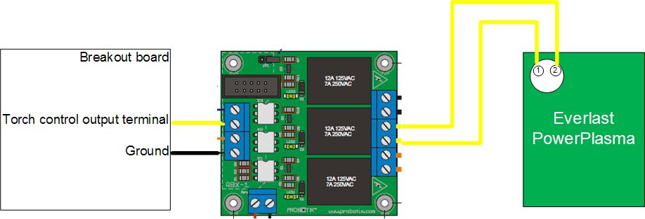

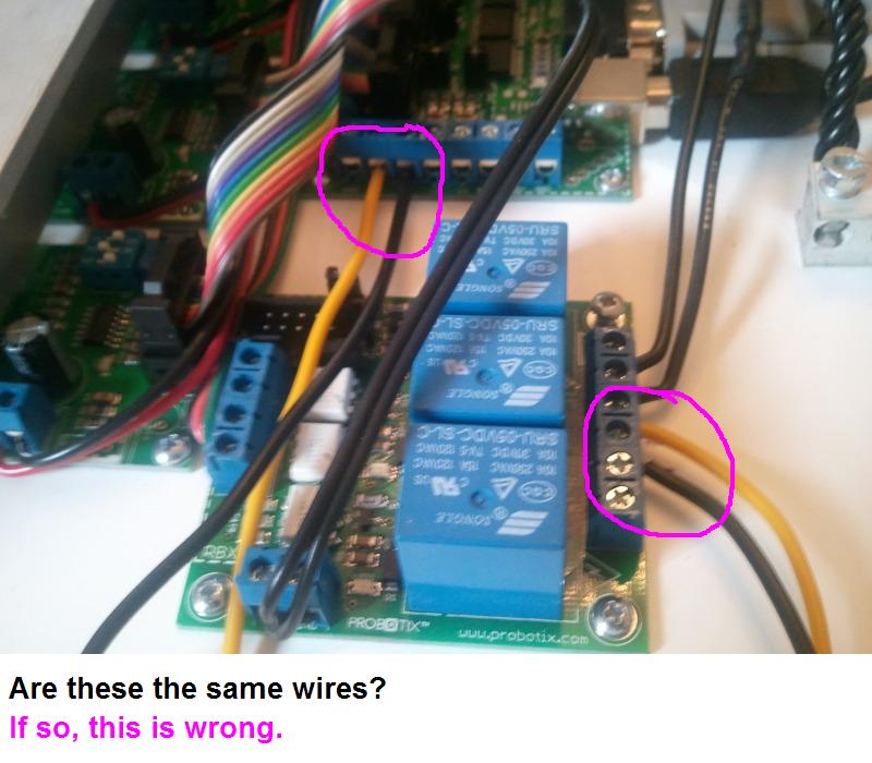

    I tried to make my first cut tonight, and I can't get my torch to fire PP60C from MACH3. I tried the F5 key and also ran some gcode and the torch never fired. As I run the code you can see the torch light come on in MACH3. I did not have time to check the wiring. Does it matter how the relay is wired to the cnc port on my pp60c?
    CNC Port wiring
    The relay board that will be wire to the start stop pins (1 & 2) on the CNC port.
    (5&7) on the CNC port are + & -
    The relay is wired on page 14 of this thread (pins 3 &4)
    Pins 1&2 came pre wired to something else.
    Breakout board wiring
    THC wired to the breakout board pins 10, 11, 12, and the negative for the common on the THC.
    10 - arc on
    11 - up
    12 - down and configured in Mach 3
  14. #194

    I think it's not wired correctly. The yellow and black wires are 1 and 2 on the cnc port. They had me wire the torch on and off to the 2 and 3 pins on the other ac/dc circuit side (right hand side according to the manual). I'm thinking that it's not making the loop, and that either cnc port (on pp60c) pins 1 or 2 need to be moved to the relay 1,2,3 side. In other words the ac or dc circuit is the input and the relay 1,2, or 3 is the output.
    I will also check mach3 to make sure the relays are not turned off.

    It look like the output is connected to the orange wires for the lower relay, if you have an ohm meter you can check to see if it’s working. Hook the ohm meter to the orange output connections and hook the orange connection to the output of your controller and ground to the black connection unless you are using the PBX-FF connector. Use the trigger I talked about above in Mach3 (m3 on m5 off) the ohm meter should show a short (0.0 ohms) when M3 is entered and no ohms when M5 is triggered. If you get 0 ohms (short ) when checking then the problem is at the CNC connector on the PP60C. If you are not working the relay then it’s in Mach3 or the hook up with your controller. Zero ohms and no ohms are not the same, zero ohms is like the leads on the meter are connected to each other and no ohms is like no connections at all. Another way is 0 ohms is relay contacts closed and no ohms the relay is not turned on.
    Just trying to help
    Tom
    P.S. you want to use the lower or middle connection and relay for the torch LED #1 should be lit if you at triggering the relay. Are you supplying +5 volts to the circuit board??

  19. #199
    I was going to call probotix today, but I've been sick all day. I have not looked to see if the led comes on when I trigger the torch in Mach3. I have not shorted pins 1 and 2 on the torch. If I'm feeling better I may give it a try.
    The two black wires at the bottom of the second pic are the 5 volts.
    I wired the torch trigger the way tech support told me to wire it, but I'm thinking they told me wrong. I wired the torch the yellow and black wires to the two pins marked yellow on page 2 of the manual. I'm thinking that one of those wires needs to go to the relay #2 switch marked yellow on page 2 of the manual link.
    I'm still going to check everything before I do any switching of wires. I probably will ohm that yellow 2 relay on the left hand side of the board.
  20. #200
    Hope you feel better, soon.
    Yes the torch does need to wire to the two terminals that have yellow wires in the manual. Those pins short when the relay is energized. Do not wire loads to the relay #2 Ctl (+5V) terminal, that is the input from your breakout board. I can't see all your wires so you might make a little sketch of how you have things hooked up.
    But the job of this board is to switch high powered loads and protect your breakout board and computer port. The output from a computer can only power a small LED, even test light can burn them out. So this board does the high powered switching. The opto-isolation part means that the switching is done with light, inside the chips, so there is no electrical connection between the inputs and outputs. When +5V is applied to an input, the corresponding two output lines are shorted.
    So you should have a wire from your breakout board outputs to the Relay #2 Ctl (+5V) And your CNC plug pins 1 and 2 should be wired to the two terminals that have yellows wires and are marked Other AC or DC Circuit.
    BTW what are you using Relay #3 for?
    This is how the input and output should be connected. I left off the power lines, but those need to be there and be correct for + and -.
