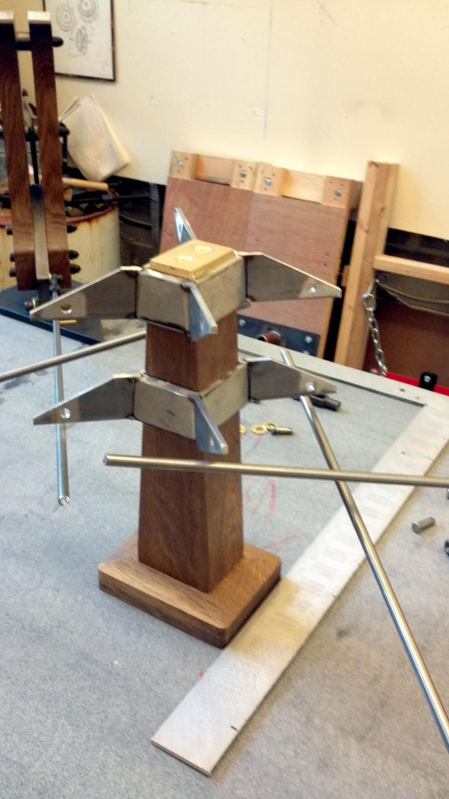

    Here's some pics of the legs and center post. I have some work to do aligning the connecting rods that go from the legs to the post

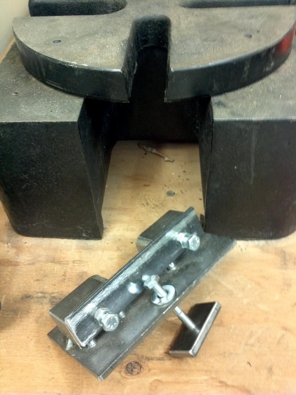

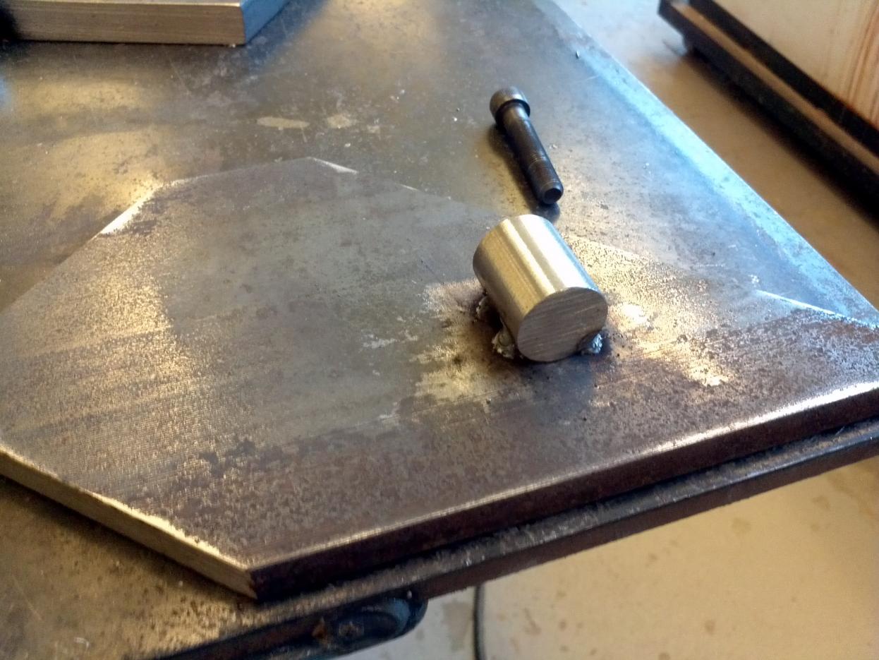

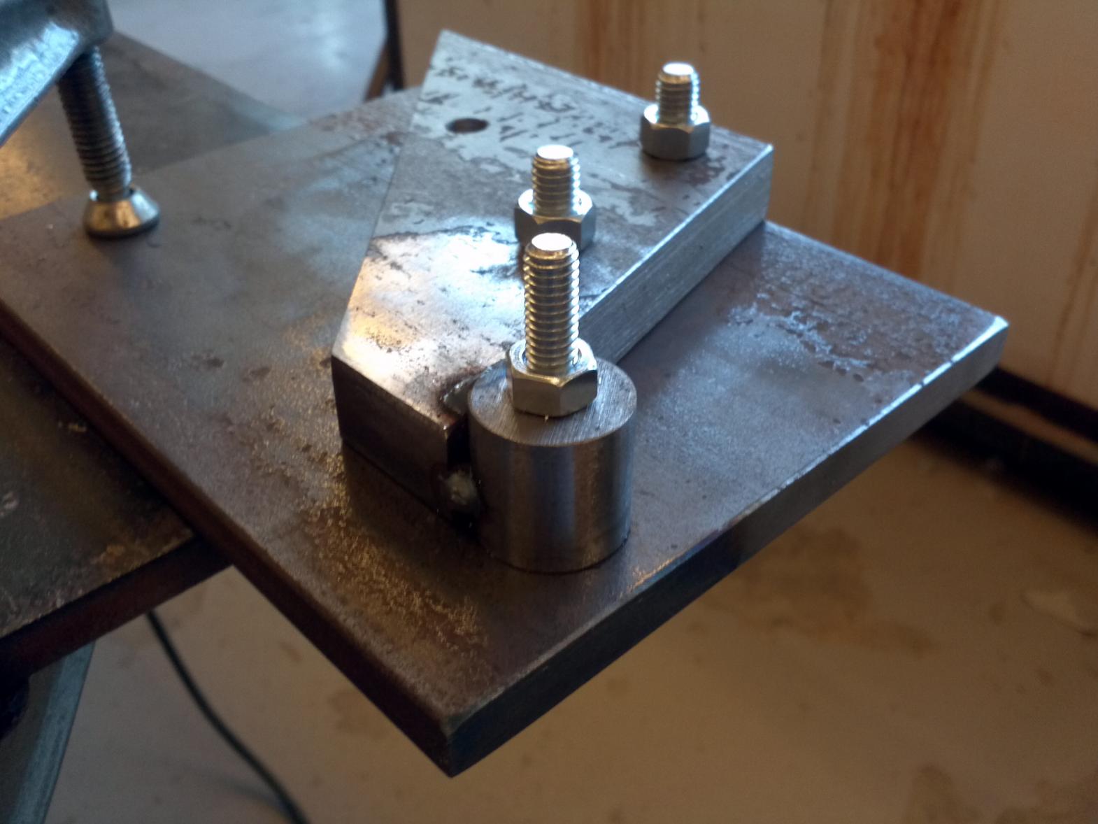

    Here are a few images of the jigs I created to make the corner plates. Because I am welding round bar to plate, I have to do a lot of filler-welding and then grinding to blend the two together, sort of a pain, and something I would maybe change in the future. I'm saving my pennies to get a tig welder soon, then I'll concentrate on making attractive welds and try and forget about the grinding...after the pieces are tacked together, I remove the jig and do all the finish welding

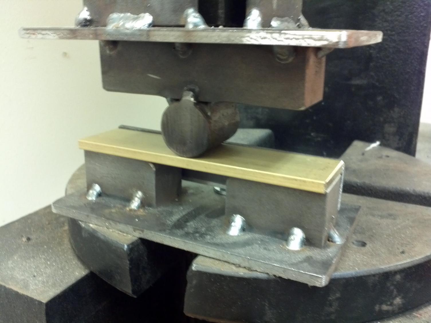

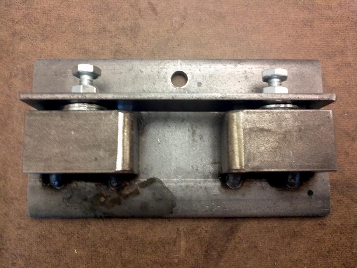

    Another jig to make a contoured brass cover plate. This jig is made for use in a manual arbor press. The one I use is rated at 3tons. I'm sure you could get away with using a smaller press, it's just what is available to me. Pictured below is the female and male parts of this forming jig.
ID:	5362Click image for larger version.
    The jig was made to hot form 1.25" x 3/16" brass (alloy 360). Other metals and widths can be used, but the jig is specific to the 3/16" thickness. You'll see why later, or you probably already know why.
ID:	5364Click image for larger version.
ID:	5365Click image for larger version.

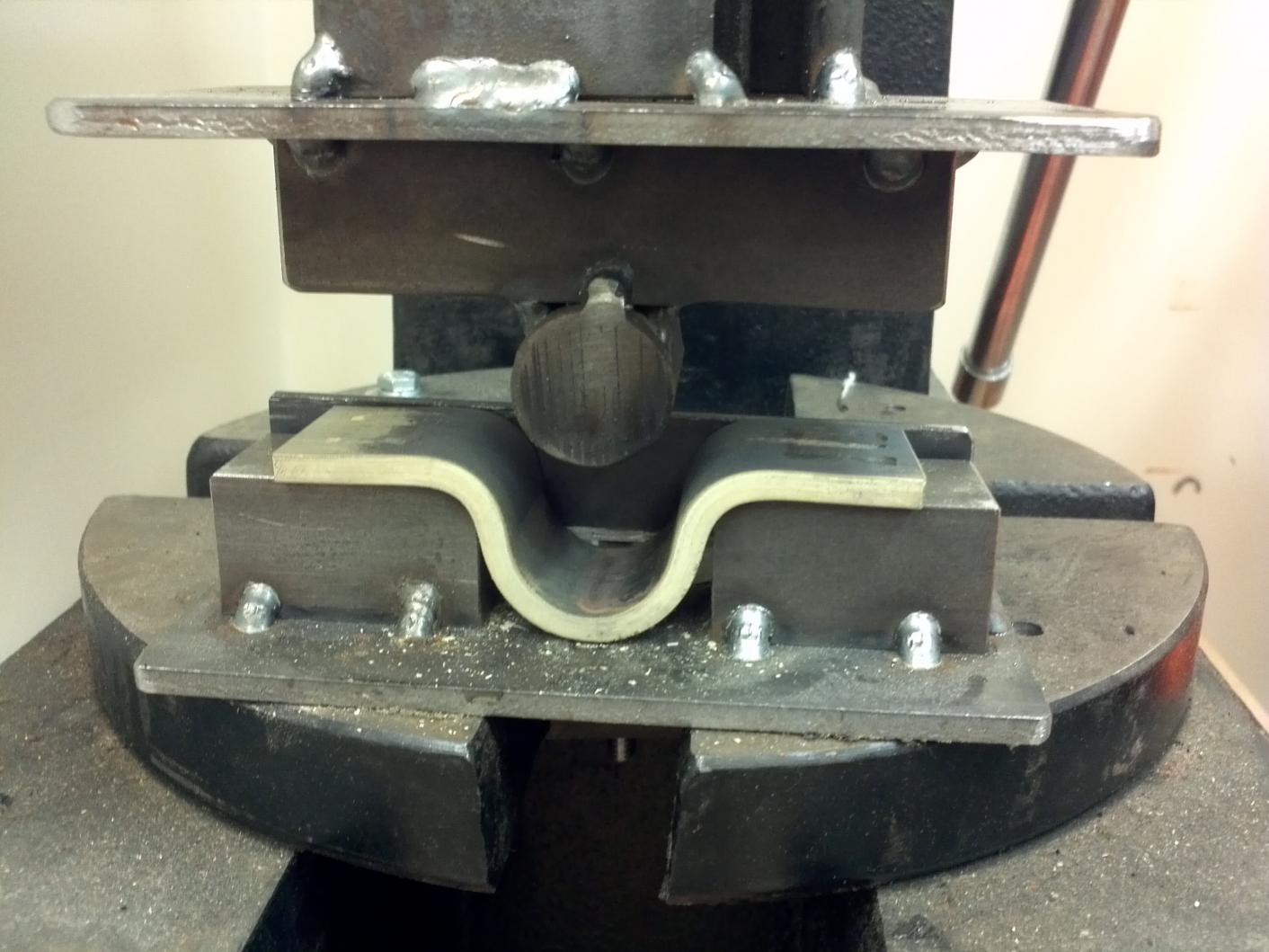

    The brass is then heated till glowing a dark red (best viewed in low light), the then transfered to the jig, and pressed into form with one pull of the handle. The transfer does not have to be super fast, as forming the brass while too hot may cause it to crack. Some minor tweaking on the anvil is necessary afterward.

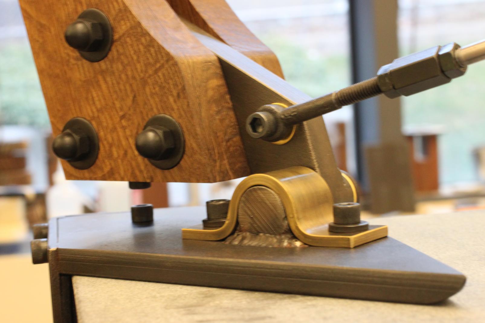

    Here's a detail shot of where the leg meets the table. This is also where I installed the previously mentioned brass plates to cover the transition in between the round bar and plate.

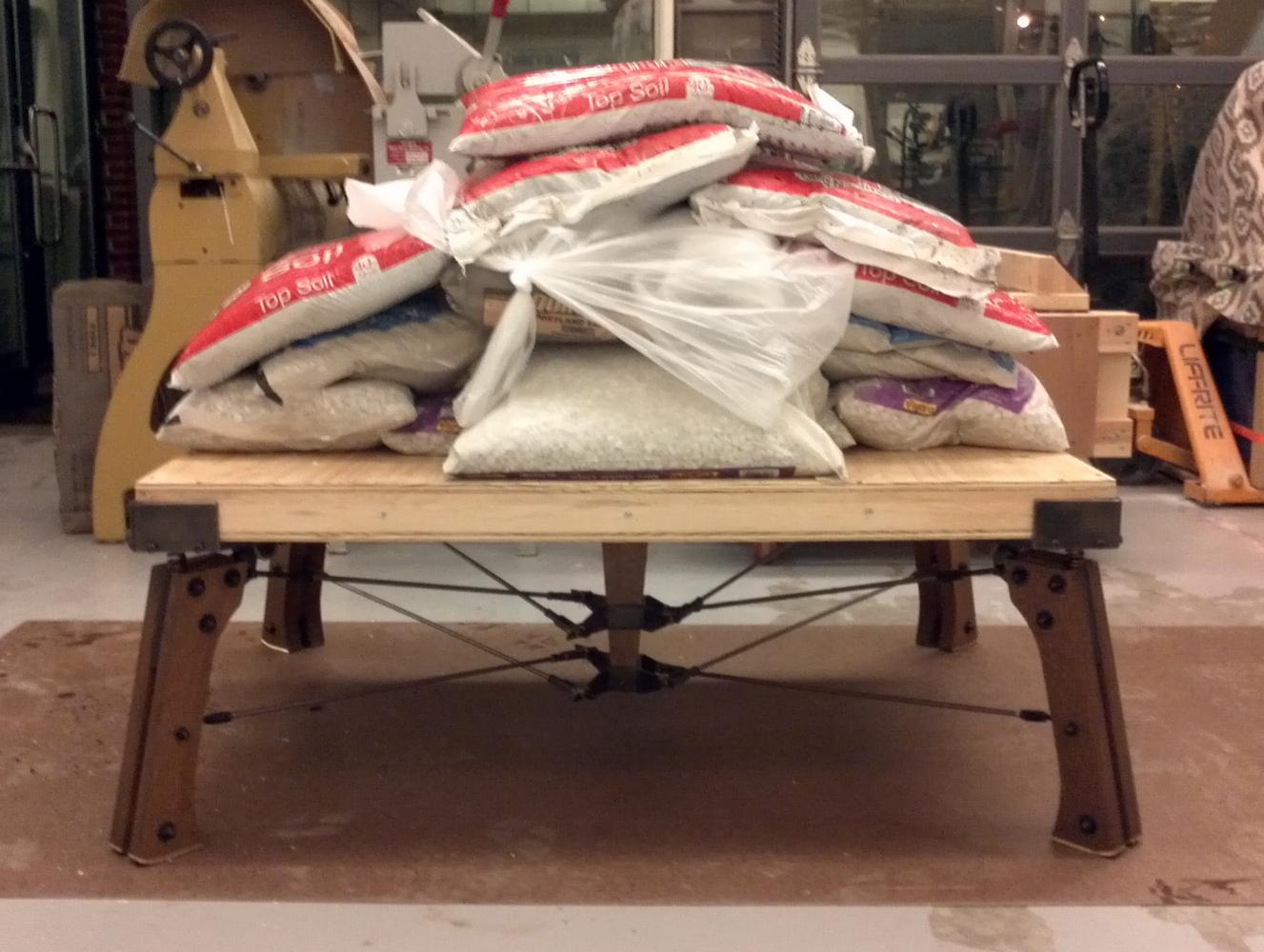

    This design is pulled out of my head, no help from any computer design programs. Therefore I wanted to simulate a test to get an idea of how this base would react to weight. Overall, the test went well. I made a wood insert to pile weight on top of, found around 600 lbs of various bags of cement, stone, and dirt laying around the shop, and slowly started piling. My overall goal is 1140 pounds, so after all the weight was on, a fellow studio mate (260 lbs) and myself (215) both stepped on. Success! Nothing crashed and all was stable! Next step is the granite, but that won't happen for a few days.
