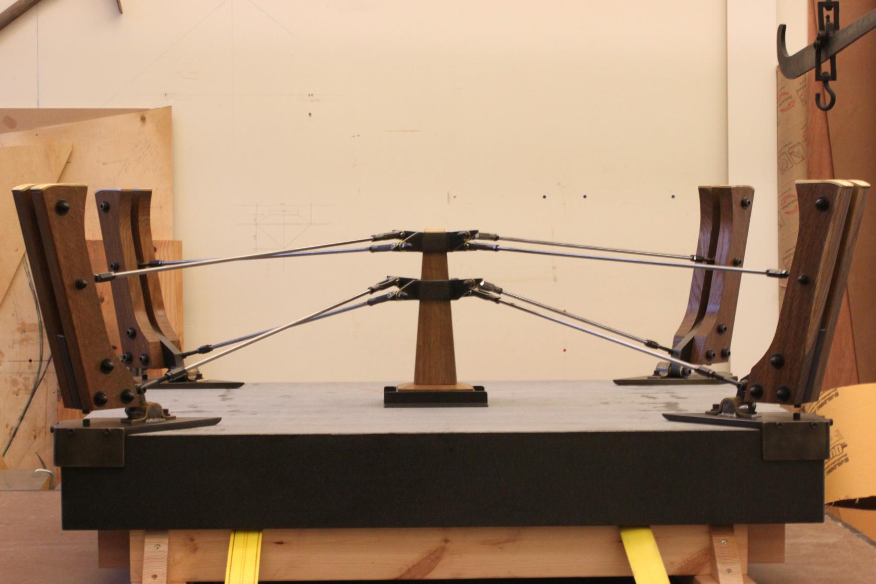

    This is one of my current projects. It has been in the works (off and on) for the last two months. I wasn't exactly sure what category this fits into because it is made equally of metal, wood, and granite. It has a good amount of welding and machining. The parts are either identical or mirrors to one another, so I made several jigs to reproduce each piece. I plan to make more of these tables if this one succeeds, so if I get lucky, I won't have to reinvent any parts in the future.
    The idea of the piece revolves around the size and weight of a 3'x4'x6" granite surface plate. It weighs approximately 1140 lbs. The base for the table will act using tension, to clamp each corner of the plate. No mechanical attachments will be used.
    So up till this point, I have fabricated four legs and a center post. They are made from mild steel, brass, some aluminum, and quartersawn white oak (about 1 1/4" thick).
    This photo shows the surface plate on my workbench. The plate was shipped right side up, but I needed to build from the bottom. I made crate that allows me to lift the plate, set it on the side pins, and rotate (or flip upside down).

    Here's some pics of the legs and center post. I have some work to do aligning the connecting rods that go from the legs to the post

    This design is pulled out of my head, no help from any computer design programs. Therefore I wanted to simulate a test to get an idea of how this base would react to weight. Overall, the test went well. I made a wood insert to pile weight on top of, found around 600 lbs of various bags of cement, stone, and dirt laying around the shop, and slowly started piling. My overall goal is 1140 pounds, so after all the weight was on, a fellow studio mate (260 lbs) and myself (215) both stepped on. Success! Nothing crashed and all was stable! Next step is the granite, but that won't happen for a few days.

    Well, it's been a long week. Finished a few projects including the surface plate table. Here's some shots of yesterday's action. The first photo shows the setting in place awaiting the arrival of the surface plate. The second photo shows the table set in place. At 1200 pounds, and only set in by tension, this table is more stable than I could have imagined. It won't be in my house anytime soon. Its best viewed from two feet away, for safety's sake...
