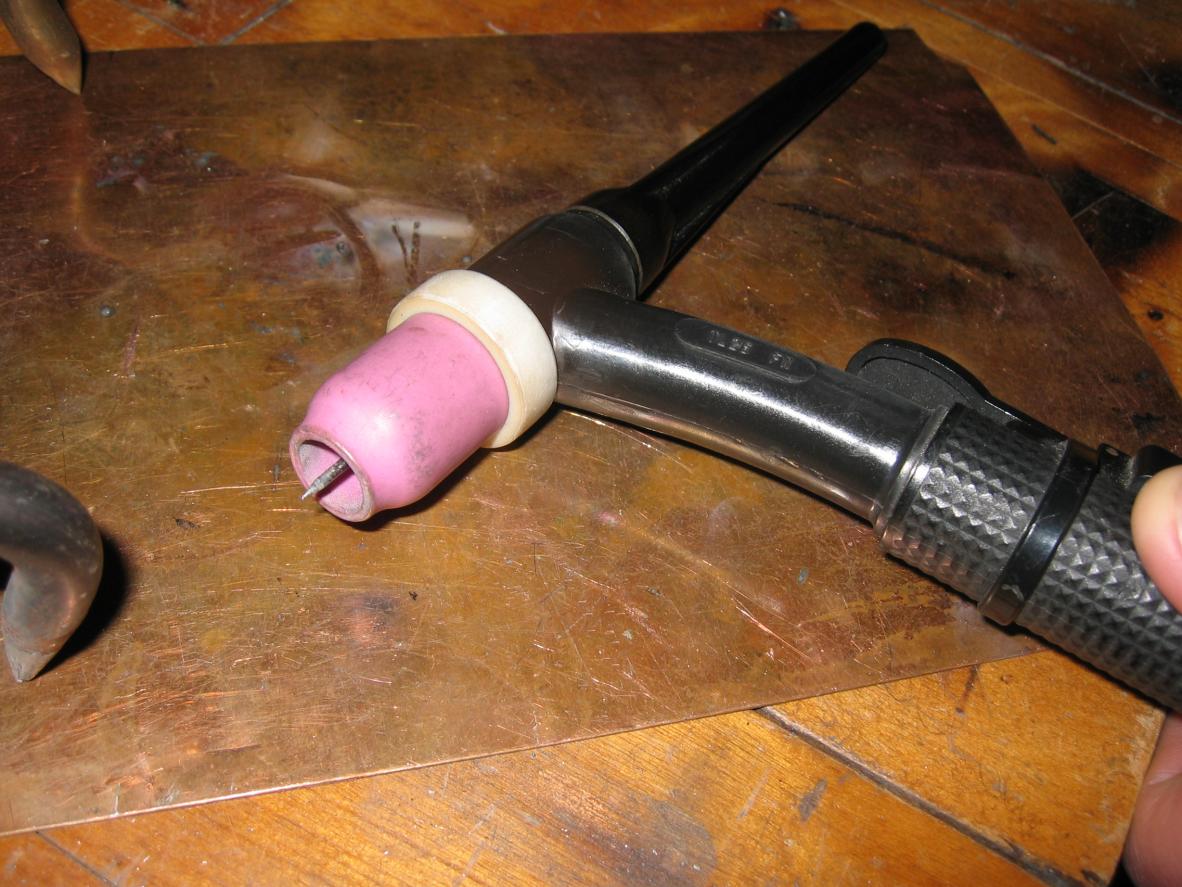

    I used 1/16" 5356 filler rod to weld it, also using pure argon, 50% EP AC Balance, 10 amps @ pedal full down (I actually intended to dial in about 25 at full pedal down, but checked where it was actually at after I was done welding, and found it was only at 10 amps full down), and a pretty sharp, 1/16" tungsten.
    Picture of the tungsten after welding:
    The arc was often not that stable. Probably would have gone better if I dialed in a bit more current at pedal down. It usually would start after an initial brief "sputter", lift pedal, and retry and it would work.
