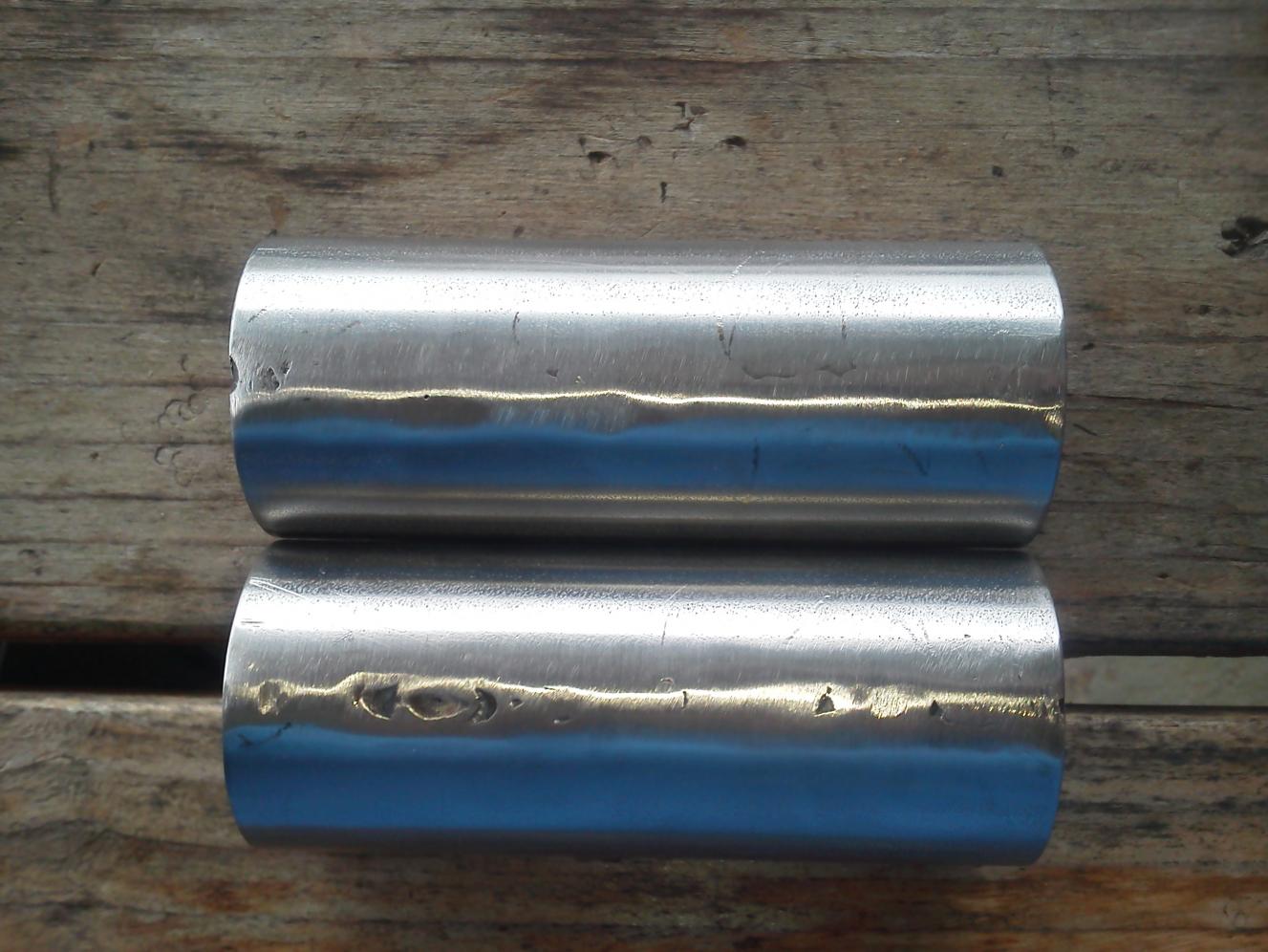

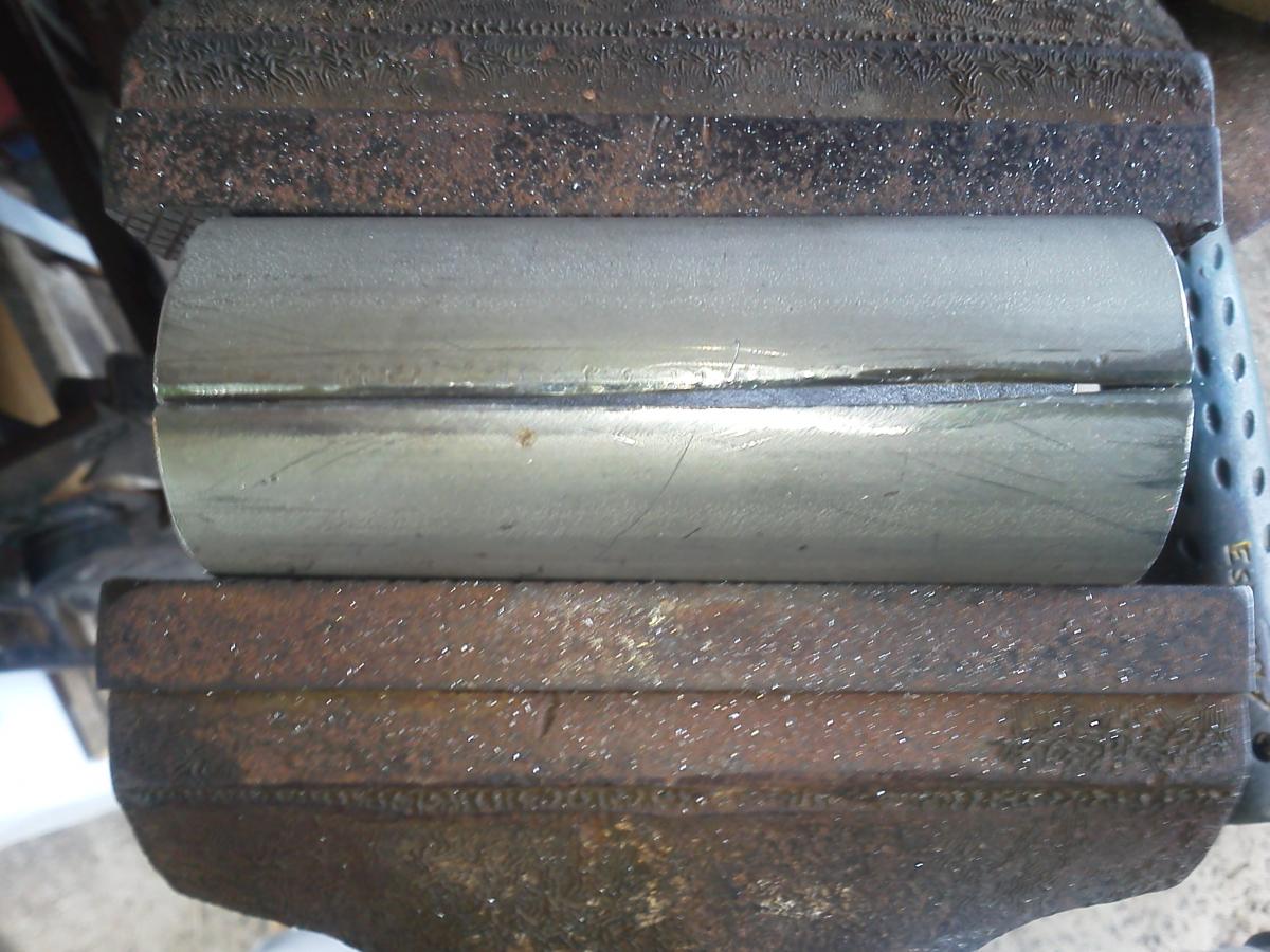

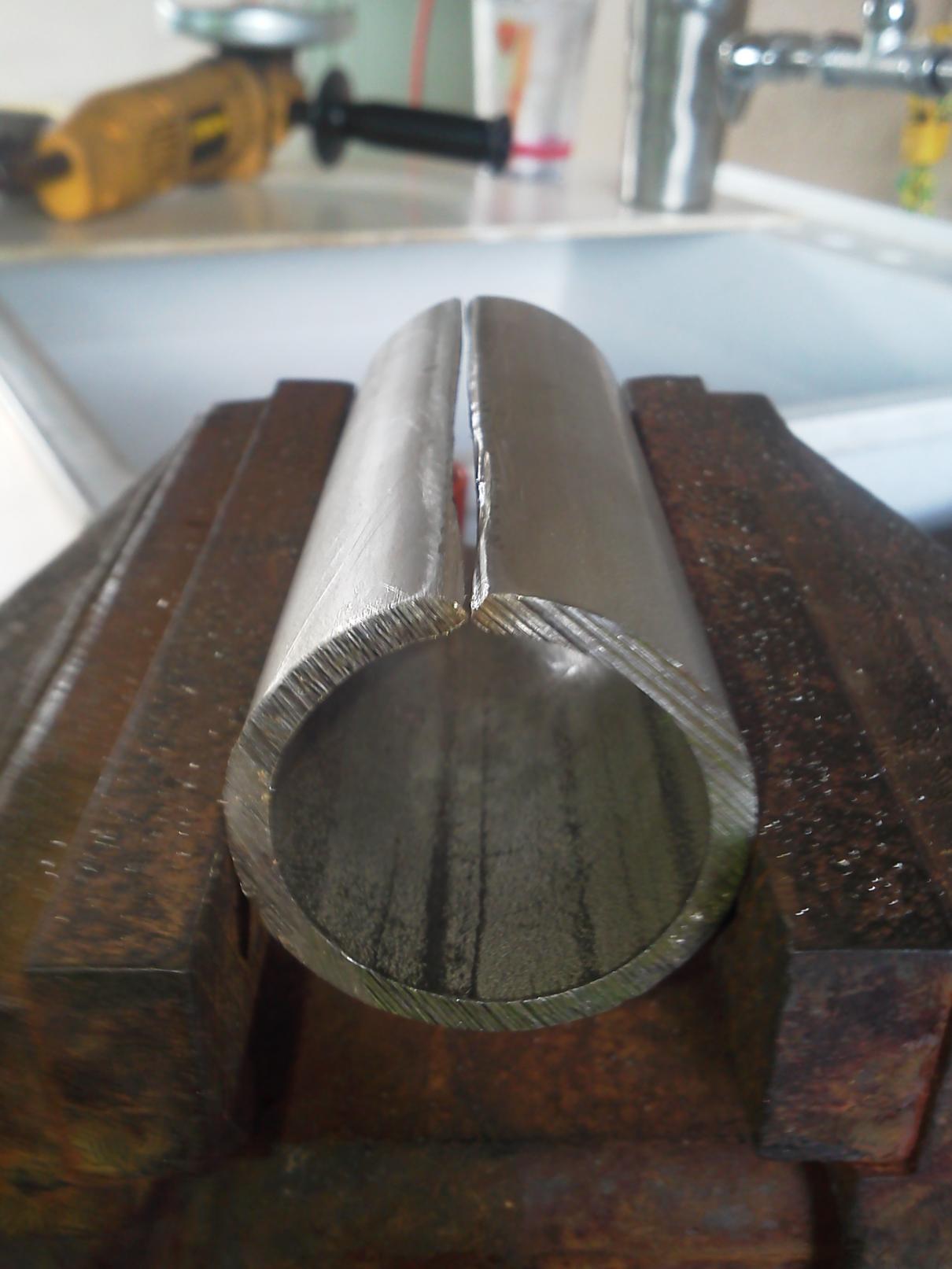

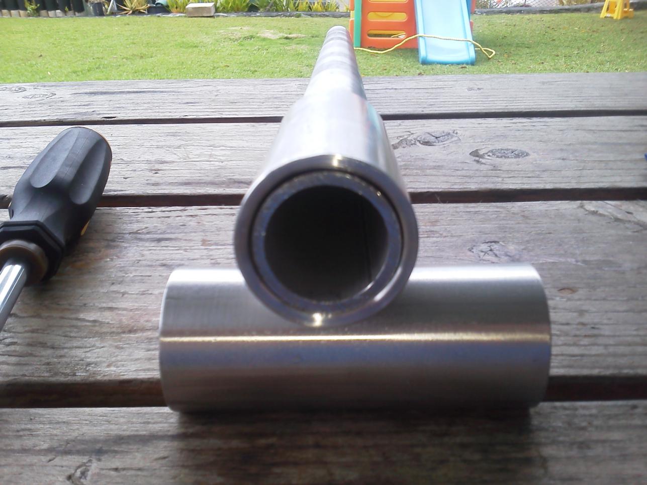

    I want to make some telescoping stands and am planning on using SS 1.25” Sch 40 pipe and SS 1” Sch 40 pipe. I have cut the 1.25” pipe to 4” lengths then cut them vertically with a .125” cut-off wheel and need to weld the pipe back together (see pictures). This will give me the tight tolerance I am looking for. The first 1.25” pipe I cut has a gap between .125” - .188”, and the second is .125”. I have read that people use copper as a backing for SS so my plan is to put some solid #4 copper wire on the inside of the 1.25” along the cut and weld the pipe back together. I need the inside of the 1.25” pipe to be smooth so the 1” pipe slides freely.
    My questions are:
    Does the copper and SS filler not weld together?
    Does this sound like it will work?
    If not any suggestions?

    #1 - No, the SS and the copper will not weld together.
    #2 - 4 gauge wire is only .2" diameter. Seems a little flimsy to me. Could you even straighten it well enough? (since the wire came spooled, it is probably not even straight to begin with?)
    #3 - You might consider getting a 6" or so long piece of 1/2 or 3/4" copper plumbing tubing, and clamp that at either ends using small c-clamps. It should be rigid enough to easily clamp at both ends with small c-clamps. Maybe you could even just clamp the copper pipe in the jaws of the vice with the end hanging off to the side, and hang the stainless steel pipe on top of that to weld to it. I don't think you could do either of those with 4 gauge wire. There are thicker solid copper round stock available from places like onlinemetals but I was thinking copper plumbing tubing might be more readily available for you.
    Alternately, you could use a thick aluminum pipe/tube or solid round as a backer for stainless steel. Try to keep the direct arc off of the backer.
    Nova Scotia, Canada
    143
    No, the SS filler will not stick to the copper. You can use aluminum too. In fact, to get the effect you're looking for I would suggest a bigger aluminum bar (at least 1/2"). There won't be enough heat available to melt either.
    If you're new at welding stainless, there's a couple things to know. The unprotected side of your weld will grow big black oxide crystals if left unchecked (ie, back purged). A close fitting chill bar (what you're talking about) will limit this as it limits the amount of oxygen available to the weld. If you want to eliminate the black crud entirely, you can back purge with argon. There's also Solar Flux which I guess you can stuff between your chill bar (copper) and the weld to take up the headspace but I haven't tried it myself. If you don't care what it looks like inside, but just want to prevent the weld from ending up intruding into the ID, your bar will work fine.
    The second thing is that stainless warps, due to the two-punch high coeff of thermal expansion and (for a metal..) insulating properties. The shape is good for that but I'm worried they may end up a little bent. Take your time and go with short welds if you want to prevent warping. (Good contact between your chill bar and the stainless helps, but I don't think you can really have that with a piece of round.
    Since you've got the SB, I suspect you've got some larger hunks of aluminum round around.
    EDIT: jakeru you beat me to it!

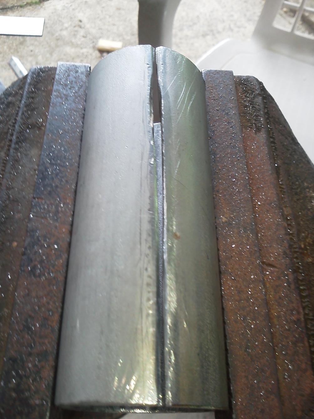

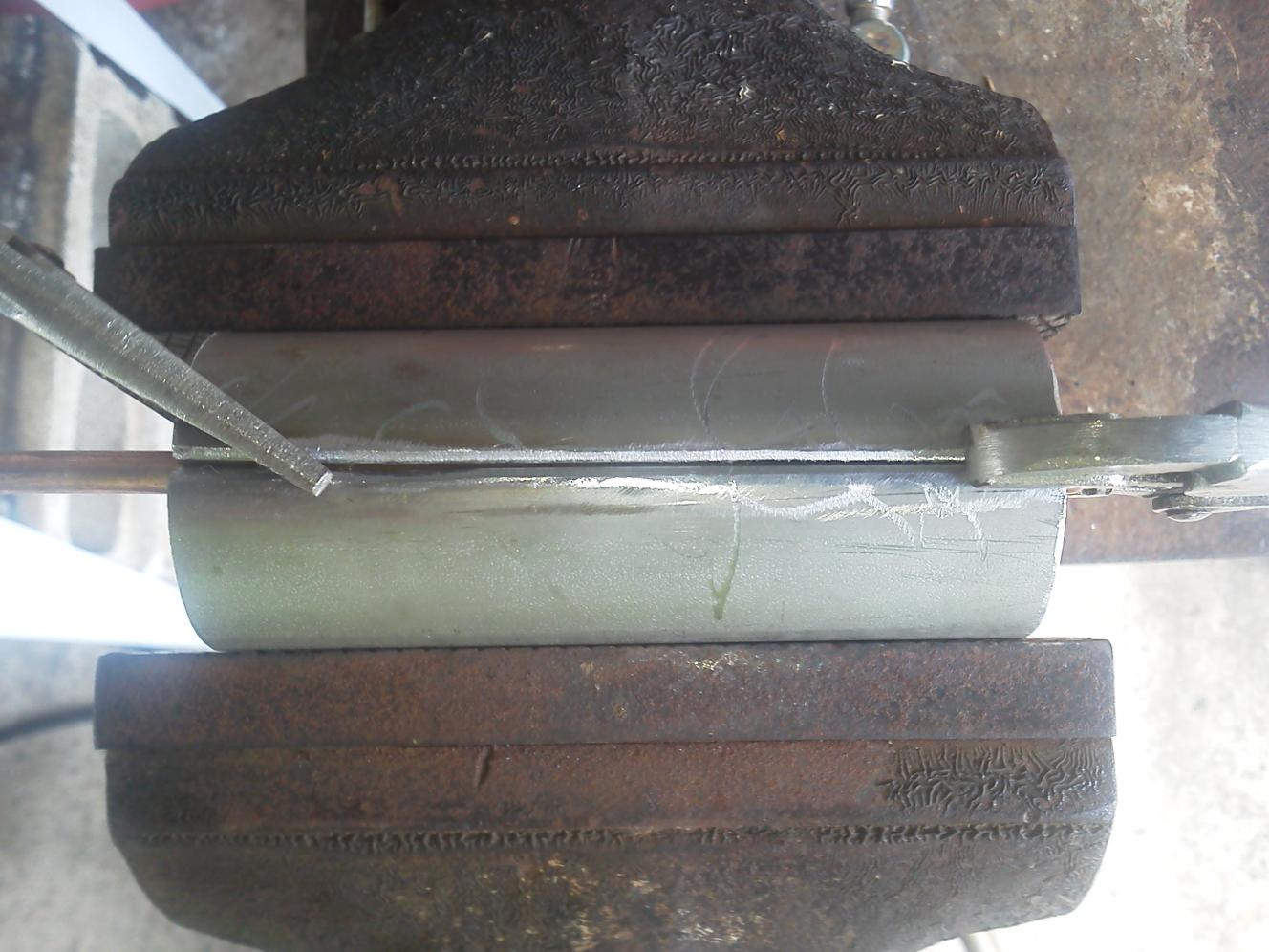

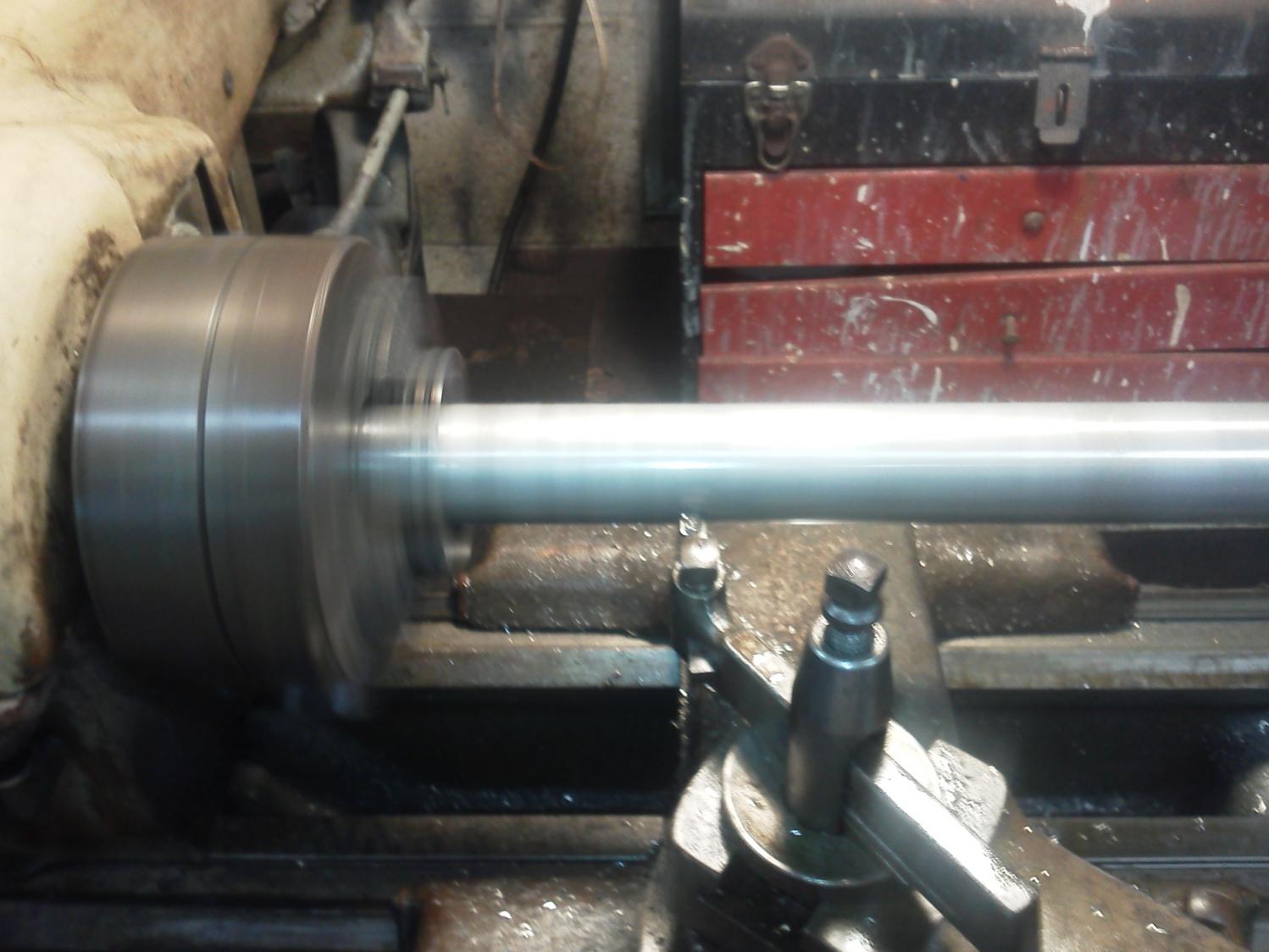

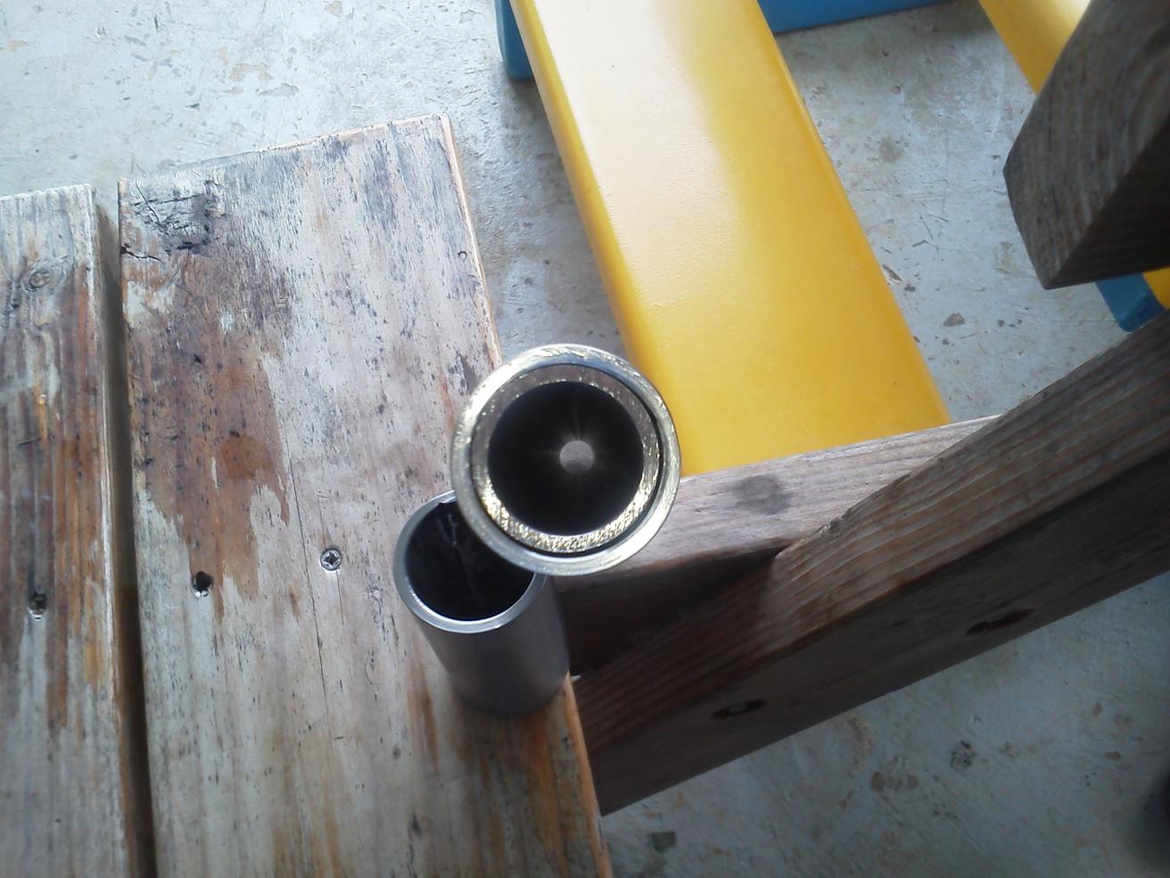

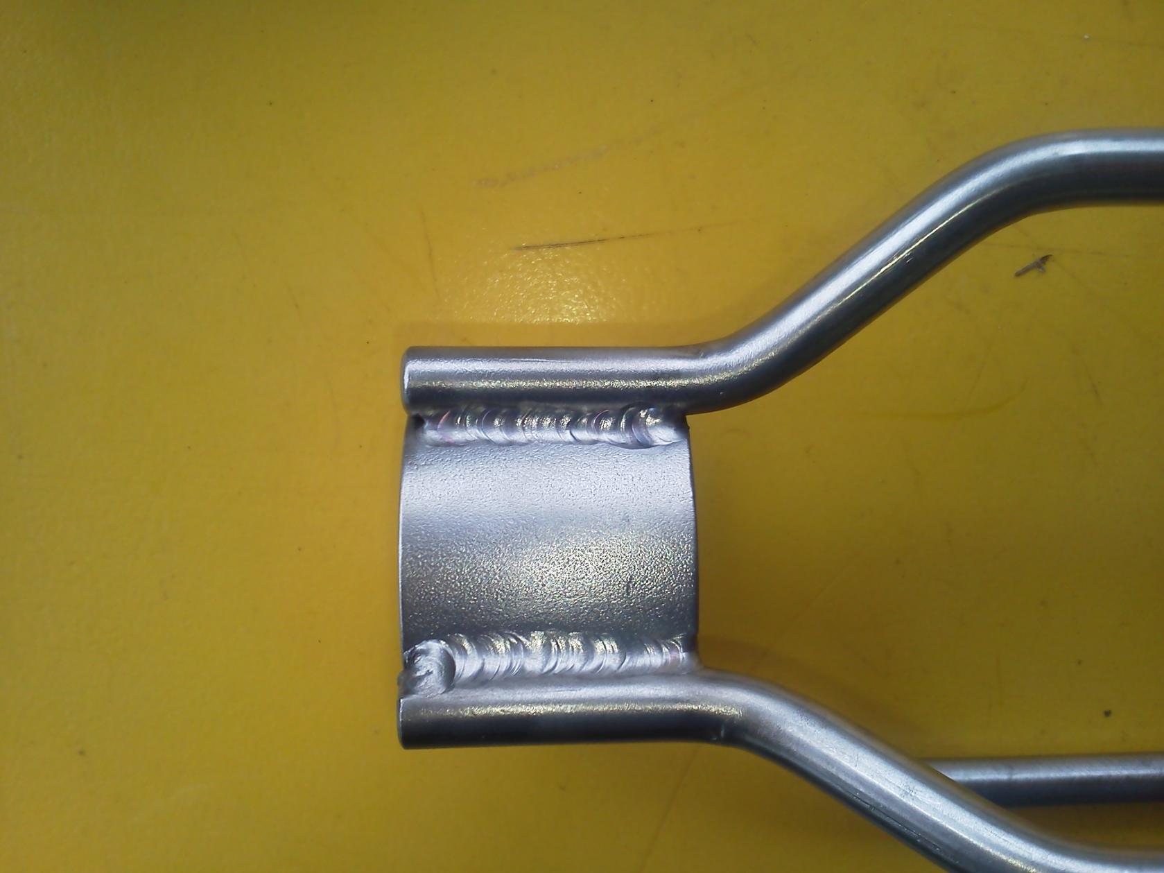

    Here is the progress from this weekend
    I used the #4 copper wire b/c it was easy to clamp and with the aluminum I have I could not get it to clamp right.

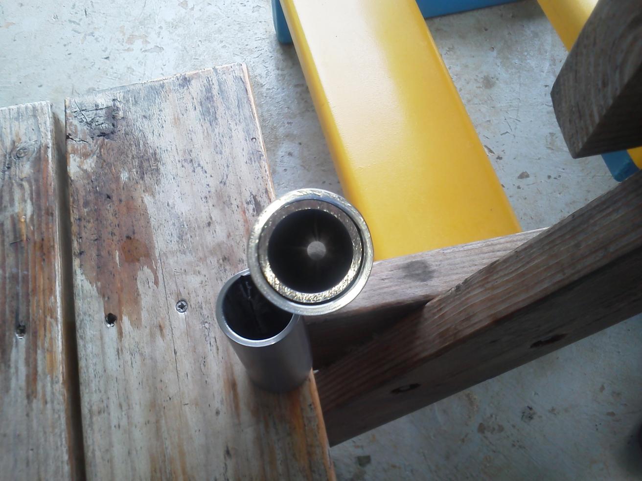

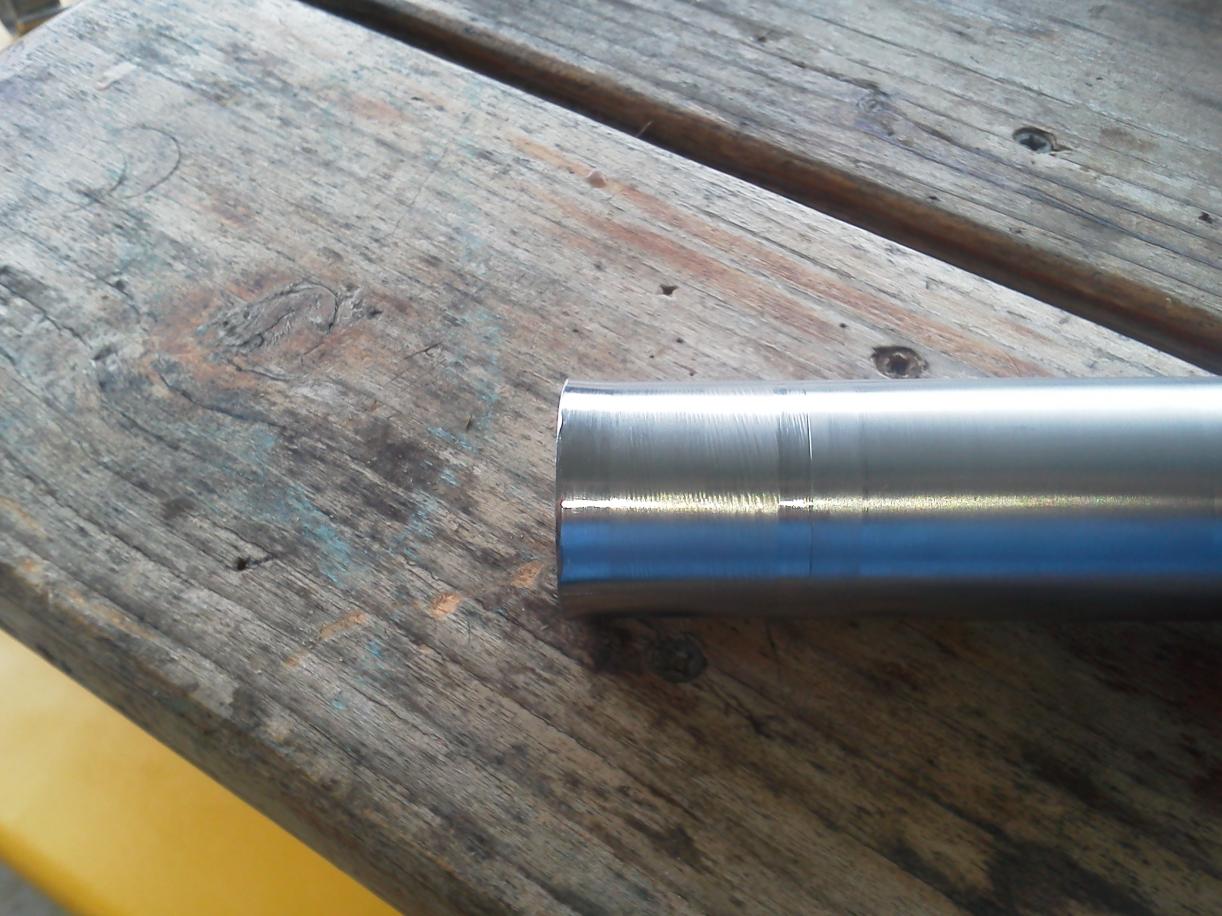

    Welded
    Ended up being tighter than I wanted so I had to turn the inside tube down. I took it down ~.018"
ID:	5439Click image for larger version.
    The outer tube did warp slightly so the fit is a little loose, but it will work.

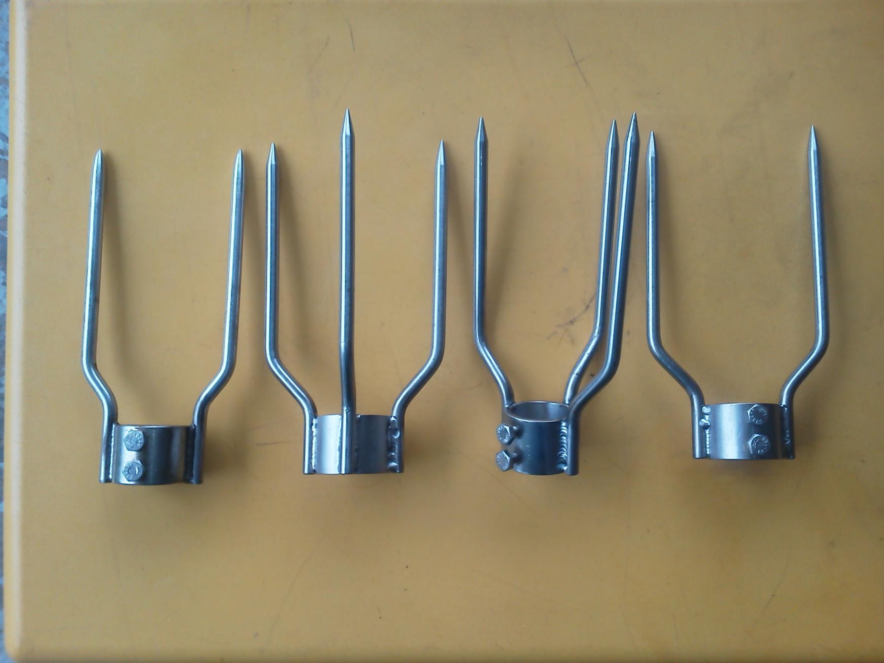

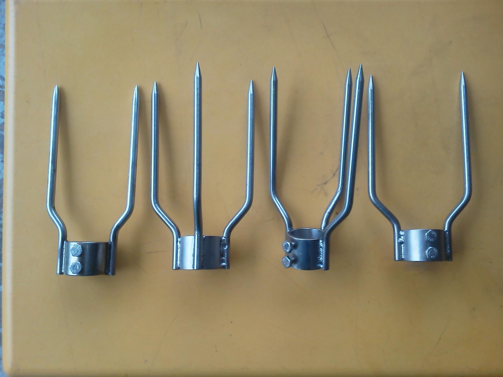

    I also made some prongs to secure the meat to the spit
ID:	5445Click image for larger version.

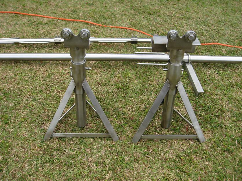

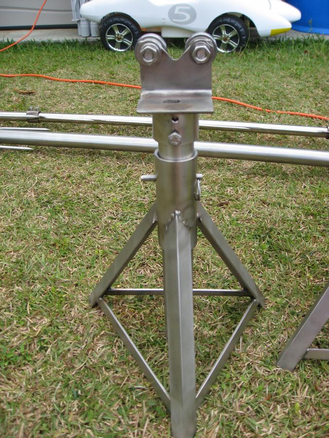

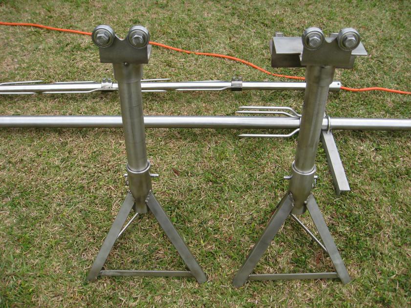

    I finished the stands this past weekend and I think that they will work. My only concern is the width of the base, next time I will make it bigger and use larger tubing.

    Nice project you've got there. I especially like the prongs. Making my mouth water ....
    I learned a lot from this thread - including pickling metal. Always nice to see a project unfold and learn something. Cheers!
    Thanks Undercut. I have not had a chance to do the pickling step yet and some sopts need it. I hope its not to late.
    PowerPro 205
    9" South Bend Lathe
    Enco Mill/Drill
    Somewhat off-topic ... did you change your avatar recently? Bloomin' big fish!
    Glad to see someone else who completes projects in the same time frame as I do. Good on ya mate!
    Is that hand cranked or will it be motorized?
  20. Default
    Red I would like to complete projects sooner but I only have Saturdays to work on my projects. It’s hand crank only if the motor quits. Here is a link to the whole setup: http://www.everlastgenerators.com/fo...li-Huli-Setup)
