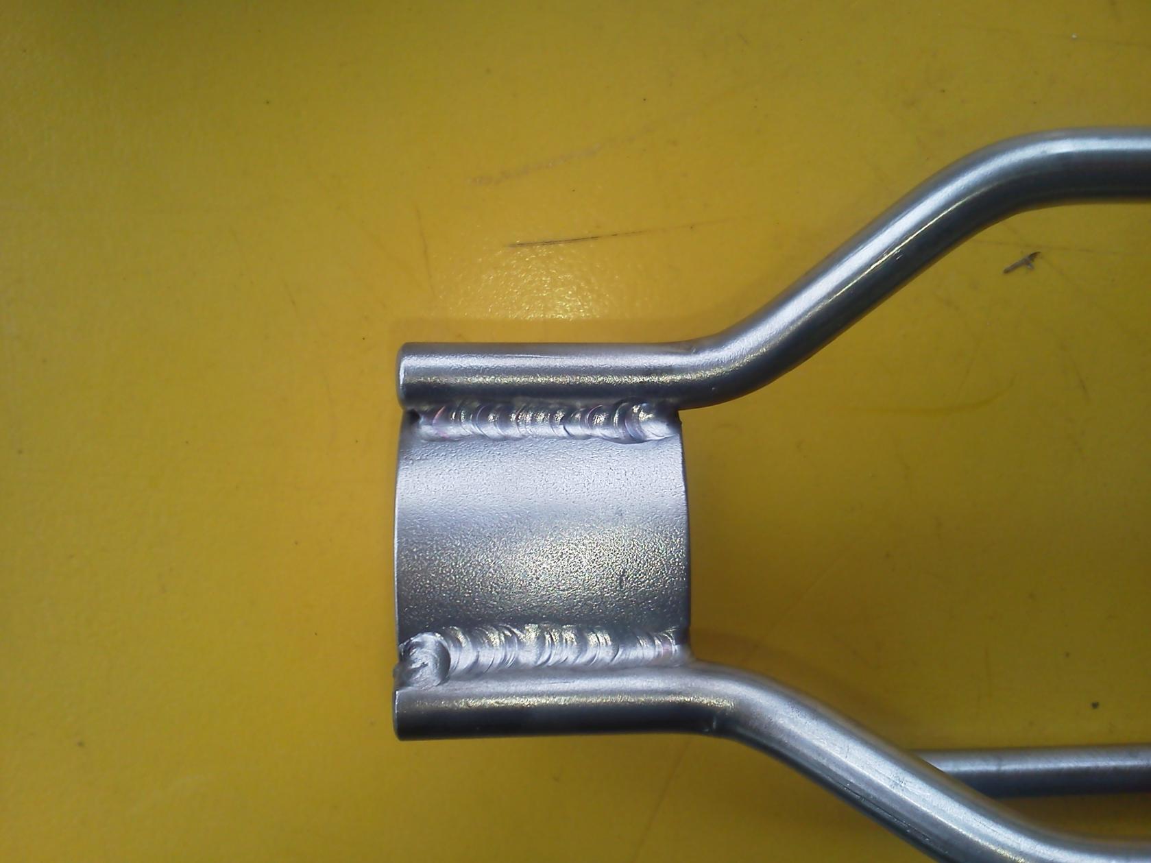

    Here is the progress from this weekend
    I used the #4 copper wire b/c it was easy to clamp and with the aluminum I have I could not get it to clamp right.
    Welded
    Ended up being tighter than I wanted so I had to turn the inside tube down. I took it down ~.018"
ID:	5439Click image for larger version.
    The outer tube did warp slightly so the fit is a little loose, but it will work.

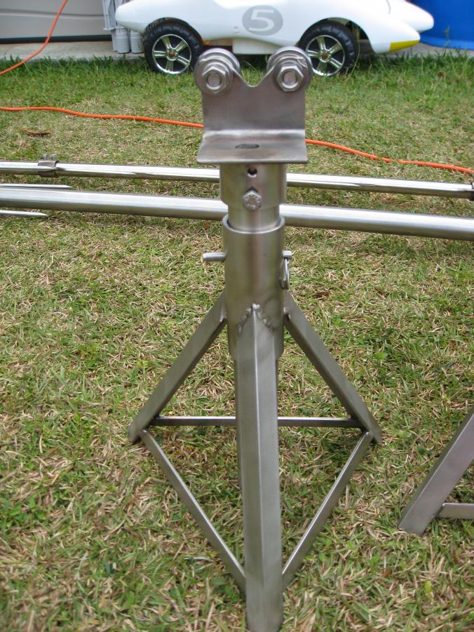

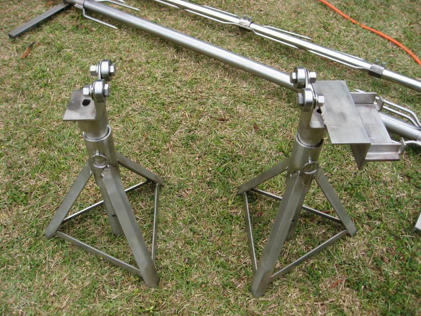

    I finished the stands this past weekend and I think that they will work. My only concern is the width of the base, next time I will make it bigger and use larger tubing.
    Nice project you've got there. I especially like the prongs. Making my mouth water ....
    I learned a lot from this thread - including pickling metal. Always nice to see a project unfold and learn something. Cheers!
    Thanks Undercut. I have not had a chance to do the pickling step yet and some sopts need it. I hope its not to late.
