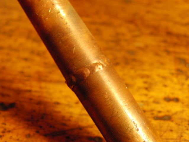

    I actually tried the same thing. Ill post a picture if I can find the piece of pipe. What's amazing is how much amperage it takes to form a puddle. for the 1/2 inch pipe, I used somewhere around 60 to 80 amps.

    Here are some pictures of my attempt at welding a piece of 1/2 inch copper pipe. Its kind of weird because the puddle is kind of gummy. it doesn't flow very well along with the fact that its so darn conductive. I need to try it with a sheet of copper because I had more trouble with the fact its round than the fact that its copper.

    It came out pretty good.
    Did you TIG that? What gas did you use, machine settings, etc?
    Next time I need to work on the plumbing in my house, maybe I'll just TIG the pipes back together instead of using that nasty solder.
    I did that a couple of months ago. I used my gms 400 on lift tig. I don't have a pedal for it either.
    I had a cheap not so flexible wp 9 torch with a 1/16 ceriated tungsten sharp.
    I used pure argon at 15 CFH with a #5 cup.
    I was around 60 to 80 amps. I don't remember exactly though. I just know it takes A LOT of heat to get it to work. I couldn't imagine trying to tig even 1/8'' copper yet alone anything thicker.

    >> "I couldn't imagine trying to tig even 1/8'' copper yet alone anything thicker."
    What size was that pipe you just showed pics of?
    Should be either .028(type M) or .040(type L) wall thickness.
