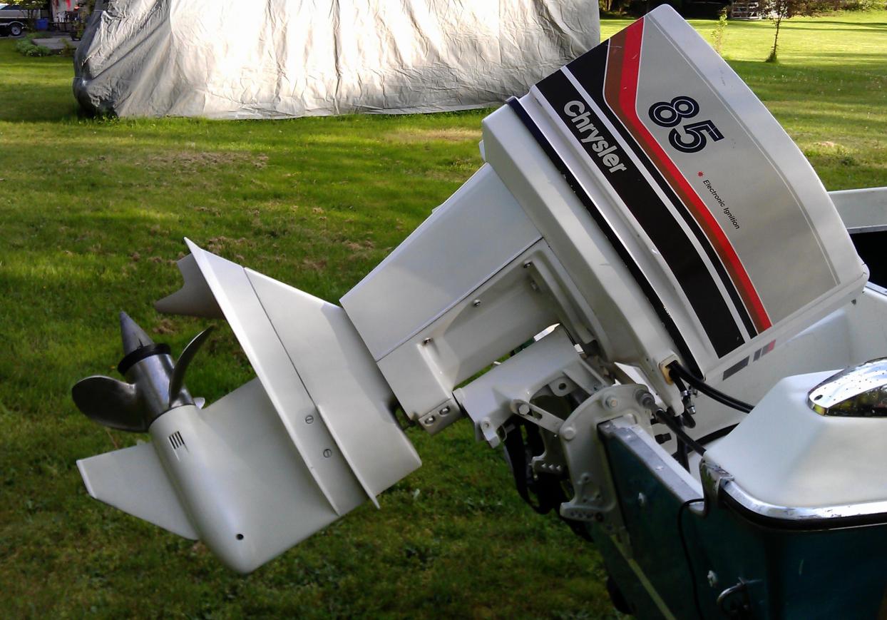

    The customer e-mailed me some pictures of the finished result. He seemed pretty proud, and I would say for good reason! Looks like he did a very good job getting it all back together.
    Here is the weld-repaired lower unit after paint:
    Attachment 6732
    And here is the rebuilt, completely assembled outboard motor (a 1979 Chrysler) that the lower unit got installed into:
    Attachment 6731

    Oh yeah. Very nice. Can't tell anything was done. Looks stock!
    Thanks, yeah I think he did a really good job of blending the texture at the end there and making it look as if it were never repaired in the first place.

    i looked at your skeg repair when you posted it the first time; those welds are way to cold. just because you filled a gap, ground it down, got it painted and it looks nice, does not mean it's strong. the skeg repair would only play to a friendly audience, like the one on this board.
    that said, your presentation of procedures used during the process of the repair is impressive.
    Usually when someone says a weld "looks cold", I believe they are referring to the arc temperature used to perform the weld as being too cold (such as by not being set with adequate amps.) In the case of this skeg repair, with the max my machine can put out (nearly 200 amps), 80% EN AC Balance, and using a helium mix (and a pretty much instant puddle as soon as the arc was lit, even with cool-to-the touch workpiece), I assure you that the arc temperature was not "too cold."
    So, I think you might be actually talking about the workpiece being too cold, such as by not allowing enough heat to soak into it, or not pre-heating it enough. As I discussed pretty extensively in my original posts, that was my goal, in order to prevent the customer from having to replace the nearby seal, and possibly also from needing to completely disassemble and rebuild the entire lower unit.
    Sometimes, even when a weld isn't as good as it *possibly* can be, it can still be "good enough." As long as I this skeg isn't abused, I do believe it will hold just fine. I know that I penetrated it fully (by puddling *before* adding filler rod), and I also know that I selected a filler rod alloy that would give a pretty high welded strength (and ductility) in the weld deposit. Finally, I ground the contour to eliminate any stress risers. That's about as good as can be done, under the constraints of this particular job, at least to my knowledge. But if you are aware of a technique that I could have used to do it better, please fill me in on it.
