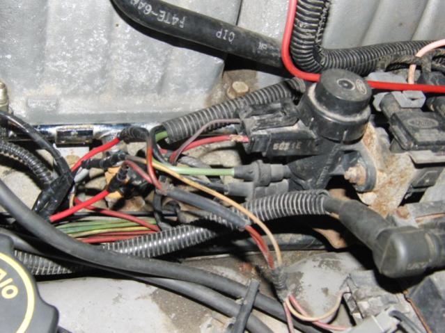

    I fixed a few more problems. I re spliced some wires that ran to the ignition box that the last owner fixed. He used the cheap plastic crimps. They will get and corrode in time and cause problems. I soldered them together, but didn't have any shrink tubing so I had to use some good electrical tape.
    The one problem that I'm currently chasing is that the overdrive light flashed on and off when I start it up. I'm not getting any codes from the PCM. It quits blinking after 5 or 10 minutes. Once I get it legal and insured, I'm going to take it to the community college I went to and borrow a better scanner and see what I can find.
    More updates are to come.
    After looking at the pic I posted, I realized that I forgot to tape a red wire that is bare.
