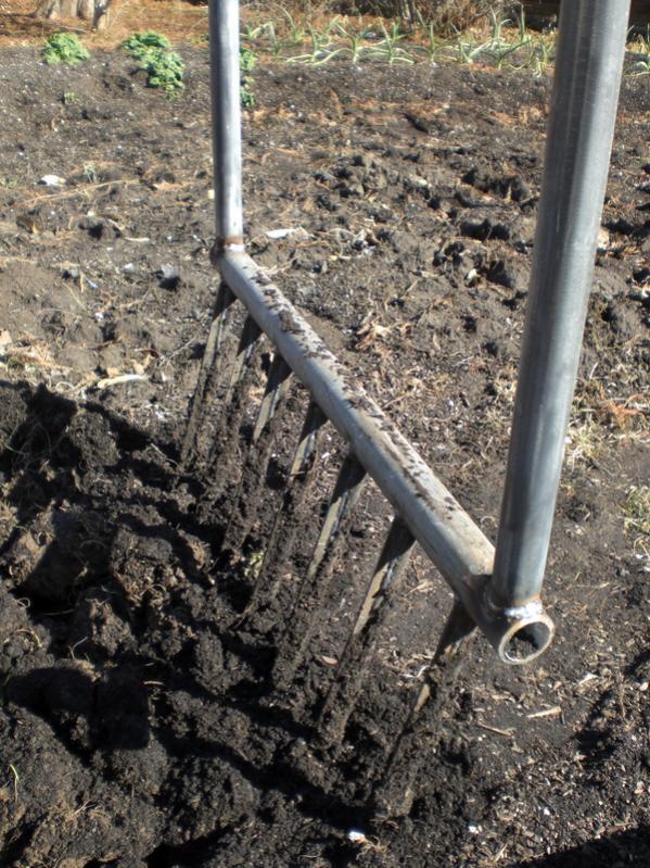

    This is an antique farming tool that I decided to recreate from some plans I found in an old gardening book and on the web. Before the days of Petroleum powered farm equipment those without horse power used man power to work as much as two acres with this tool. (I would not want to be that man!) I figure it should make quick work of my 1000 square foot garden. This tool loosens and aerates the soil without destroying soil structure(like a tiller) and inverting the strata (making your top soil bottom soil) like a shovel would. I had some help from the kids.

    That is a nice tool. You use you weight to till the soil very clever. How long to do the whole 1000 sq ft garden?

    Thanks Cippee, well so far I have only been able to do a test patch, things are still very wet. I have another month before I can start planting Potatoes and Onions so I will let you know. So far it seems to go a-lot faster then a shovel and I love the fact that it is Symmetrical, Meaning that I am not bending to one side or the other to use it.

    Here are the plans I found on the net. I only went at a 20 Degree angle 30 just seemed to steep and would have you leaning too far forward in order to try and get the tines to go straight down while holding the handles. I am still debating weather or not to put the "elbows" on it. I will know more when I get to really try it out in the the spring. I am up to 26 pounds already and I think I will skip it if the tool works well without them. as for the bracing from the cross pipe to the handles, it seems stout enough without them.
    I used some 1/8" x 1/2" 12" inch strap to help keep the 1/2" x 18" cold rolled from bending.
    I used some salvaged galvanized water pipe to make the whole thing. I won't do that again. wire wheel and grinder but still got lots of white smoke from the galvy inside the pipe.
