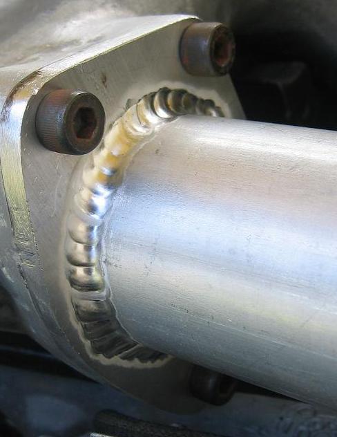

    Here are the settings that I like to use lately. Seems to really "wet in" the toes of the weld bead nicely. And of course, leaves a beautifully shiny weld bead as well.
    Super200p (non-adjustable 60Hz AC frequency): 25% He gas mix, 20% EP AC Balance (the minimum allowed on the machine), no pulse, 1/16" 2% lanthanated tungsten, about 12-15 cfh total gas flow with a #6 gas lens.

    srp - got any pictures of your work with those settings?

    Yes, IMO, the shielding gas selection makes a pretty significant difference.
    Those welds look excellent in consistency and heat control. You might notice however, compared to mine, (and that is also 1/16" 6061 aluminum tubing welded to 6061 1/4" plate with 4043 filler rod) that the toes are not quite wetted in to the same extent. It's also hard to tell from the photo, but also potentially a small amount of "graininess" in areas of your weld bead will go away with the Helium mix.
    I'm interested if you do try the Helium mix, to hear what you think.
    (PS - Keep in mind my Super200P doesn't allow 10%EP AC Balance... or else I might be using it.)
    Also, I might have to play around with trying 300Hz pulsing (that's the highest pulsing frequency my machine can do) with the Helium mix... I haven't experimented with much pulsing in conjunction with the Helium mix yet.

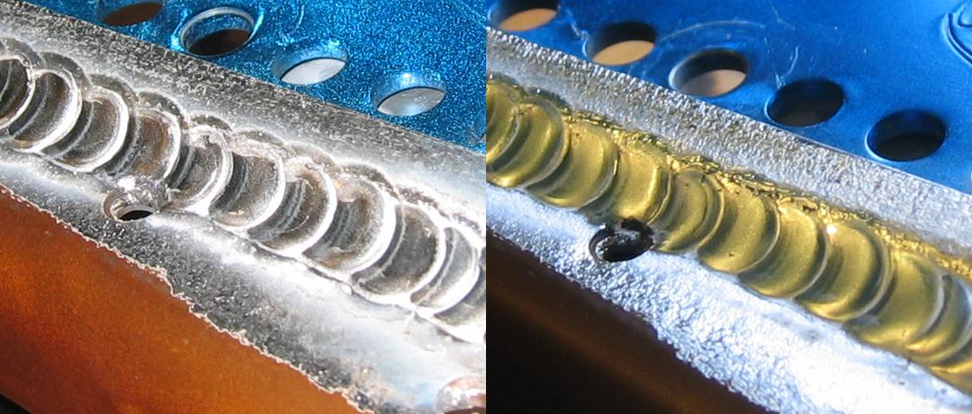

    Thanks much for sharing your experienced setup, and for the words of encouragement. Here is another weld bead I just laid the other day with my aforementioned settings. (same weld bead shown, with and without camera flash) This is about 1/8-3/16" thick material, hard anodized surface removed by customer prior to me welding. It seems like these droplets are shaped kind of like a row of little discs sitting on the surface, (rather than more hemispherically shaped mounds), which I think looks pretty cool.

    On this one, I tried pulsing with my foot pedal just a bit with each drop. I felt like it helped me control the bead width and the pace of droplet adds a little better (sometimes I felt like I needed to slow down and let my feeding hand catch up.) Of course, timing and manipulation of the torch and filler affect the result as well. Sorry I can't share more details of this project, such as overall project pics.
