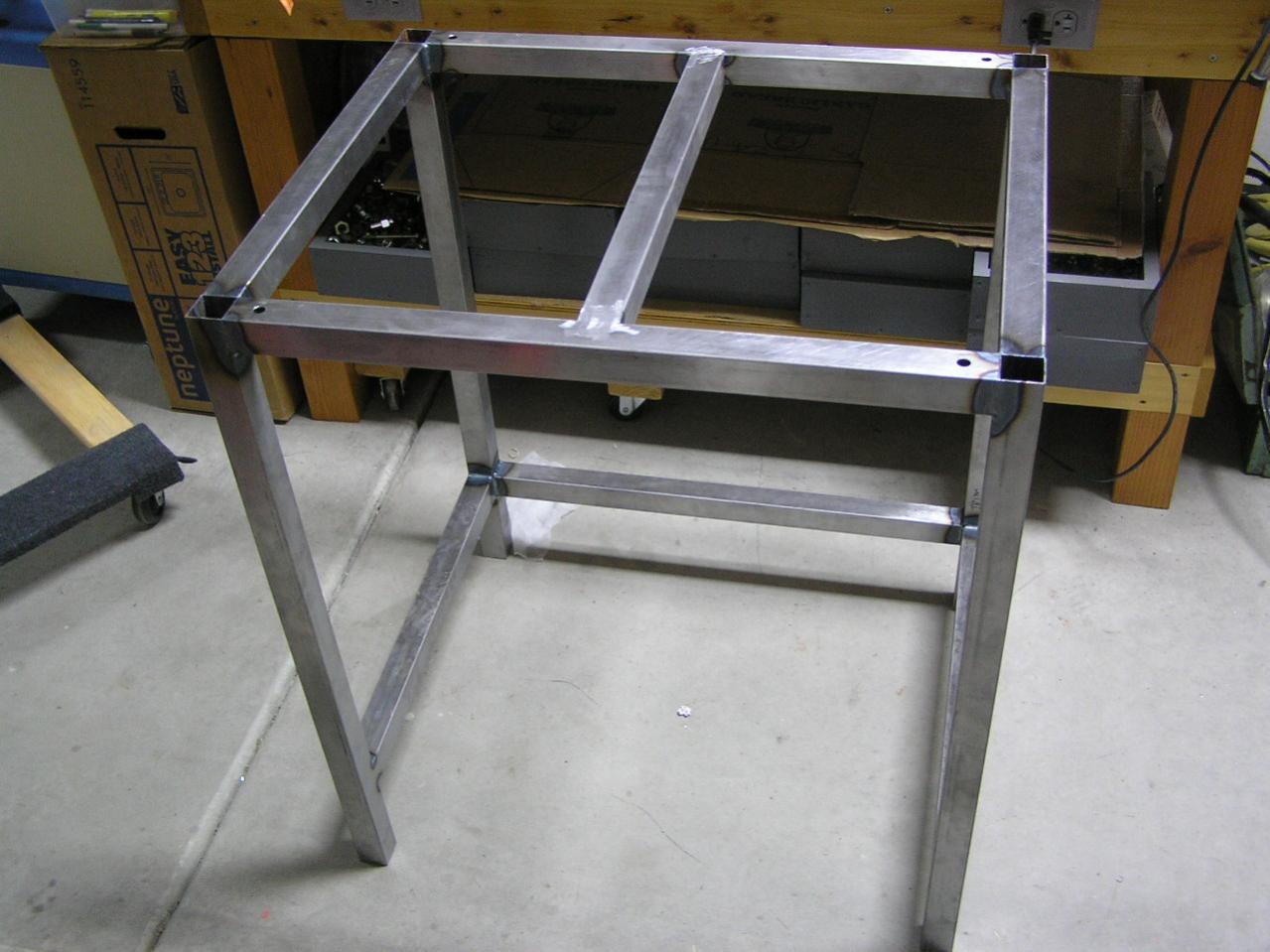

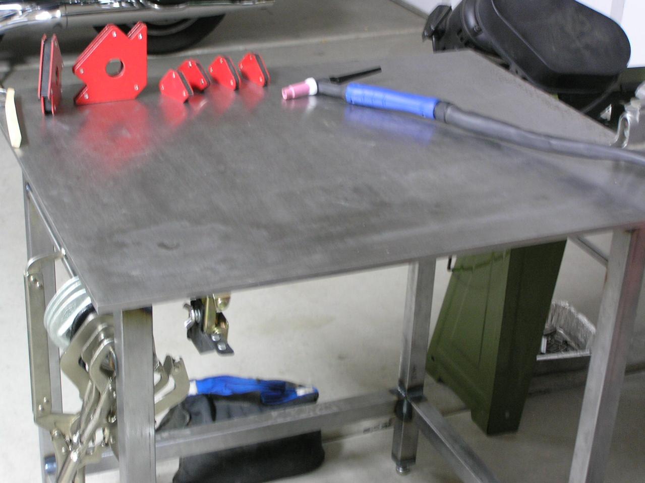

    Here's mine. Didn't need anything too big - light frame with 28 x 34, 3/8" top.

    Those magnets can mess with the tig arc. Put a piece of metal on top on the magnet and try to weld near it.

    Yeah, I use them to position pieces on the table, but not near the welds. I have enough problems getting the arc to go where I want as it is.
