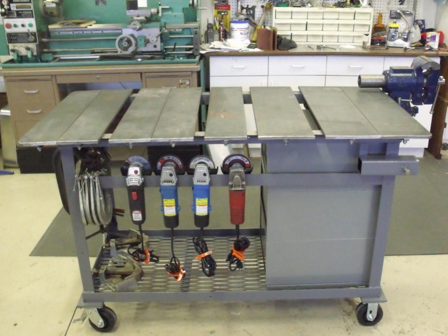

    The table I made after looking at many versions on line has many of the features that have been mentioned here.
    The slats are removable and can be adjusted to fit odd shape items you may need to weld. They also make it simple to clamp anywhere on the table.
    The fourth picture is of an insert that I use for plasma cutting. I have since added a hopper underneath to catch the sparks and slag, both are easily removable.

    Wow Ram, that is a kickass setup.
    I like the vise off to the side. Do you have other places around the shop that it can "plug" into? (looks like it is a 2" hitch receiver type mount)
    Is the vise pretty rigid when mounted like that?
    That is nice work!
    Do the slats slide back and forth on the table top? They look like 1/2" or thicker plate?

    The slats are 1/2 inch x 6 and 1/2 x 8 inch hot rolled
    They do slide to configure as needed and are easily removable.
    here are a couple of pictures of the clamp system I devised. And the setup for the vice, I cut the base out to match the vice mount with my plasma cutter.

    Very nice setup, practical and versatile, I like the vise, have one of those myself, the dropin inserts is winner, good idea. I'm sure your build will inspire others to do something similar.
