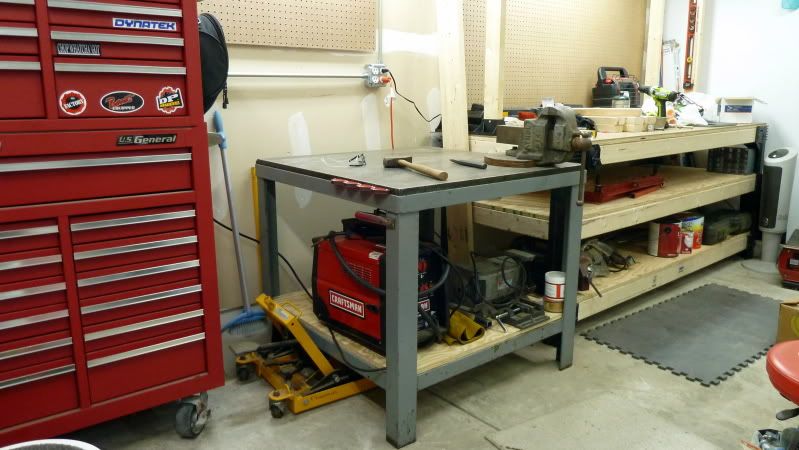

    My "welding table" doubles as a general metalworking bench and an anvil. It's 30" tall, 36" square, with a 2.5" thick top. Plate alone weighs over 900lbs.

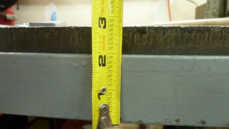

    topgear, Is the plate recessed? Its hard to tell from the pic but it doesn't look like 2.5 it looks more around 1 inch. Looking at the 2x4's on the bench behind it, the top seems like its thinner.
    and geez Do you own a forklift or what, how do you move it there's no way I could move that thing around by hand. Any how nice table.

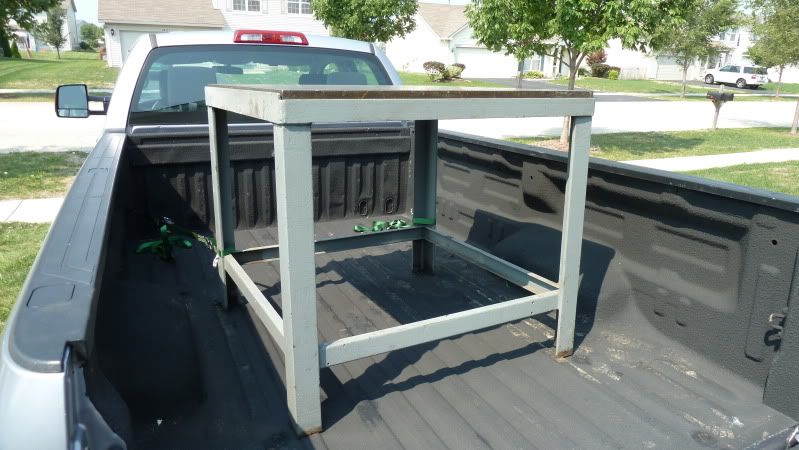

    Portable, no. It was put into my truck with a fork lift. I took it out of my truck and into my garage with a 1.5 Ton engine hoist. There it sits. Only paid $200 for it and a really good old Athol vise!
    Yes, the plate is recessed. The frame is 1/4" thick angle stock. When I set it down with the engine hoist, it was about 2" away from the wall. I was able to slide it that last 2", but I weigh about 290 and it was all I had in me.
