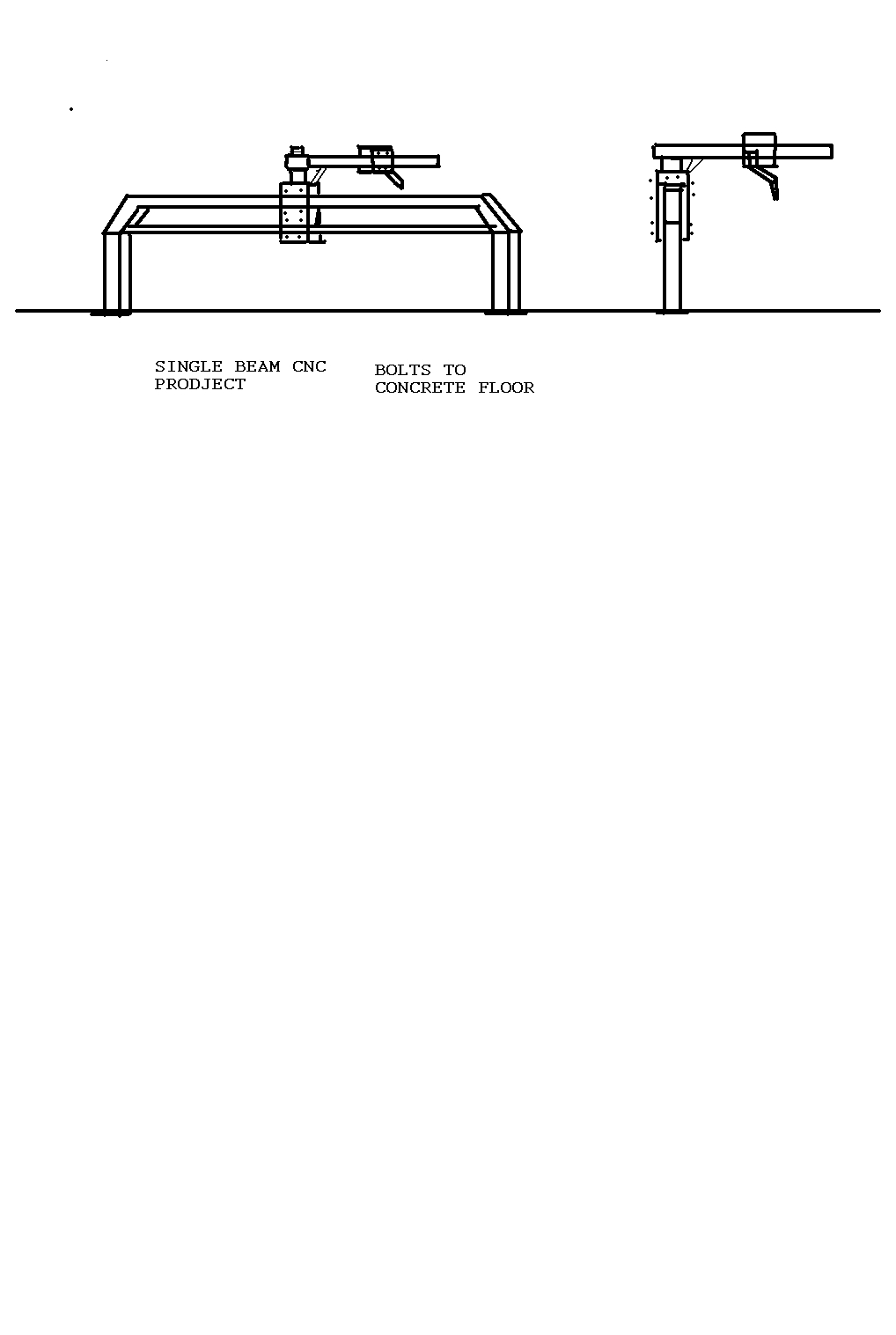

    Was sitting and was thinking a simple cheaper way to make a cnc set with half the materials. Why not just a single beam rail system that how some of the big cnc machine builder make them Click image for larger version.
    How about this one!
