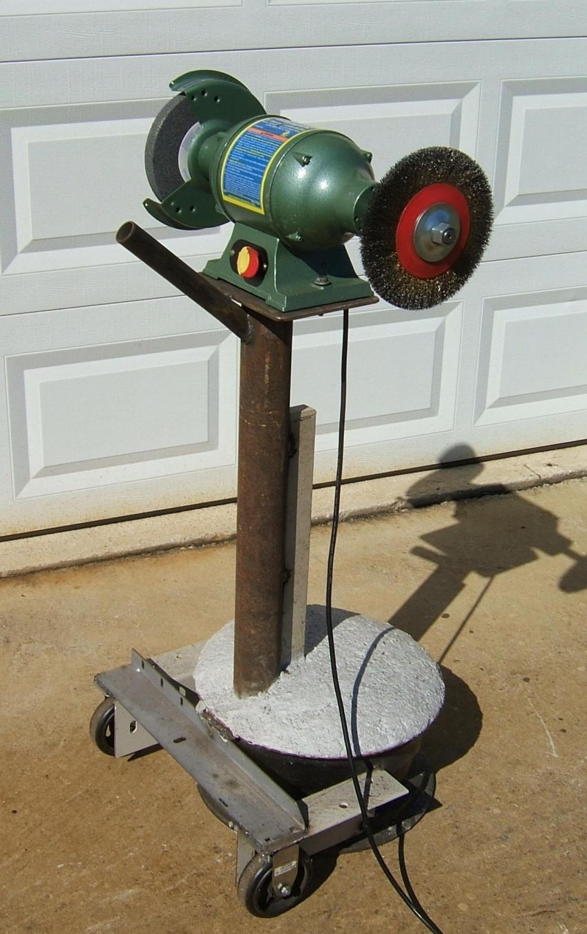

    HI Spike
    I found filling the wheel with coment helps to keep it stable.
Name:	grinder pedestal.jpg

    HI Spike
    That certainly looks stable and sturdy. I like the integrated hand cart idea, too.
