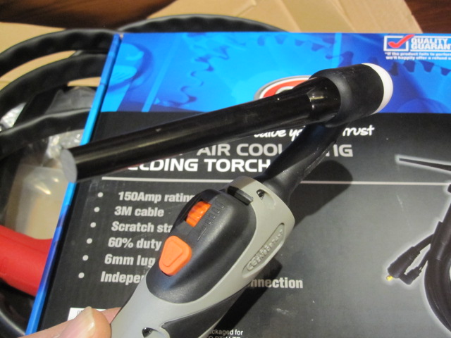

    Hello all, I have Tig 250 EX and I got smaller torch WP 20F for it, it's smaller and nice. However I'm looking to replace finger switch to finger amp control switch probably north/south style switch. 250 EX uses 7 pin for switch for foot pedal came with it but I'm not foot pedal guy since my knee heats with injury before.
    Does anyone swap control and what do you guys recommend?

    The control must be a 47-50k pot. I don't think they have those. I have had other customers that have sought a solution with them, but they didn't have that at the time.
    We do have a torch with finger amp control switch (rotary) coming out soon. Somewhere Duncan has posted a picture of it.

    For some reason which is a mystery to myself and Jim at SSC as well... Everlast does indeed use a 47K potineometer as stated below.. Evidently there's something very different inside one the remote amp control board that requires one in that range. I don't know if this is something that could be changed but it should be addressed if possible since it does limit the available options for remote controls. Jim at SSC stated that other manufactures do use different range parts as well but none even close to the range Everlast has settled on. I suppose the right question at this point in the game would be ----------------------> Why is it so different and can it be changed to a different setting that would make using other brand controls work? As the CK advertisement that I watched stated no two welders will use the same location and be comfortable enough to do well with it. That's why they make so many styles. I tried a torch control in years past and couldn't come to terms with it at all and ended up giving it away to someone that took a shine to it laying in my tool box... I've used a foot control in just about every contorted position you can imagine and always find a way to make it work with some part of my body. Pushed it with my foot naturally, elbow, knee, butt, taped it to my foot and pushed over head, squeezed it between the back of my calf and thigh, and even welded while calling out for more or less heat while someone else mashed the pedal which worked the worst of all the ways I have listed above! The torch mounted control was one I couldn't masted but all I've tried was east/west ... North south wasn't available at that time from anyone I knew about anyway. I am open to try that CK deal and will most likely get one in the near future just to see how it works. I'm currently teaching my wife to TIG weld and may see if that's something she adapts to well. She has more fun welding than I do it seems ..

    I have attached a Picture showing the available Amp Control Torch that will be available to Australia and Canada within the next Three Weeks or so.
    The torch is supplied by the same Manufacturer of the Canadian Tig Torches so the Quality is far superior to the Standard US Supplied torches .
    With the 250EX the start amps for AC need to be set at 18 amps or so and then it can ramp down from there to the 5 to 7 amp range.
    We will be carrying both air and water cooled torches and the initial introductory prices will be very atractive for our Customers ( these prices will only be for owners of Everlast equipment ) .
    Testing was initiated back in December and follow up evaluations have been done this week so i am satisfied with the overall results and the ease of use for the controls on this torch.
    In actuall fact i am somewhat surprised with how much i like this new torch . So much so in fact that i will be working towards having accesories supplied for it ( Flex heads to change out on Body etc)

    I have Air cooled and Water Cooled torches arriving in WP18 and WP26 . These torches are compatible with the , PowerPro 256 225Lx 250EX and 250EXT
    The 200DX and PowerPro 205 use a different pot value and i have Air cooled only torches for these 2 units.
    I have no idea what time frame the US has for these torches but hopefully it will not be too long a wait .
    The only picture i have is the one i took showing the torch body in the previous post.
