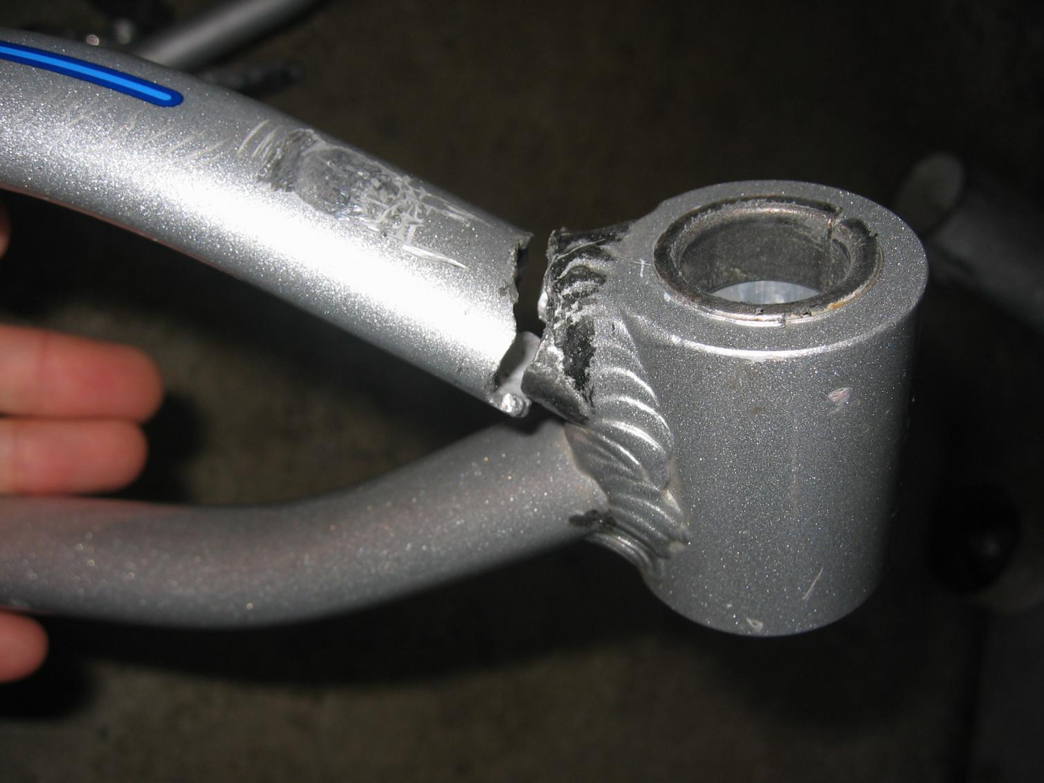

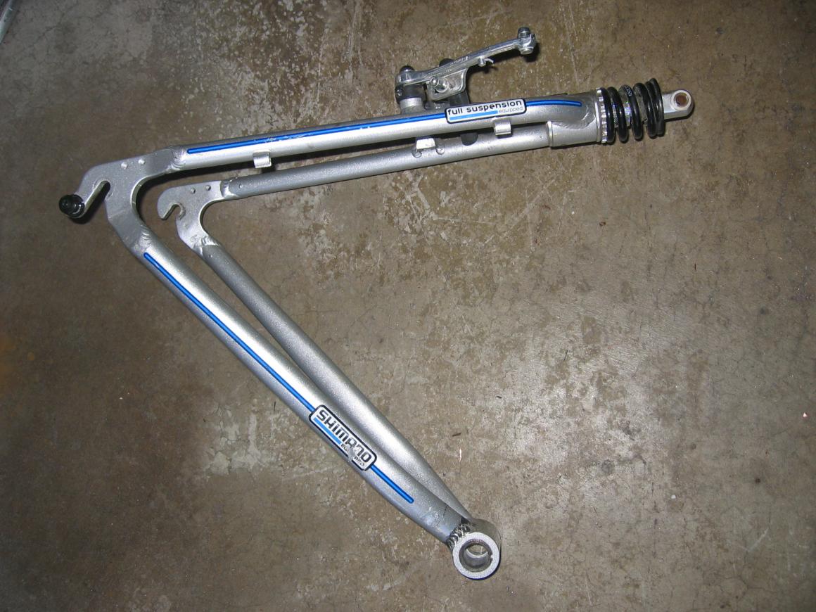

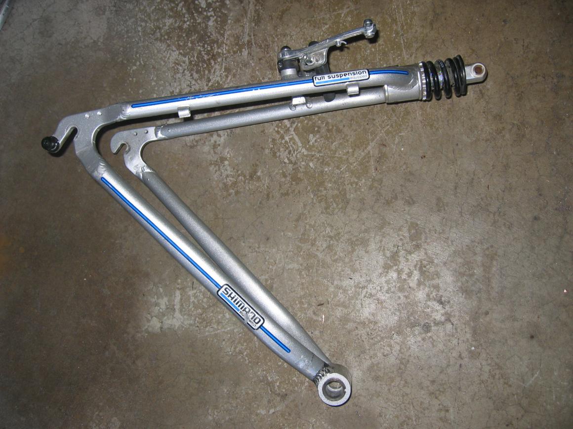

    It's about time I posted another project up, so here is one. This is an aluminum rear suspension of a mountain bike I repaired for a customer.
    It is tubular aluminum, probably about .065" thick, and it cracked where one of two slender tubes met a large, thicker aluminum piece.
    It cracked in the heat affected zone of the original weld. It is likely 6061-T6 (popular heat treated alloy for bicycles... in fact I think it might have even said so on a sticker.)
    My thoughts were, I could repair it to its likely original strength, but am probably not going to do any improvement on that, because the heat affected zone will still exist in the tubing right next to the weld. That said, I would do the best I could, prepping it well, ensuring adequate penetration and thickness where welded, and an even (gradual) transition of thickness from one piece to the welded area to the other piece, focusing on leaving no stress risers.
    -Before welding-

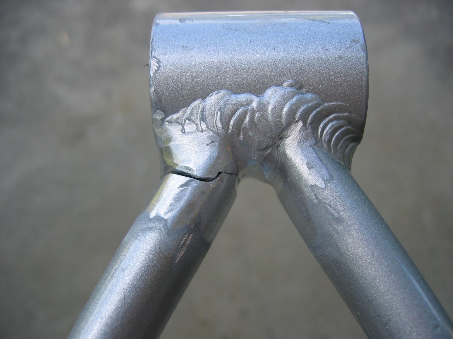

    -Prepped-
    I used a flap disc, evenly and with a very light touch so as to not excessively thin the tubing. Note also that I left an area where the pieces would "key" together to ensure proper alignment, although did generally remove the other likely contaminated, cracked faces aside from that. That gave me the best weld quality, without going to a huge unnecessary hassle of aligning the pieces.

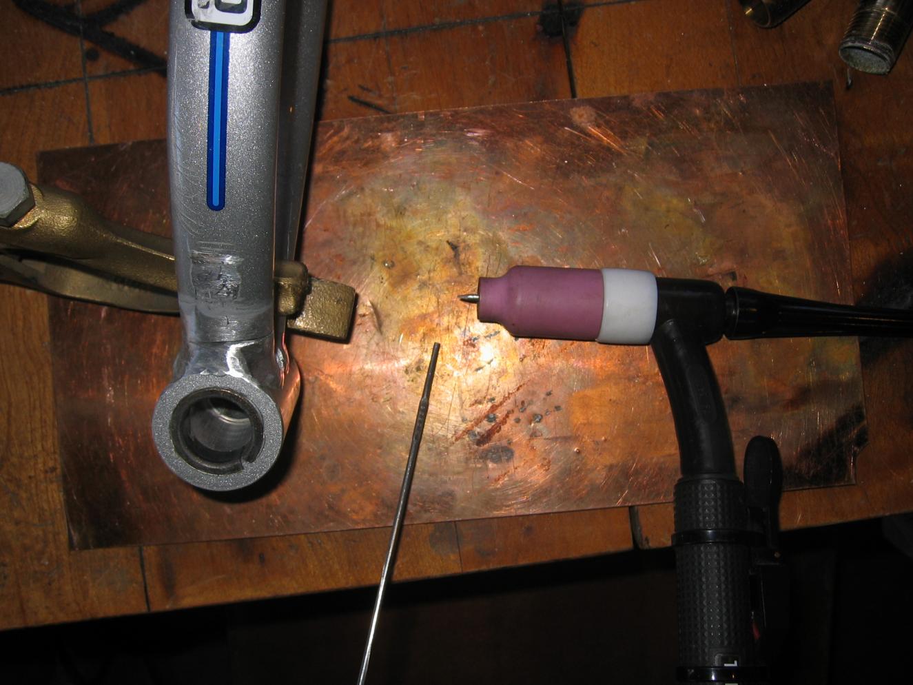

    -Welding setup used-
    Note: 1/16" 5356 filler rod ready to go. Also, sometimes with painted parts, there aren't a lot of places you can ground to, and you do what you can.

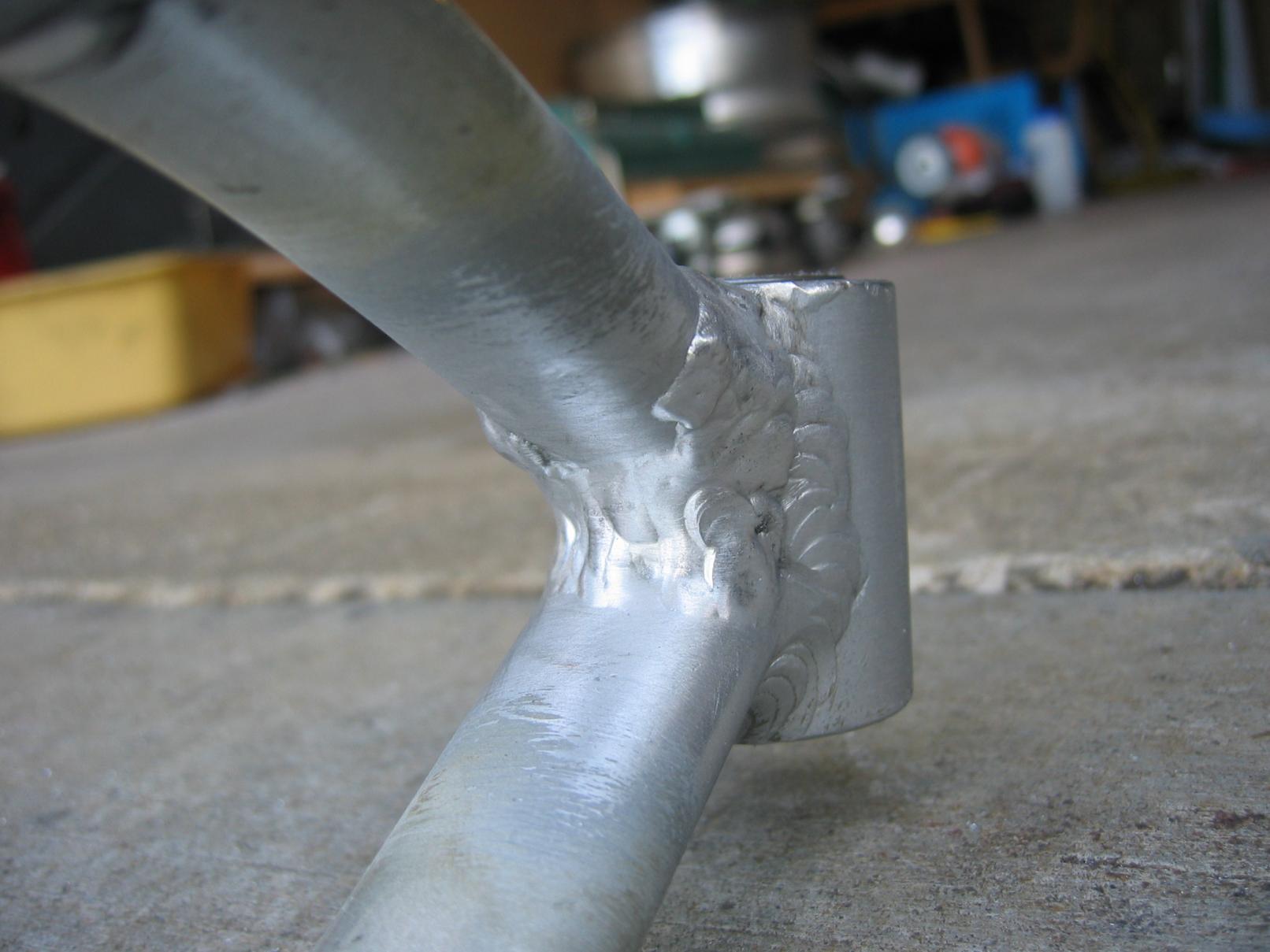

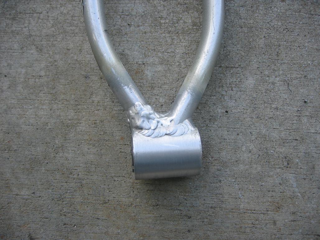

    -After welding-

    The problem with adding a gusset is that:
    1. It may interfere with the tire (this is a big deal for a job I do that someone brings in like this, you have to consider potential interference problems withother parts, etc.), and
    2. It does not prevent the reduction of tensile strength in the material that is in the heat affected zone. So at the end of the day, I am not convinced it would add *any* strength. It would make the structure a bit more rigid.
    I guess I did add a bit of gusseting however (a very small amount) by building up the weld fillets thicker than they were originally - on both the inside of the "vee" (which I was pretty certain would not interfere with any tire or other component) as well as on the outside.
    FWIW, I don't believe bicycles like this are *typically* re-heat treated after being welded. Heat treating after welding I believe, although it is technically feasible and possible for it is be done, happens much less frequently than you'd think on things that are mass produced, to keep costs down, like this part would have been. I totally agree however that it would make it much stronger. It would not surprise me that some bicycles would have it done, but probably only the very most expensive ones. I don't think the heat treating process is very fast, or inexpensive. The proper filler rod would need to be used when welding (for example, there is a specific filler rod to use for welding 6061 aluminum that will be heat treated after welding.)
    Personally, I love an aluminum bicycle. Ever since my first ride on a Cannondale. They can be built very rigidly, and very light. It is a great material for many applications needing high strength to weight ratio. Personally, I would love to have a lightweight Lotus elise, with an aluminum-bonded body to drive around. (And FWIW, it's about the lightest currently produced production cars around.)
    The welds would certainly still have low strength if a gusset were used, but the welds would be in an area that had less bending moment, and therefore less stress.
    Aluminum weld design can be tricky. Sometimes you will see an aluminum tube that has a short length of telescoping tube just at the end for approximately 1.5 inches or so, and then another weld to join the telescoping part. This is done for the same reason (putting the welds that are at nominal tube diameter in an area away from teh high bending stress).
