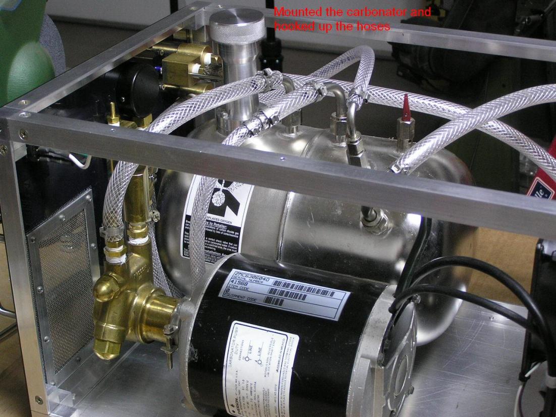

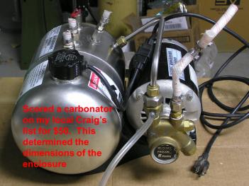

    Just finished my DIY cooler project and since I took a little different route than many I've seen, thought I'd post some pics. This is my first time posting pics, so be gentle (this in fact is a test pic to see if I can figure out how to post).
    -RP
    Looks like the caption on the pic isn't very readable. What it says is that I started with a carbonator I got off the my local CL for $50.
    I basically went the same route you did. I re-used the tank and reset the pressure relief on the pump to 40 PSI. I did take the back-flow preventer off the pump, though. You got a much better deal on the carbonator than I did though, Haha.
    Good luck with it!

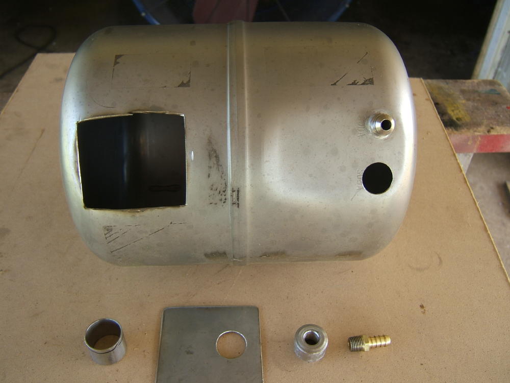

    Her is how I modified my tank for the cooler.
    And I added a fan blade to the other end of the motor.

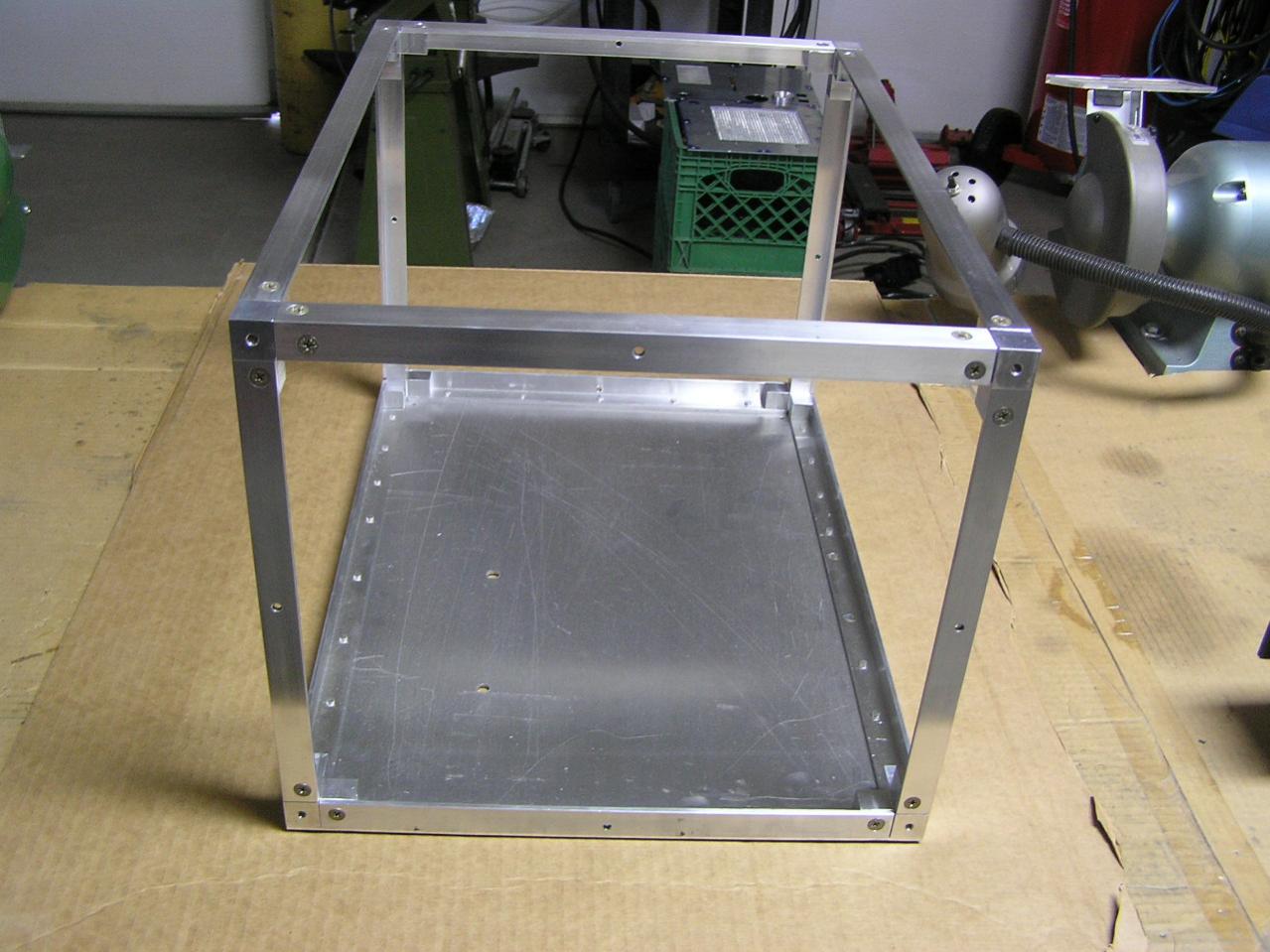

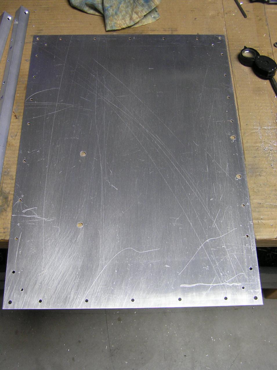

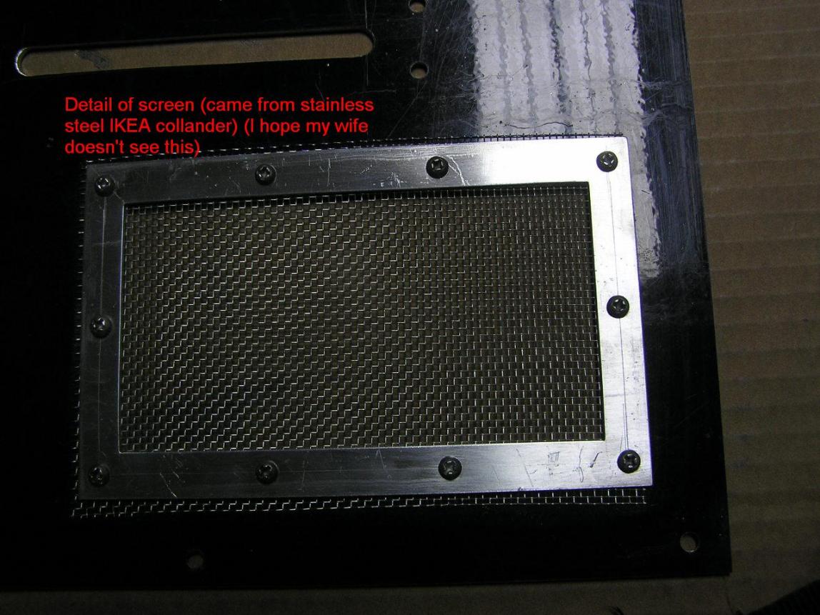

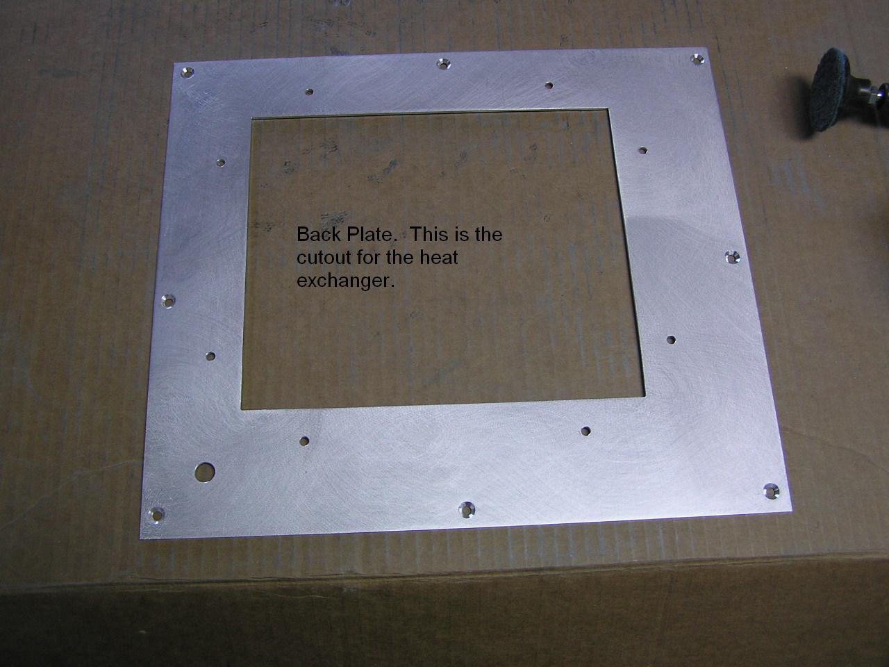

    Finally getting around to actually posting the rest of the pics. First of all the enclosure. As noted, the carbonator dimensions ultimately determined the height and width (12" high by 13.75" wide). I should mention that I don't have a brake and I suck at bending sheet metal with any precision and since I started this before the torch came in, I went with what I know - machined fittings and riveted construction.
    -RP
    Started with some .080 aluminum plate since I've got a big piece in the scrap pile.

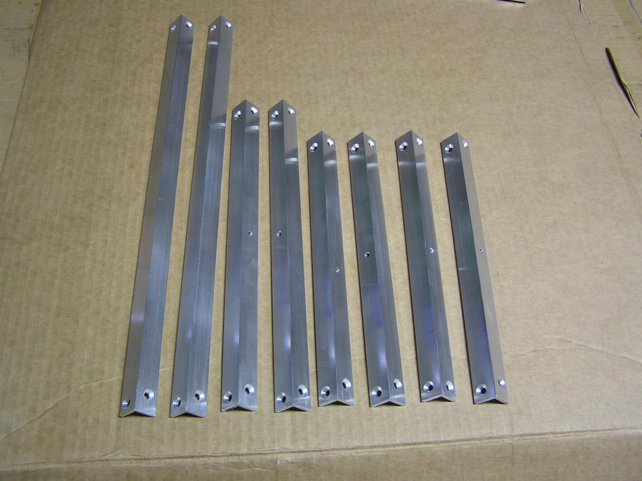

    Cut some 3/4" X 1/8" angle
    Riveted the angle to the bottom plate.

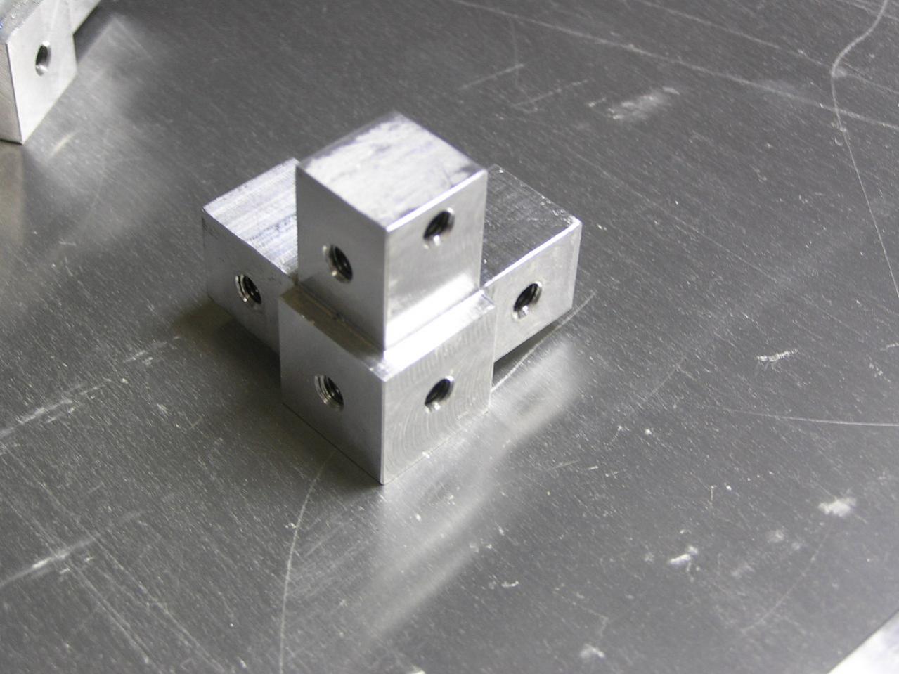

    Machined some corner fittings
    Attached the corner fittings to the bottom plate
    Attached the angle aluminum to the corner fittings
    The corner fittings worked out real well.

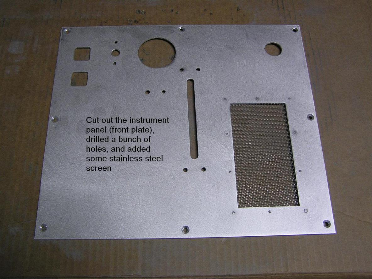

    Next Installment. Finishing the bottom and making the front and back panels. After this I machined the water fittings. I'll post those tomorrow.
    -RP
ID:	4991 Click image for larger version.
ID:	4992 Click image for larger version.
ID:	4993 Click image for larger version.

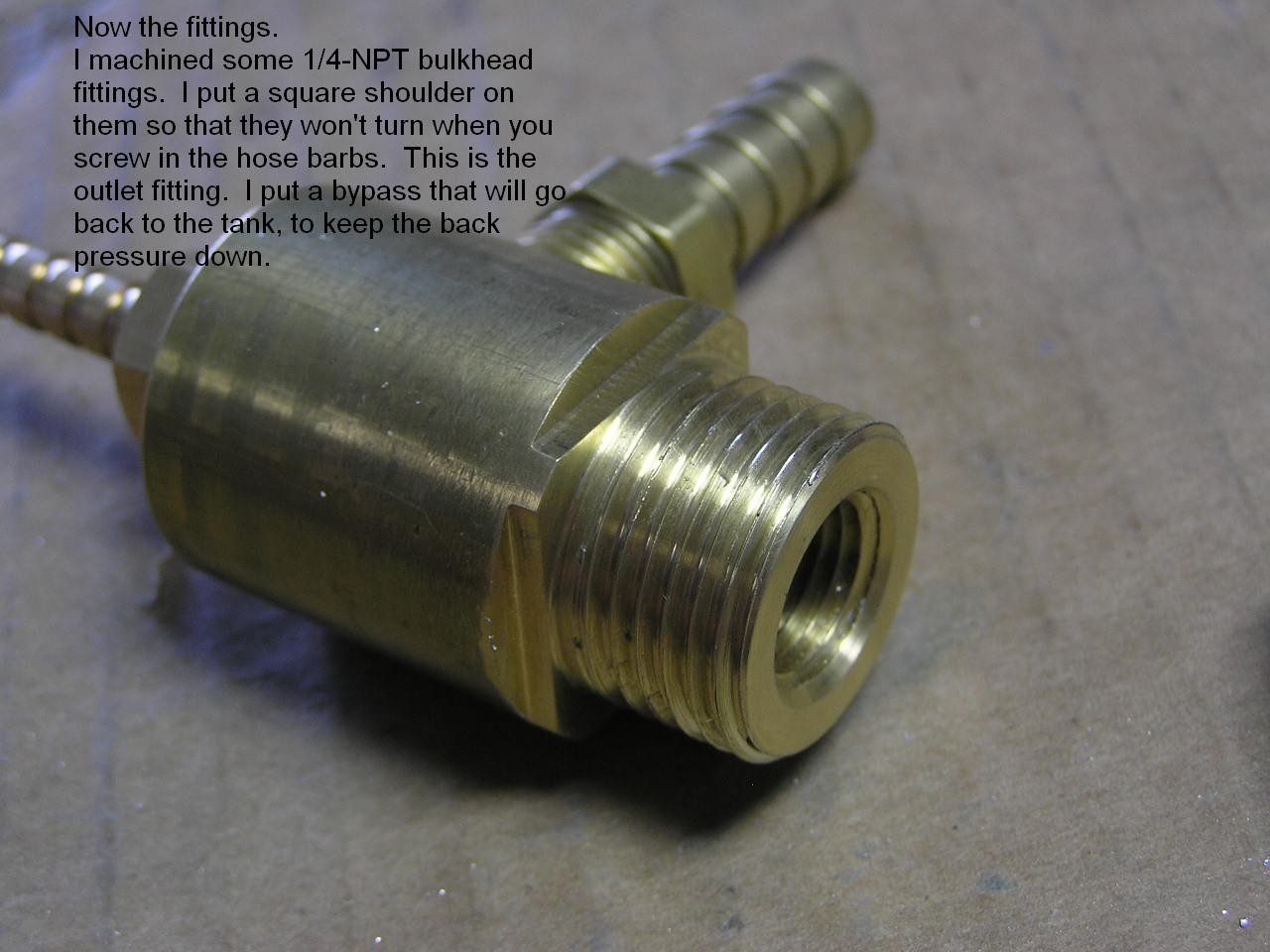

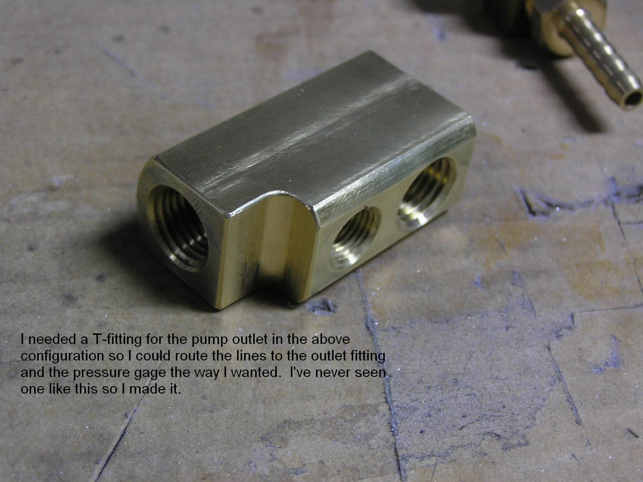

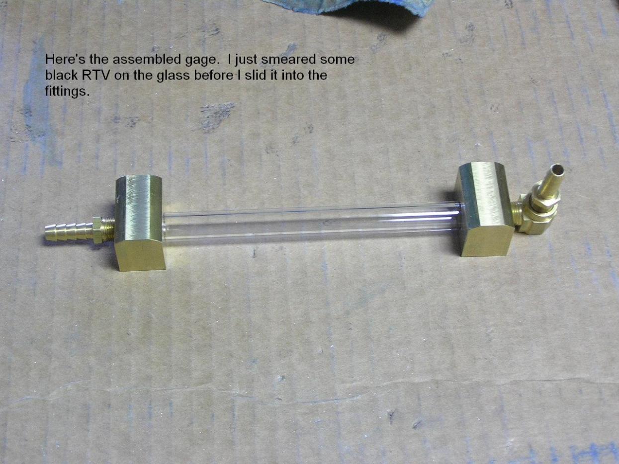

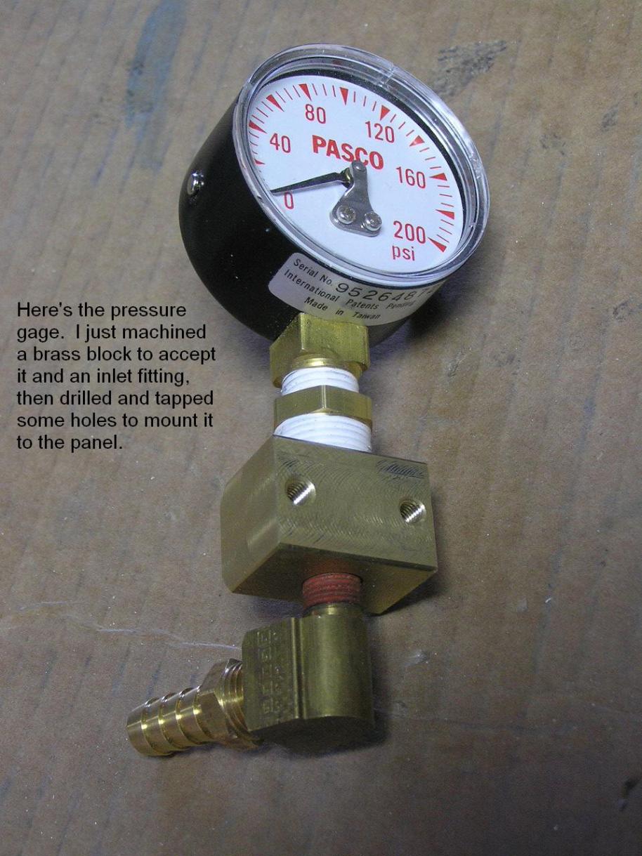

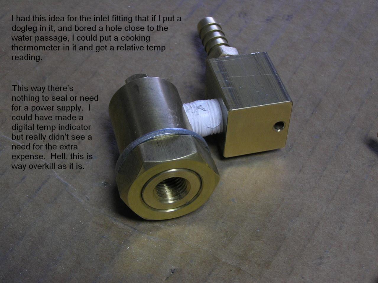

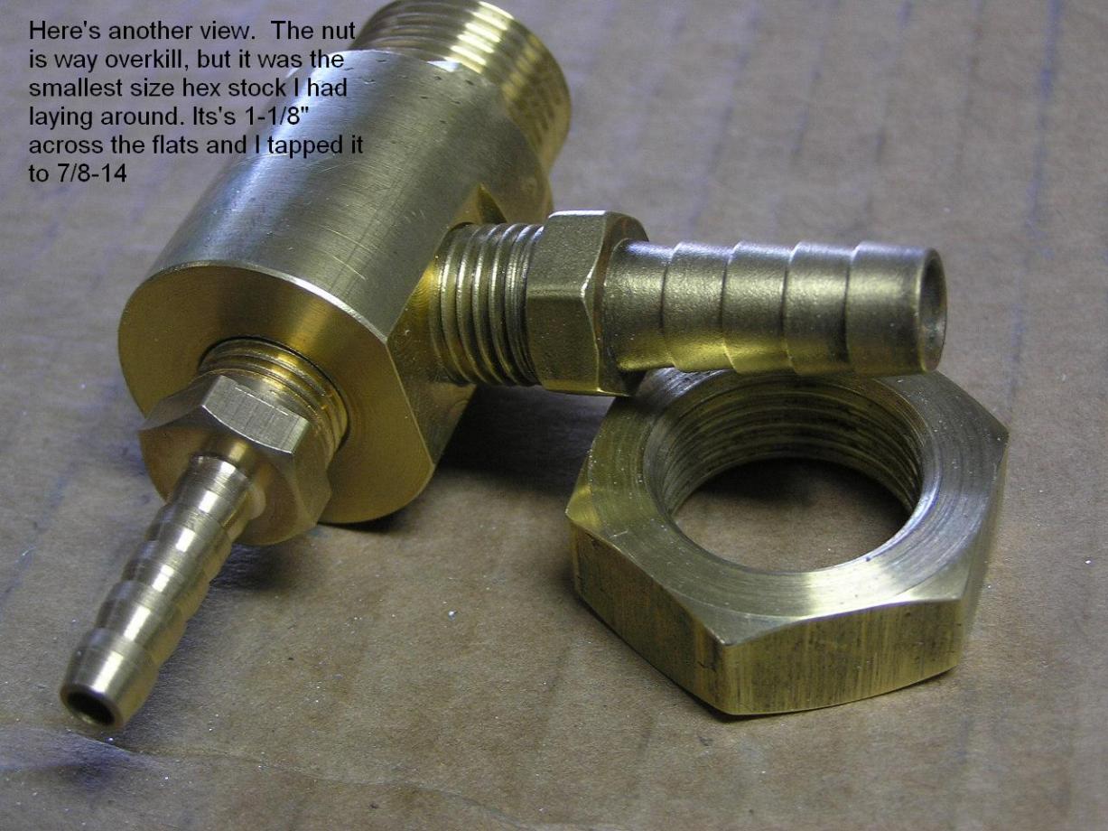

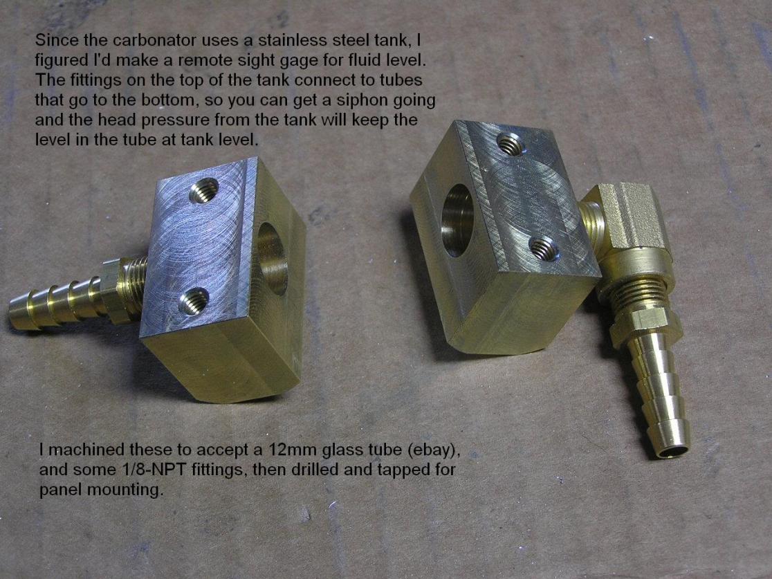

    Next, the fittings. These are the ones I had to make because they either aren't made or I couldn't find what I wanted.
    -RP
ID:	4995 Click image for larger version.
ID:	4996 Click image for larger version.
ID:	4997 Click image for larger version.
ID:	4998 Click image for larger version.

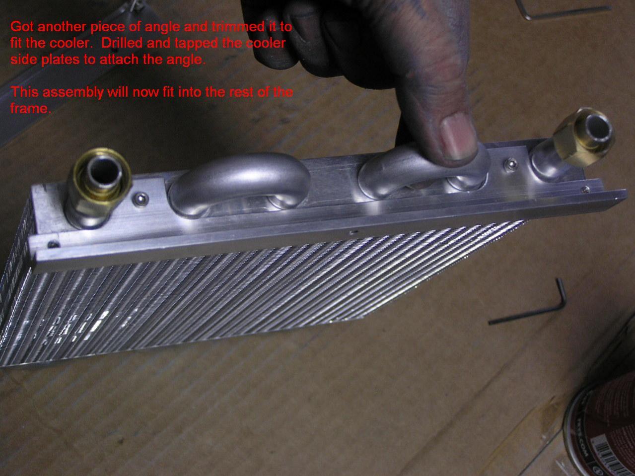

ID:	4999 Click image for larger version.
ID:	5000 Click image for larger version.
ID:	5001 Click image for larger version.

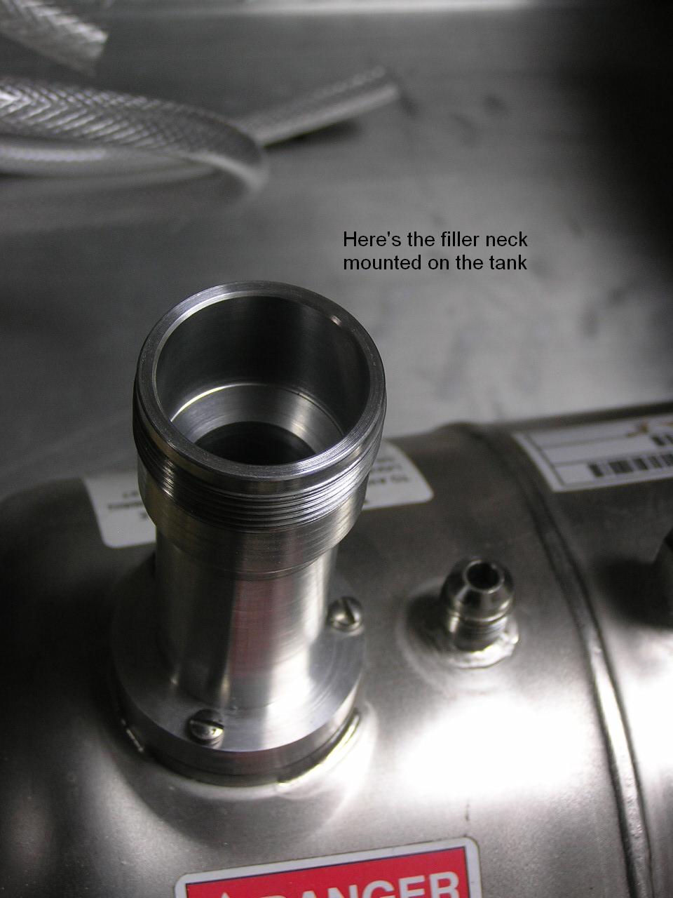

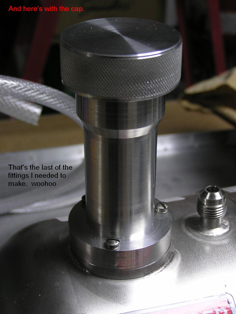

    The last fitting is for the filler neck.
ID:	5005 Click image for larger version.
ID:	5006 Click image for larger version.

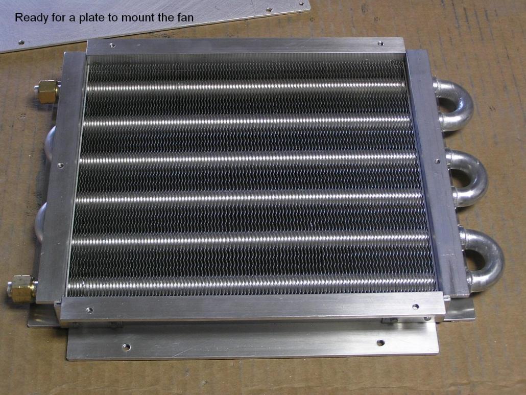

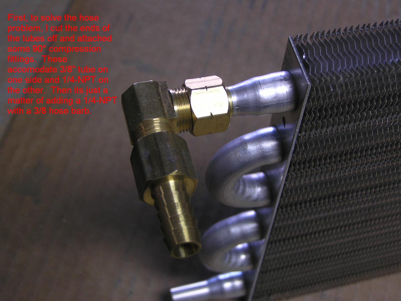

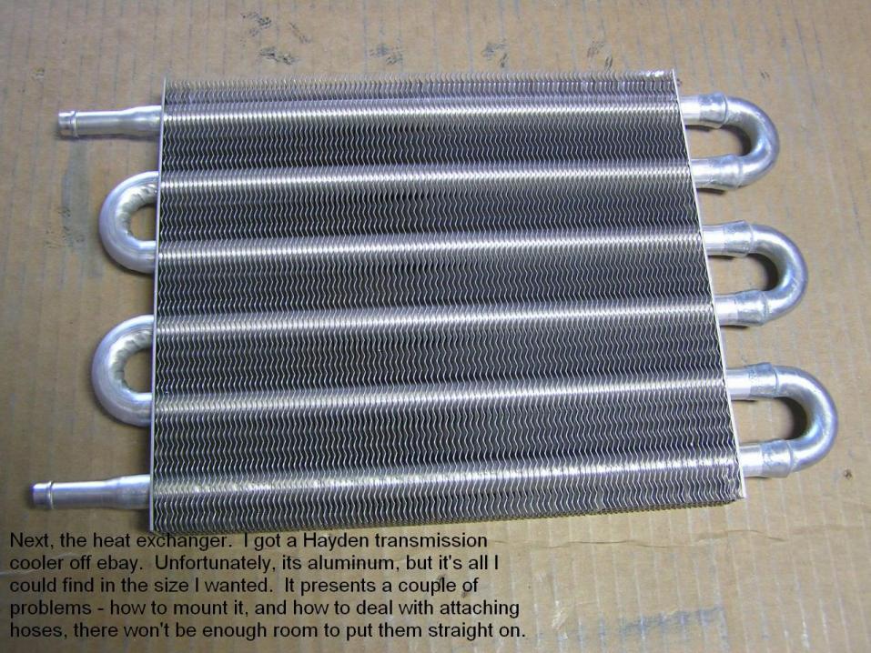

    Next the heat exchanger.
ID:	5008 Click image for larger version.
ID:	5009 Click image for larger version.
ID:	5010 Click image for larger version.
ID:	5011 Click image for larger version.
ID:	5015 Click image for larger version.
ID:	5013 Click image for larger version.
ID:	5014 Click image for larger version.

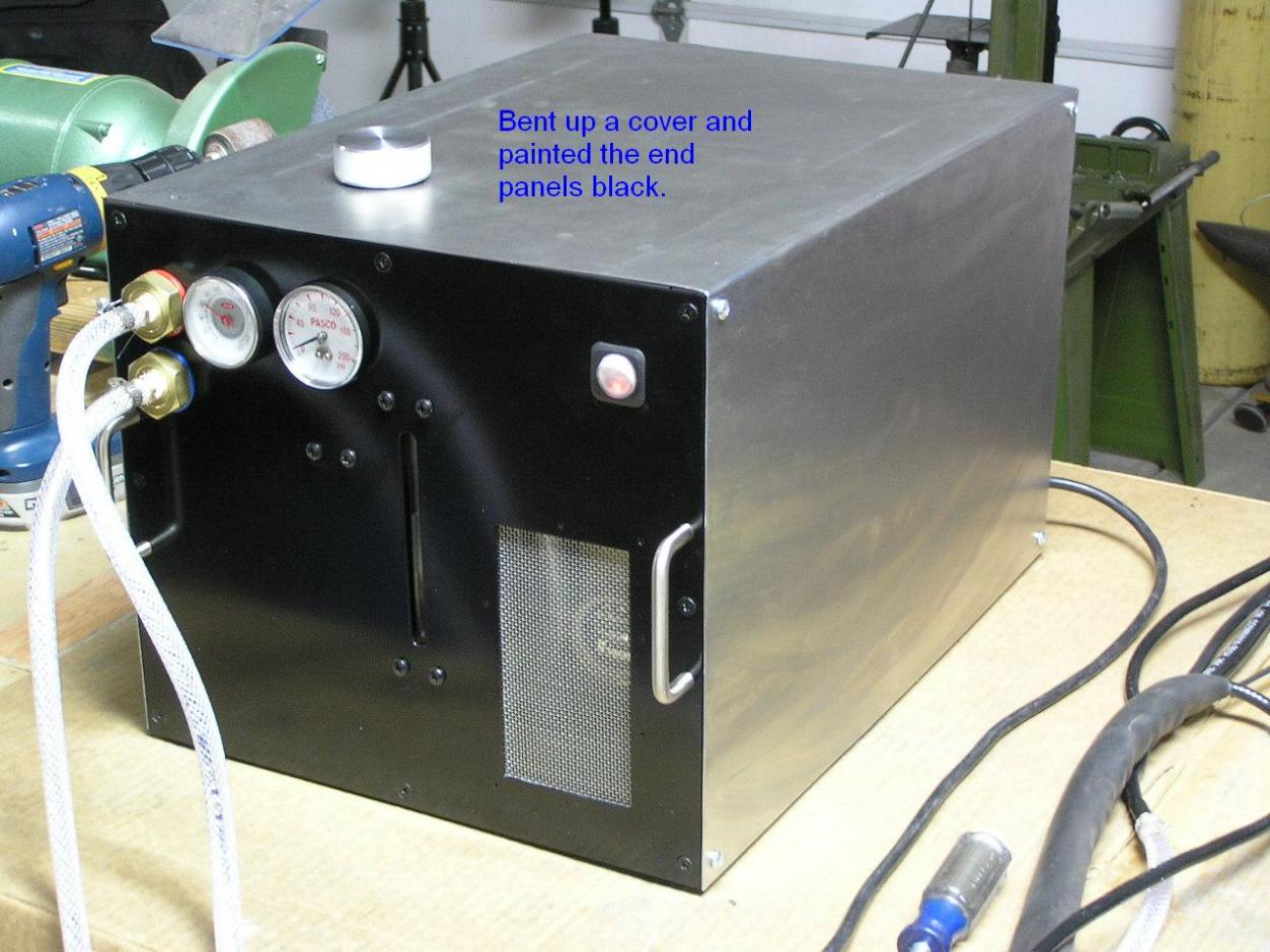

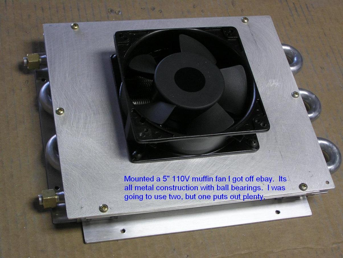

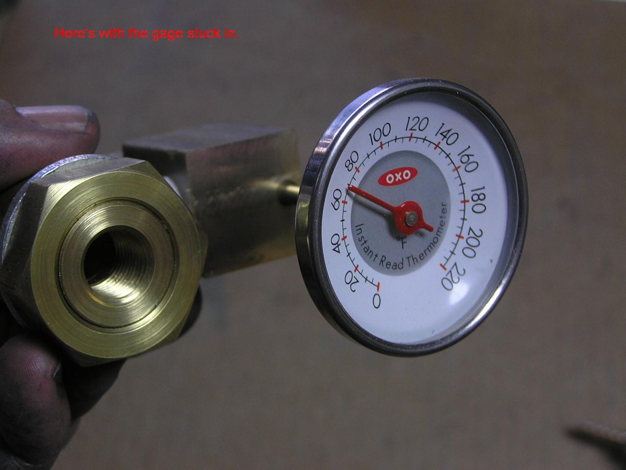

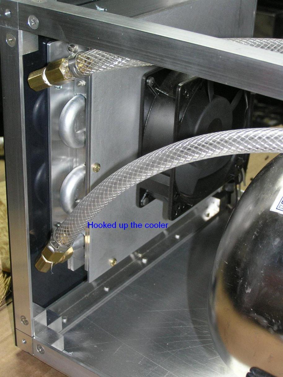

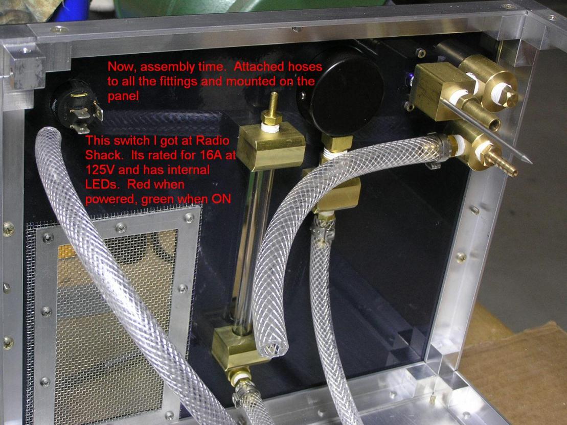

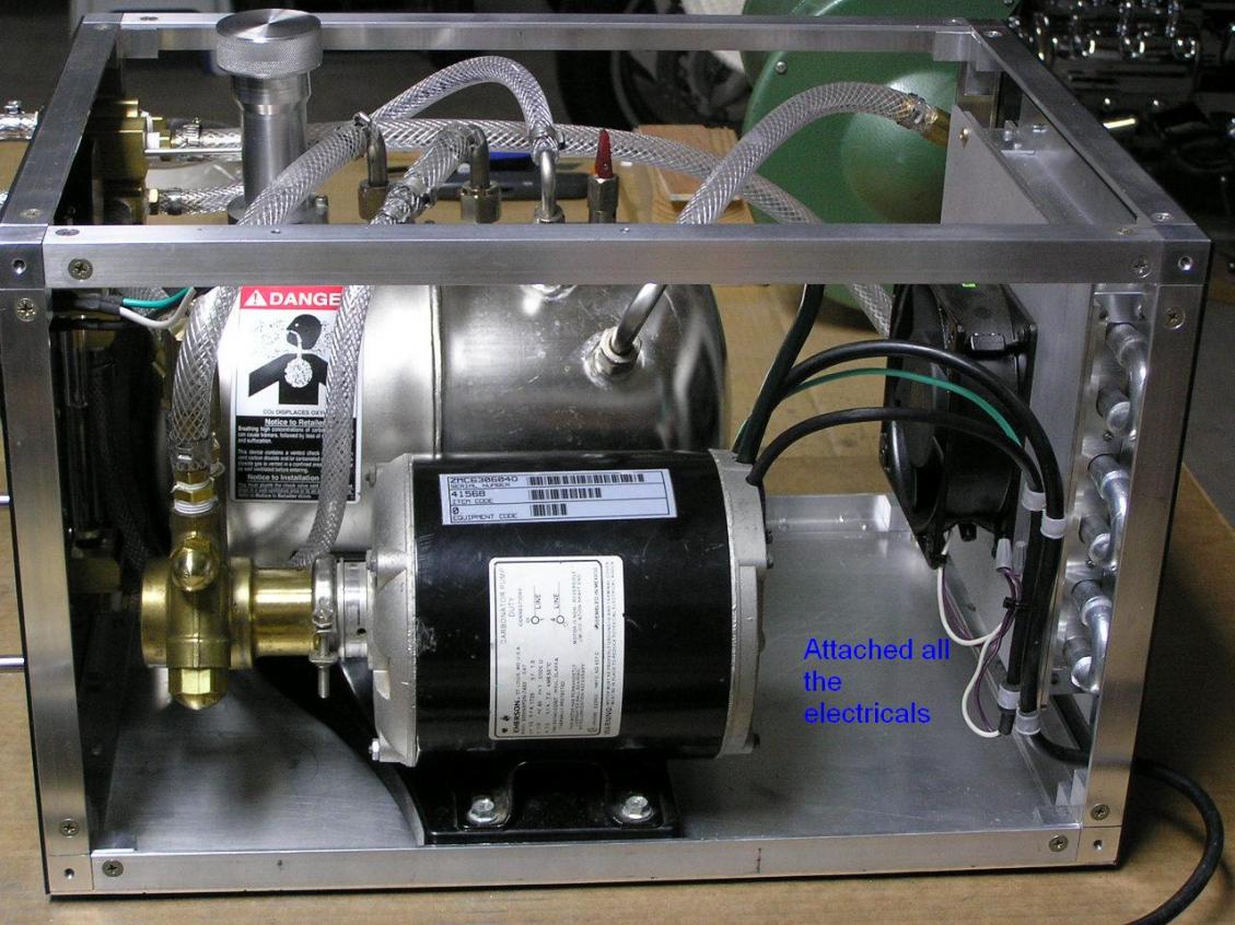

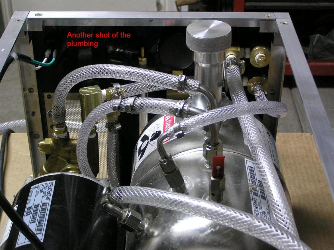

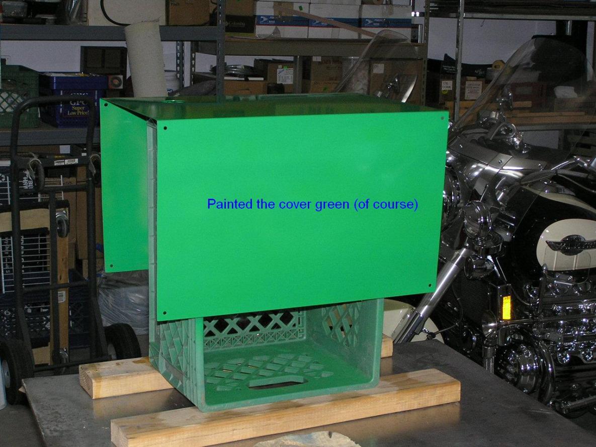

    Now, the fun part - final assembly. I figure all total, I've got less than $200 in parts and materials and about $1000 in my labor LOL, but it was an interesting project. I did a lot of research on this before I started and never saw this particular way of doing it so I thought I'd post my pics. I've got the output pressure adjusted at 50 psi. The probe on my kitchen thermometer goes through the inlet fitting and lays along side of the hose going to the cooler. I wrapped it with an insulating tape so that it should give a fairly close reading on the fitting/hose temp.
    -RP
ID:	5017 Click image for larger version.
ID:	5018 Click image for larger version.
ID:	5019 Click image for larger version.
ID:	5020 Click image for larger version.
ID:	5021 Click image for larger version.
ID:	5022 Click image for larger version.
ID:	5023 Click image for larger version.
    Nice job! You folks that know how to do this stuff amaze me!
    Everlast PowerPlasma70
    Hobart Ironman 230
    Lincoln A-D/C 225
    jakemateer.com
    I just received a fairly large Dyna Flux cooler for cooling a motor controller and motor for a machine I designed at work. I think your's may be put together better than the dynaflux.
    Really nice work. I like the gauges, and the green paint is a nice touch. I'd like to see how it looks all hooked up to your TIG machine, once you've gotten it hooked up and all done. Very impressive machining work, also, and attention to detail. How did you cut the slots, holes, and shapes in that panel?
    I don't have a lathe or mill. So if I had to make fittings like that, I'd probably try to find existing fittings that have at least one threaded end or connection that I needed, saw them off, put them together and TIG weld them. I have taken two brass fittings, hacksawed desired endpieces off them, and TIG welded them together before. The brass doesn't TIG weld that cleanly (from the zinc boiling), but it is possible to make it quite solid, and even look great if you sand/polish the weld afterward, you can make the weld "disappear". It is a good way of making "custom" fittings I think, when suitable donors fittings are available.
