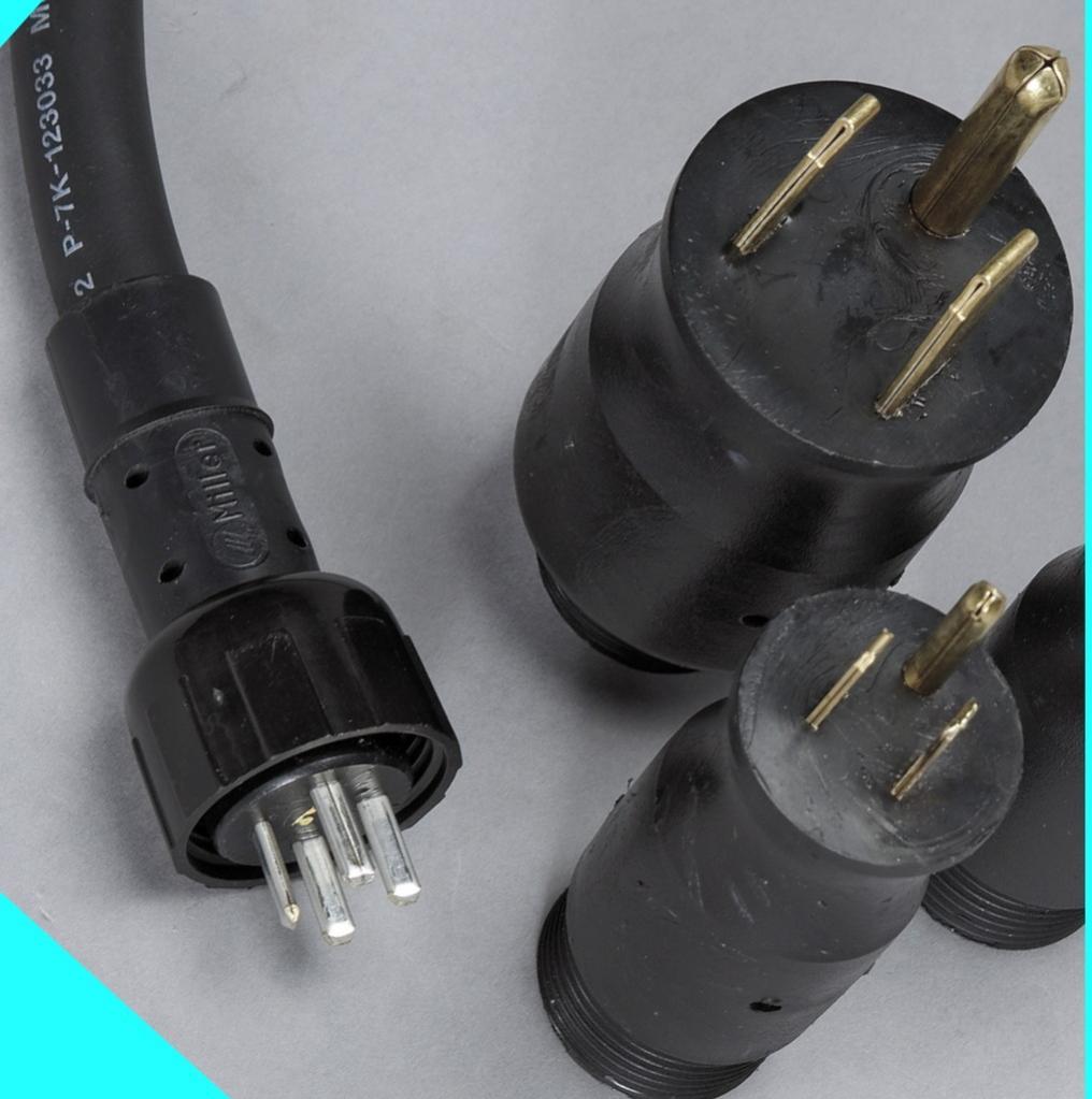

    I'm making an adapter cable so i can switch from 110V to 220V.
    Robert
    Yow I bet if you plug your toaster in with that baby in make real dark toast. Be better to build just the opposite as this looks dangerous to me. I know you won't but you never know when a not so bright friend shows up and look out.
    Bill
    It looks almost like a 30 amp twist lock, which should be sufficient, more than to say the least. That's very similar in reality to the connection system Miller uses...Have you seen the size of those pins? Small.
    A 3 pin plug on the welder cord and 2 short pig tails 1 for 110 an the other for 220 would be a nice setup also.
    I want to make a cable like this but am a bit lost as to where I might find the plug and receptacle (without being robbed blind). Also, been looking around and there seems to be a big jump in price from 10 gauge to 8 gauge wire ...

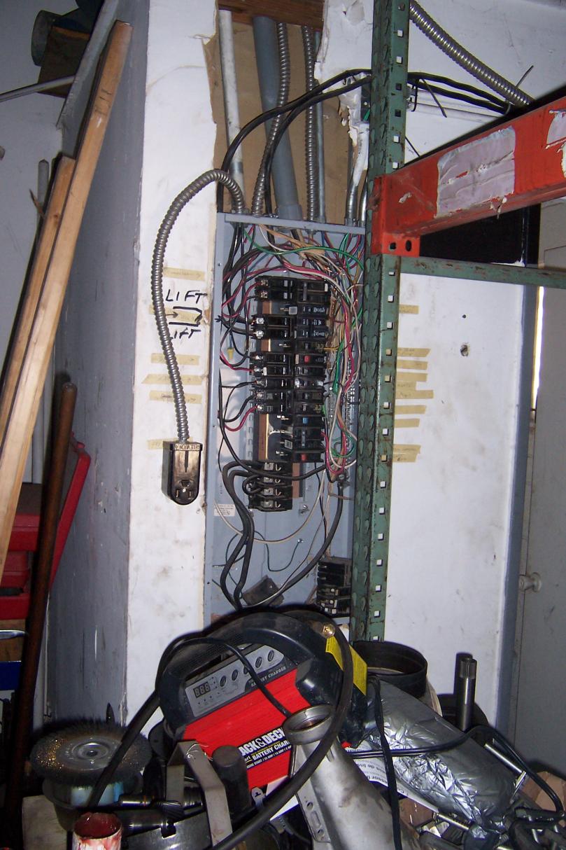

    what type of plug do you have for your dryer , and wears your fuse breaker panel box since some time dryer outlet are not high enough run a welder since most dryer outlet are only 30 amps in new homes

ID:	6376got a good deal on ebay on my wire got a 250 roll for only 160 bucks , what even more crazy all my wiring for my machine shop machines is 6 gauge around 1500 feet of it going every were this is just one of my panel boxs i have 3 of these in my shop
