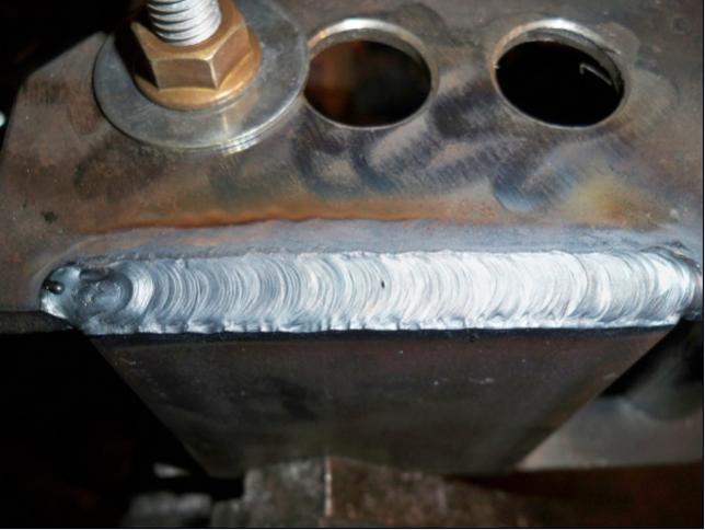

    Here is a sample of what I like to offer for "exposed work".
    I know I didnt get full coverage, It's just a quick sample on some mild steel.
    Its what I am limited to with my TIG right now.
    I need a MIG bad!!
