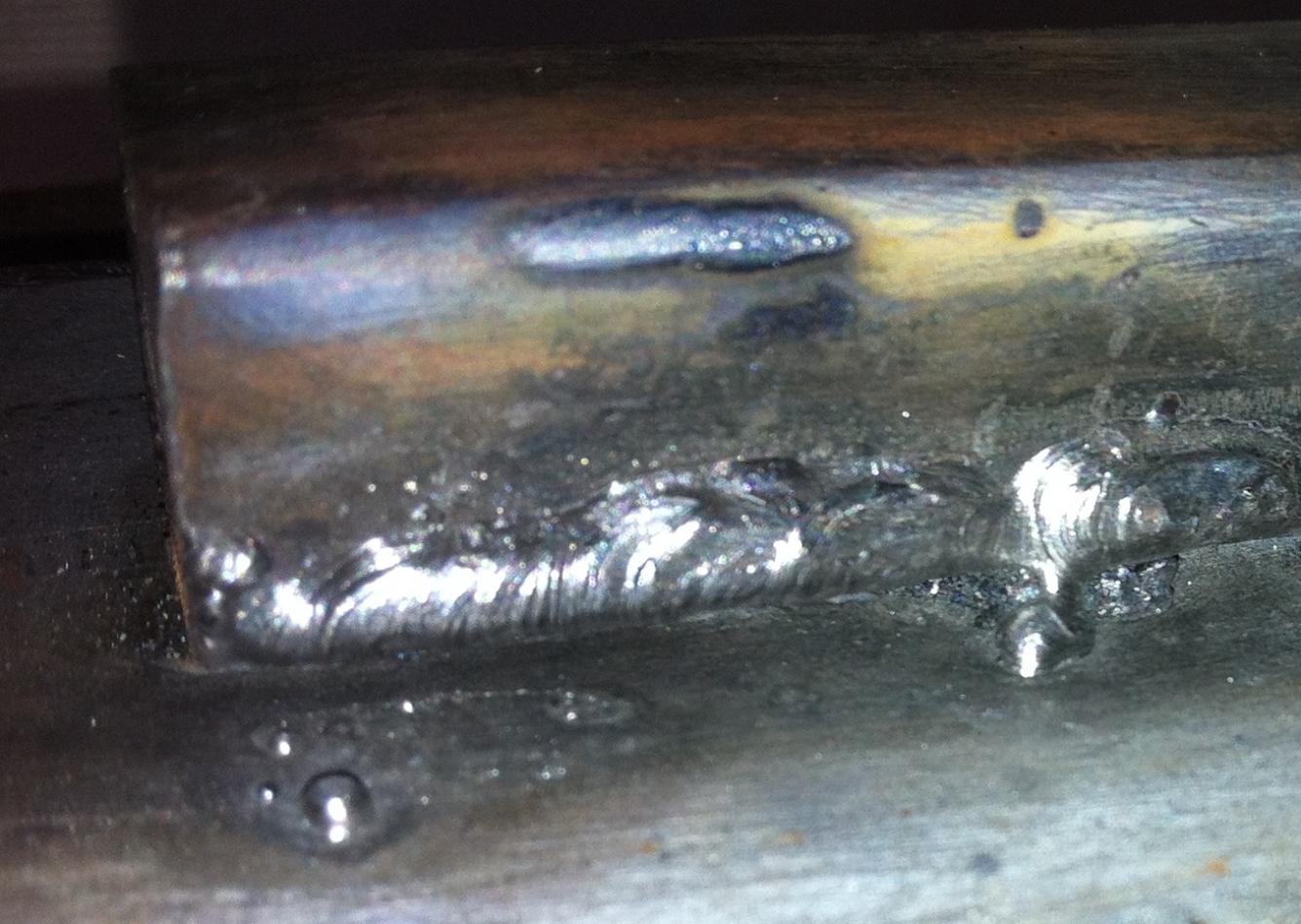

    So, I tried out the 1/16" 7014's yesterday, and had the same issue as the 6013 1/16":
    This is 1/2" square tube on top of some sheet metal (not sure of the gauge ... will have to check). You can see the gap where the radius of the square tube knuckles under. When using the 1/16" rod, I spend a lot of time putting down the bead, end up with a nice thick layer of slag, and it looks great. But when it cools, and I chip away at it, you can see that all of the filler stuck to one side or another. The picture looks like there is a gap between the pieces, but these were flat and solidly clamped together when I welded them.
    Anyways, I went back to the 3/32" rods, and I'm able to run the 6013 at about 60 amps now, which seems to be just cool enough to keep me from burning through. I don't know why, but the 3/32" deposits filler on both pieces pretty evenly (maybe it's the flux to filler ratio?). I can put down about 1" of bead before I run the risk of getting it too hot, so I'll probably just need to work in sections. If anyone has any idea what I might be doing wrong with the 1/16", let me know!

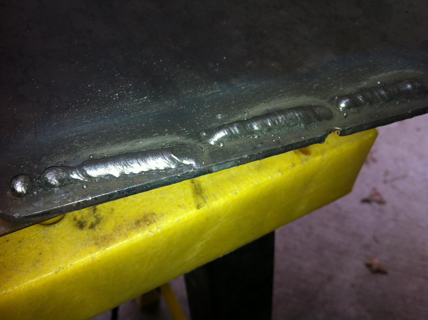

    Gabe, I tired moving really slow today (with the 1/16") and increasing the weave, and I was able to get better fusion between the pieces. But, it was still incomplete ... I think the slag is getting between puddle and the base metal, so I end up putting down a irregular bead instead of fusing the pieces. I ran a couple of flat beads with the 1/16" just to check out the speed:
    I thought these looked pretty good. I ran these one after another, each is about 1.5" long and each consumed a 1/16" rod. When welding into a "tee" joint, I've been slowing down ever further, laying down maybe 1" of bead and weaving.
    I'm not sure why, but I have fewer problems with slag inclusion if I use 3/32" rods. I've been able to back the amps down to 52 with the 3/32", which I think will keep me from blowing a hole in the tube. I need to get out there and practice some more .

    The beads look good. Not sure why you are still getting lack of fusion and a broken weld. Maybe get some 6011 or 7018. They always work good. When ive used 1/16" rods I usually keep is pretty high. A lot of the time when running a whole rod the last 1" or something will just melt the rest of the way all at once. Its a bit waistful but can be prevented by letting the rod cool once while welding.

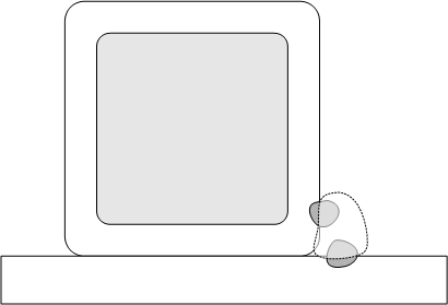

    Could the lack of pentration be a weld polarity issue? So far you've been working with 6011, 6013, and 7014 rods; 6011 is DCEP; 6013 and 7014 are DCEP/DCEN. DCEP gives slightly more penetration, according to the Miller site. Do you recall what polarity you used? It just seems odd that the bead sticks to one surface or the other but not both.
    I've been using EP mostly, but I have tried EN ... however, I've been testing out different rods, so I do not remember where I tested EN. I'll give it a shot with the 1/16" 6011 and see what happens.
    Here's a picture of what I think is going on (the scale is a bit off):
    The filler puddle likes to stick to the side, but not really in the corner. I think some of this has to do with the way the sq tube knuckles under away from the filler. The flux fills in the gap and flux repels the filler, so I have to try and fill in the gap with the electrode. When I can see this happening in the puddle, some times I'm successful dropping filler into the gap. As an analogy, I think this is like putting two drops of oil in a glass of water, and trying to join them using a toothpick. I think this is also why the 3/32" works better for me, as it puts out more filler and less flux, relatively speaking.
