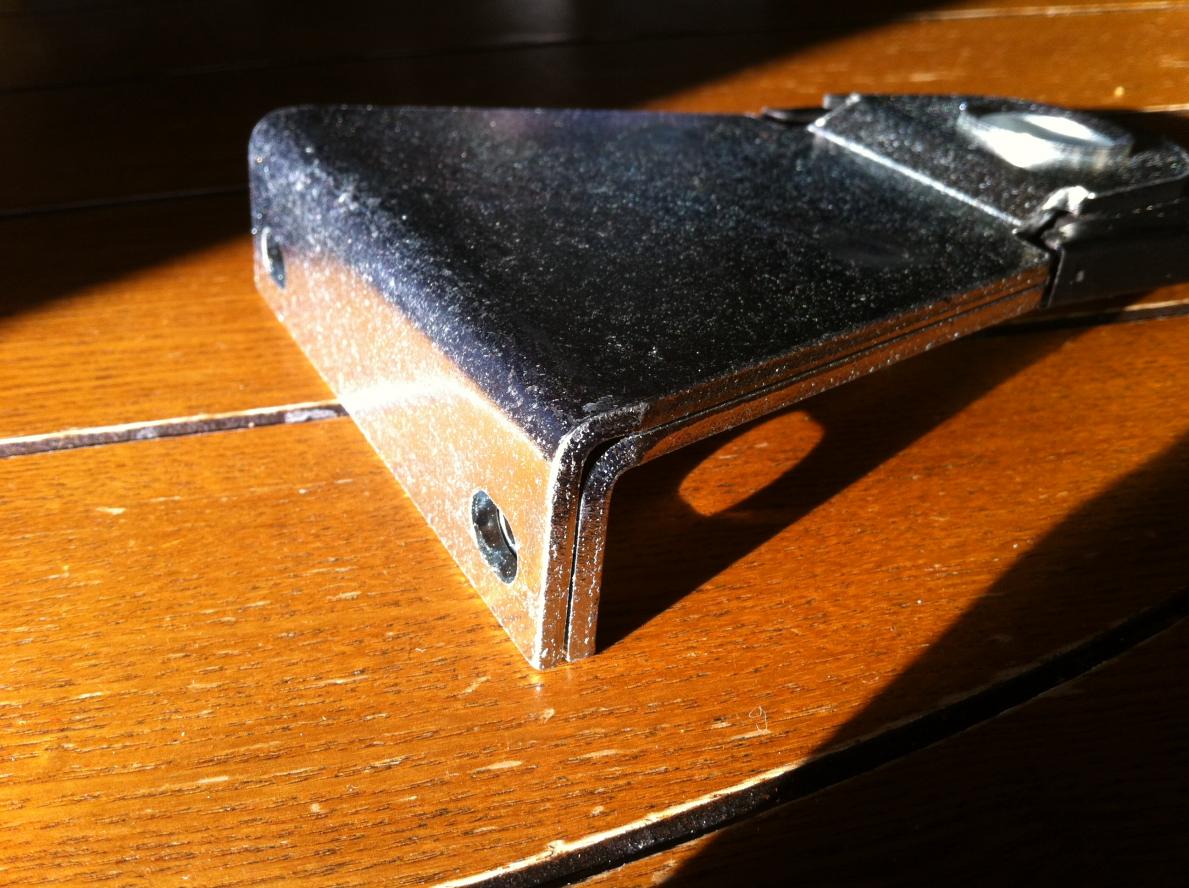

    Hi everyone,
    I am getting ready to install a gate operator on a wrought iron gate, and I will need to weld the brackets in place. I just pulled the hardware out of the box, and noticed that the brackets have a shiny silver finish, which I assume is galvanized zinc:

    Does this look like a zinc coating, and if so, then preparation would be to grind the coating off where I plan to weld, correct?

    It looks either galvanized, which I'd expect not to be as shiny, or cadmium plated.

    I think it must be cadmium then ... I googled a few pictures, and the finish looks very similar. So, is the preparation the same? (i.e. grind it and wear a respirator)

    You might drill a small hole in an inconspicuous place to find out exactly what you're dealing with.
    My plan for the zinc parts is to use the brush wheel side of the bench grinder, but I'm pretty sure the shiny coating is thin enough that it would burn off in an arc. The fumes are unpleasant though, you don't want to breathe them.

    If that coating is in fact cadmium, the abstract at this site, section 1.6, says: avoid avoid avoid.
    http://www.astm.org/Standards/B696.htm
    Most bolts, nuts fasteners, and other hardware with a silver color to them are cadmium plated. This is common. Neither are great to breath, but unfortunately, most of us will weld on those sooner or later. Keep you head out of the fumes, and your mind in the game to reduce any poisoning risk. Fortunately galvanized poisoning is rarely fatal or causes long term damage because of the fact that Zinc is a necessary element used by the body. It will eventually be eliminated from the body. Before the body recovers, though, it isn't any fun. Been there, and had to do that.

    Cadmium poisoning from welding is bad, and cumulative, and after enough causes permanent nerve damage.
    Zinc poisoning is not as bad on the initial poisoning, but it sits in the lungs and causes cumulative damage to lung and nerve tissue. While these metals are necessary in the body, they are not meant to be absorbed through the lungs as a gas like that.
    GRIND THOSE HINGES FIRST!
    They are flat, uncomplicated shapes, and it's just too easy not to. It's not a thing to gamble with.
    Cheap insurance. Plus, it'll be easier to weld, and you won't have the cracking problem from weld contamination. Weld off the grind area, and then an extra inch or so to clear the zinc away from the heat affected zone.
    To me, it looks like zinc coating. It's certainly the cheaper of the two coatings. cadmium usually has a much more 'uniform' surface finish. If these were cheapy hinges from the local hardware store, then they're almost certainly zinc.

    Both Zinc and Cadmium are often used to plate steel for some additional corrosion resistance, and both have low vaporization temperatures. So when welding, not only do these substances liquify, they will actually phase change to metal gas. The metal gasses then combine with oxygen and make "smut" - tiny little particles that look like powder, (often black like soot but other colors are possible as well.) If you weld this stuff, use good ventilation, hold your breath until you're out of the fumes, etc. Don't suck it in. The smut can often kind of harmlessly brush off the surface though. Removal before welding is not a bad idea. Flap wheel on an angle grinder comes to mind. You might want to restore the corrosion resistance lacking in the weld areas with some cold galvanized spray can (9x% zinc content)

    Thanks everyone. So, grind it, ventilate and wear a respirator.

    Cad plating can often/usually have a greenish, yellowish, or blueish coloration. Zinc, pretty much always grey. Electroplated zinc (thin layer) is often shiny and smooth. Cold dipped zinc (thick layer, formed by the steel part being immersed in a vat of molten zinc with additional special process/ingredients to make it "stick") is usually more of a matte texture and a dull grey color.

    As a general rule of thumb, for the best weld strength, remove all platings in the area to be welded, and weld together known base metals with the proper alloy filler rod. Otherwise, any liquid plating metals can mix into your weld puddle and make an "unknown" alloy having "unknown" properties.
    Edit: on closer up view of those hinges, I would say they are either electroplated (thin) zinc, or cadmium plating. Given their color and shininess, I'd place my vote towards the electroplated zinc.
