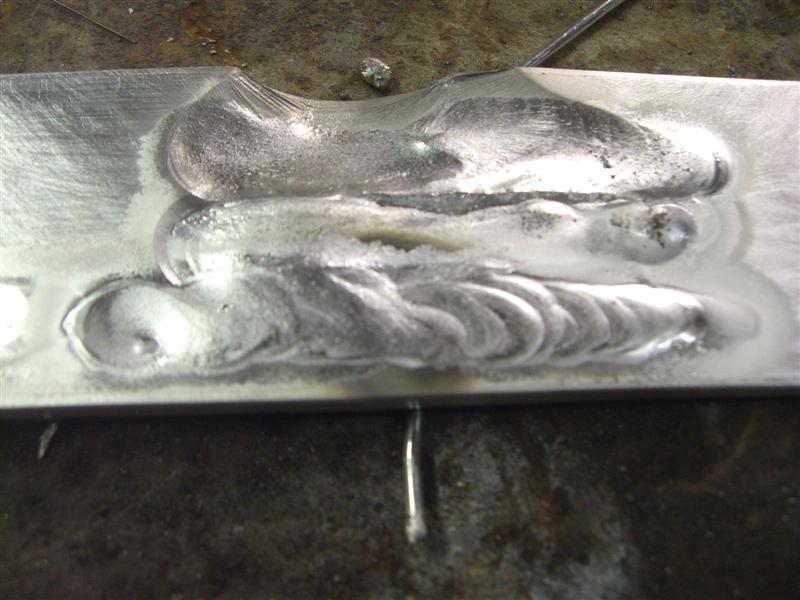

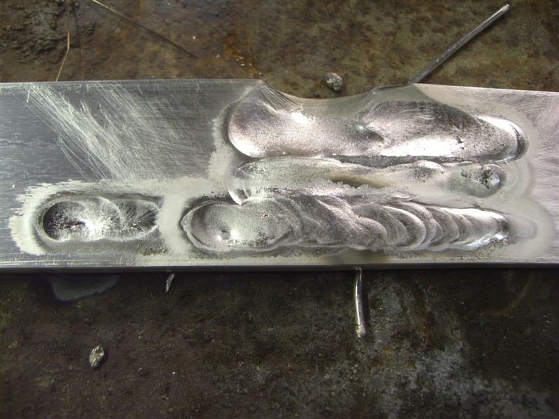

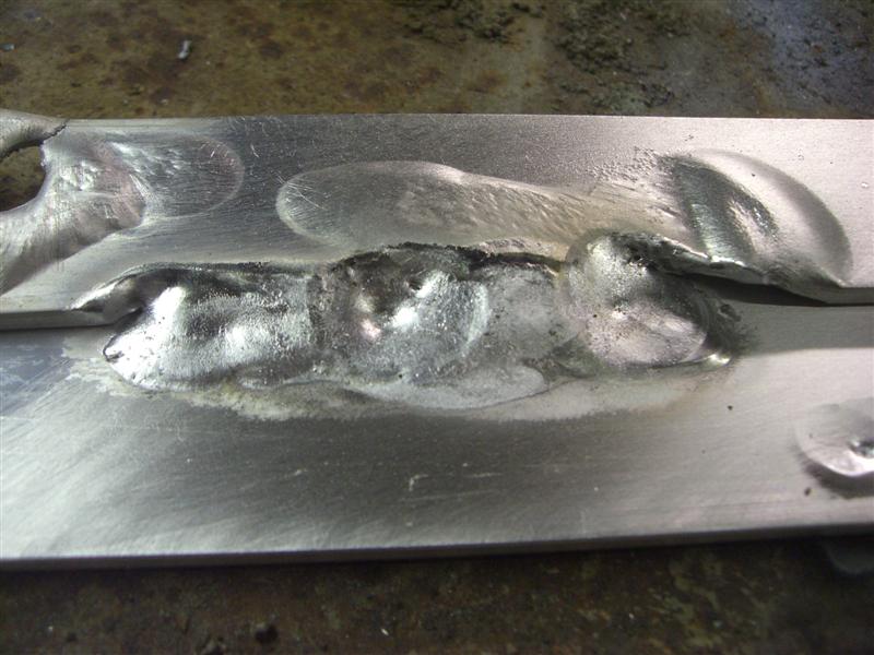

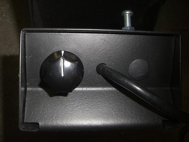

    Here are a couple of shots of my latest progress. I was using the settings given in post #2, with the pedal knob as pictured (I wish there was some kind of divisions marked around the pedal knob, so i could make my best adjustment closely repeatable).

    I didnt get a chance to pick up some acetone yet.

    You're way too hot on those welds. Lower your current and focus on a small area at a time, then move on. It is not a race and may take a bit of time to get teh puddle to form.
    You want to use just enough heat to get a very small amount of melt then dip the rod and move teh torch to teh adjacent location and repeat. You may need to pause a bit at each "spot" to get it to flow.
    From the looks of things, you will likely be better off starting with steel, first just pushing a puddle with no joint, then moving to joints. With steel, you will be able to distinctly see the puddle forming, not so much with aluminum and it will melt through as you have been experiencing.
    Try not to focus so much on teh settings of the foot pedal. It is variable, nothing says you have to mash it "wide open" to weld. Set it and then just use the pedal to adjust the current as needed. That is the reason for having a pedal., otherwise, just try using the torch switch.
