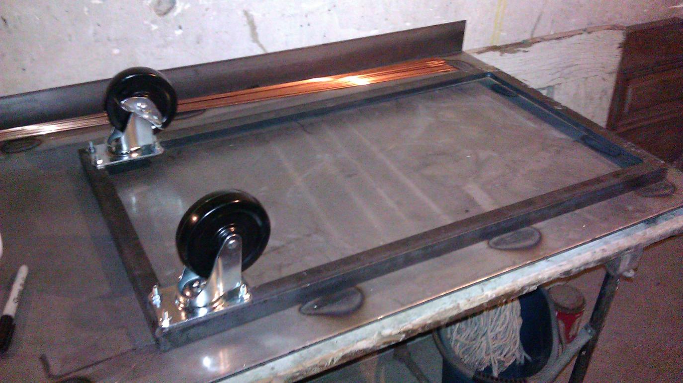

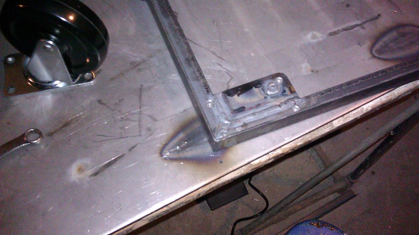

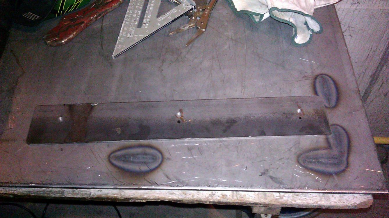

    Well my 200DX is sitting on a table with th cord stretched across the room, and the Argon tank is on the floor, So its time to build a welding cart. I started with 1x1 angle, it will be 16x30" I got the perimeter made so far.Click image for larger version.

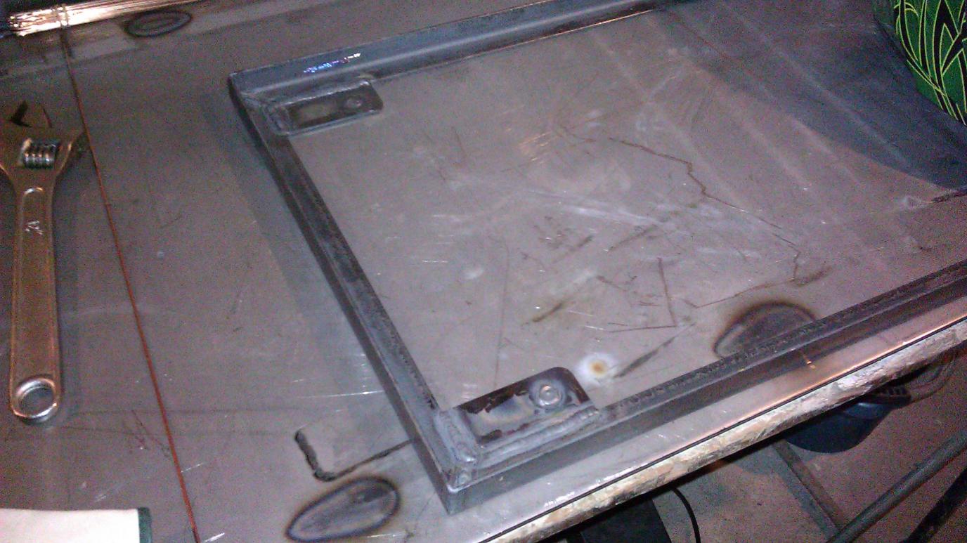

    Used some scrap and welded the mounts for the front casters.

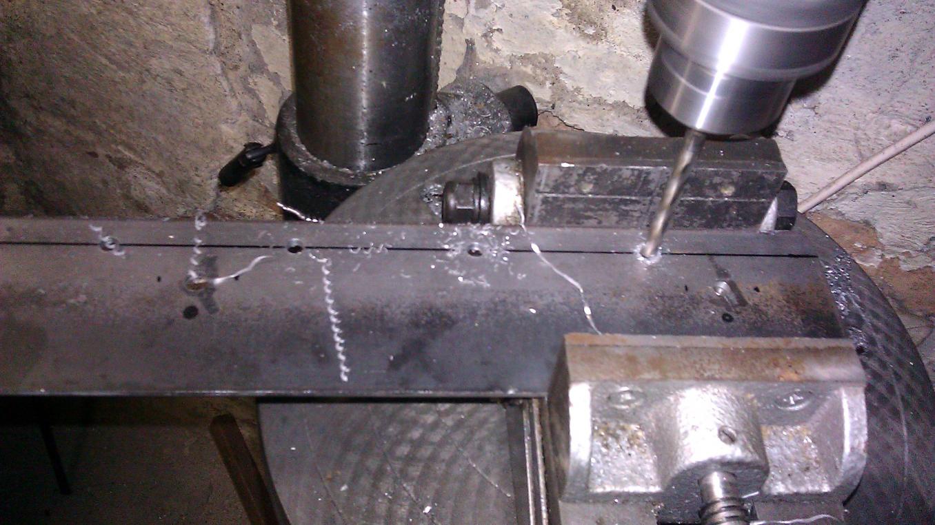

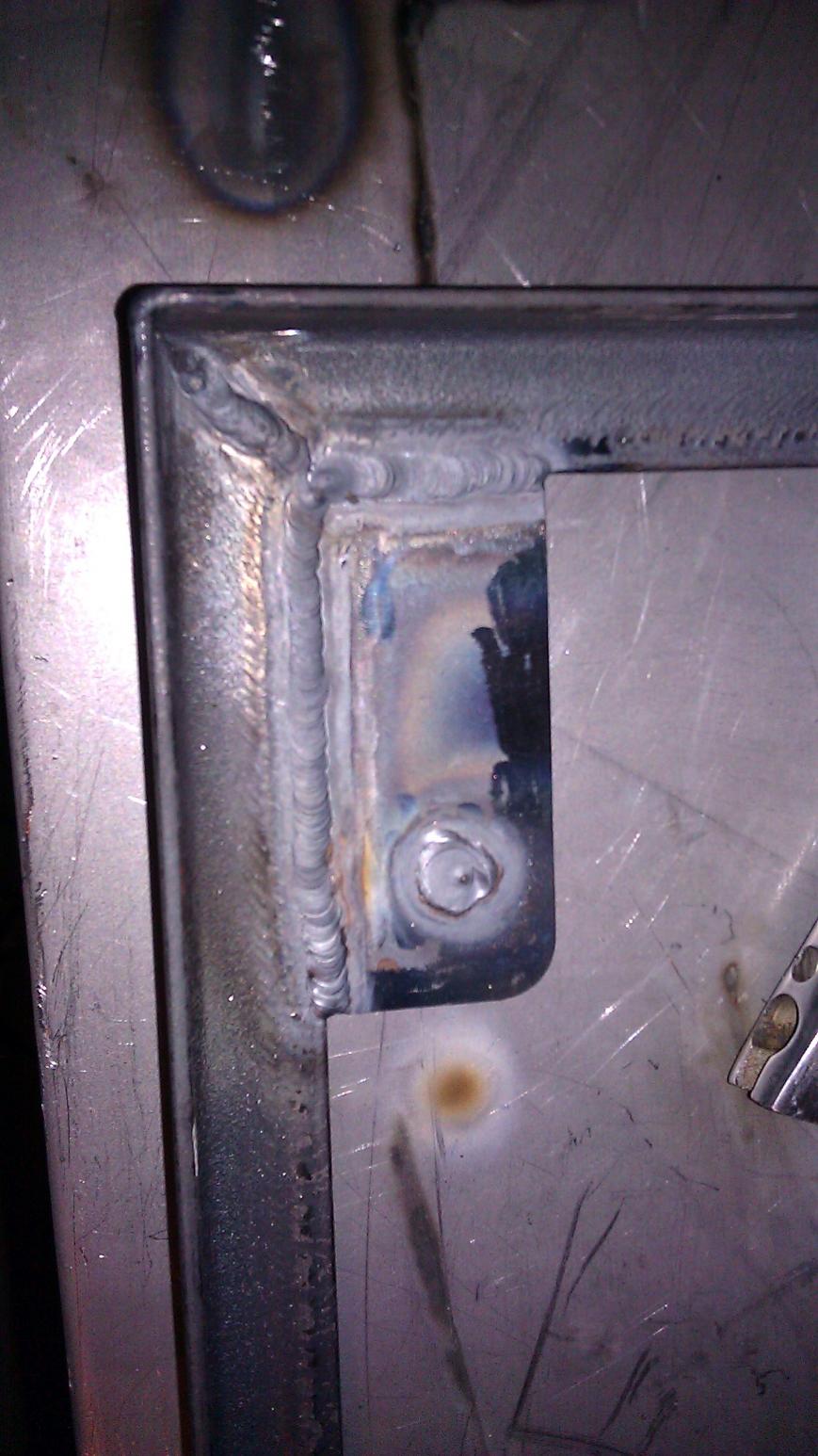

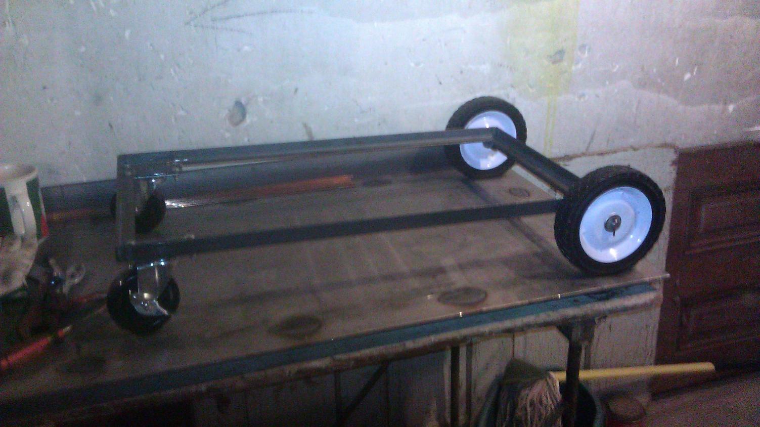

    Got the hole drilled in the mounts and the casters bolted on.
    I have a pair of pneumatic wheels but the centers are 5/8 and I picked up 1/2 inch rod, so back to the steel yard tomorrow.

    Pneumatic wheels roll nice, but how often do they go flat..
    a piece of copper 1/2 tube might shim those axles for ya.

    They still hold air after a year, but their not mounted to anything. That wouldn't be good if 1 goes flat ,then have the possibility of it tipping over. I bought them over a year ago for another project but never used them. Maybe a trip to the hard ware store indtead.

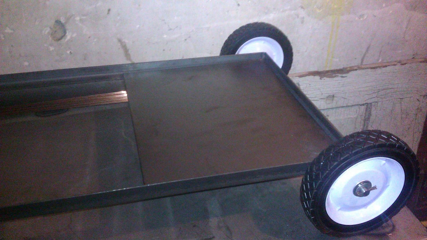

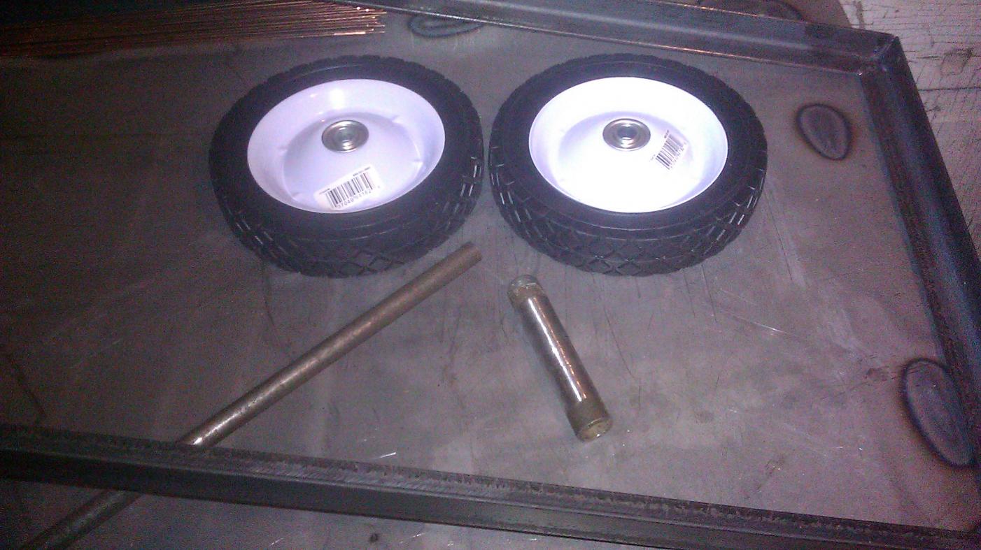

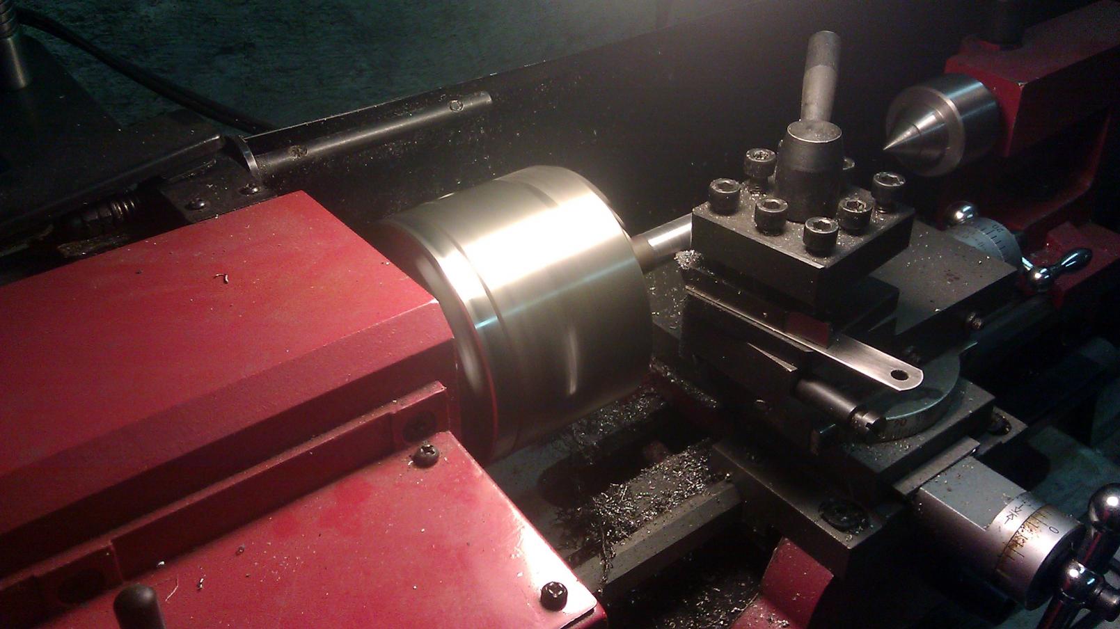

    I went to Menards and picked up some solid wheels, got home and tried to slide em on my 1/2 rod, They wouldn't fit , turns out the rod I picked up at the scrap yard was 13mm not 1/2 inch. nothing the lathe couldn't handle. cut a piece of 1/8" plate for the tank to sit on and tigged in place.

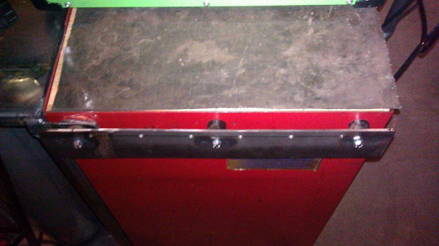

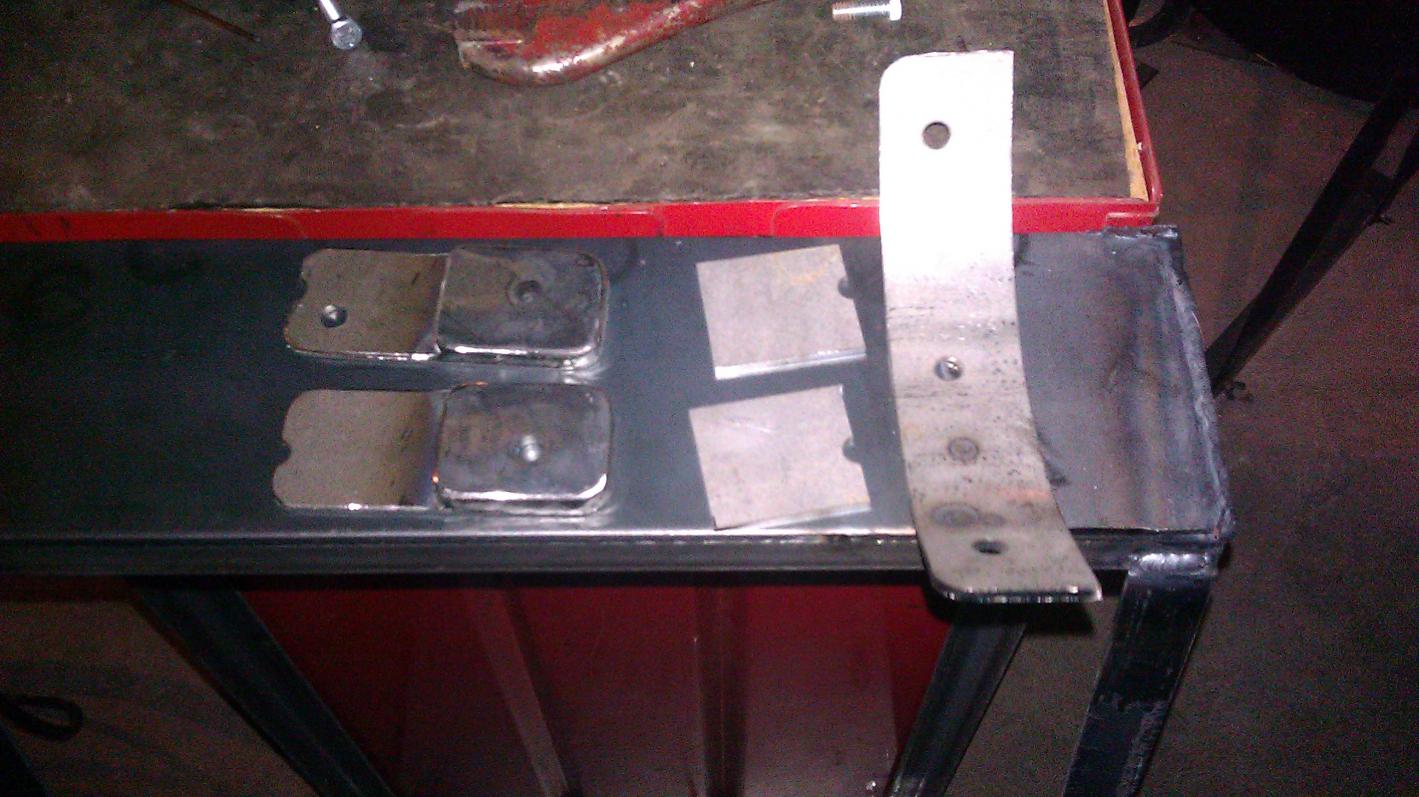

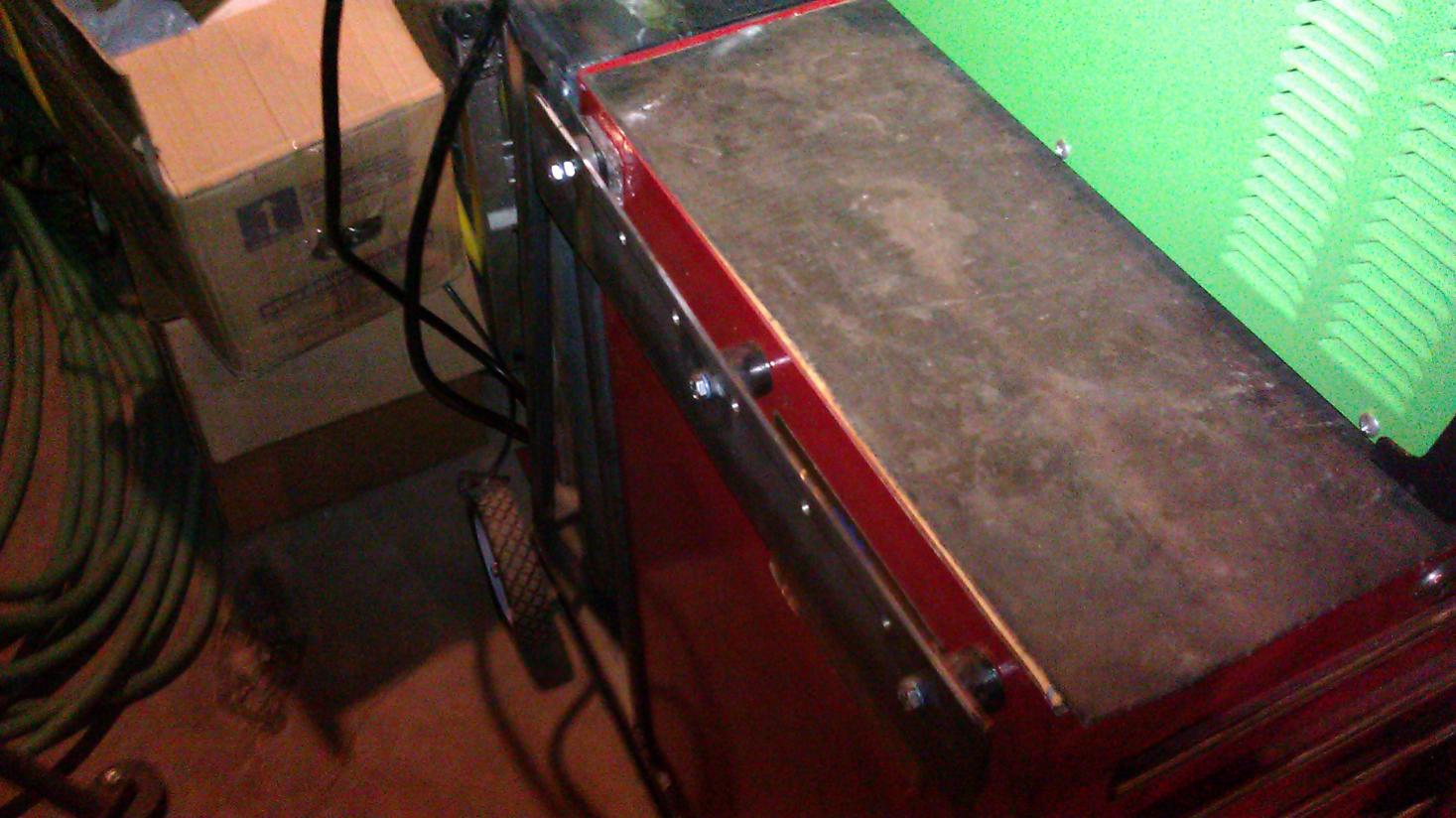

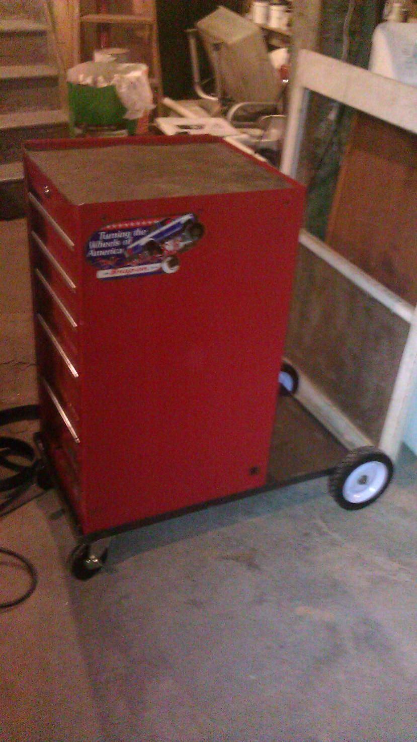

    This side cabinet was hanging on my toolbox roller cabinet, It had nothing but junk in it, so I emptied it out and set her on the cart, lots of space for consumables, torches, pedal, stinger etc. Its not long enough and I'll have to extend the back of it.

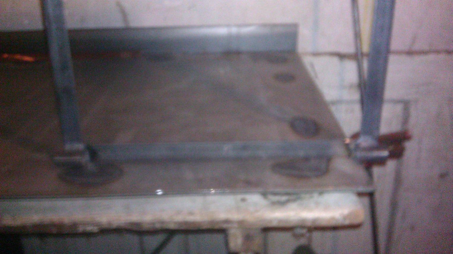

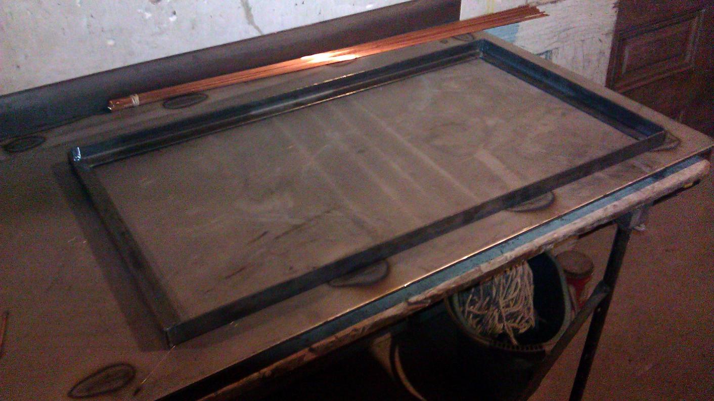

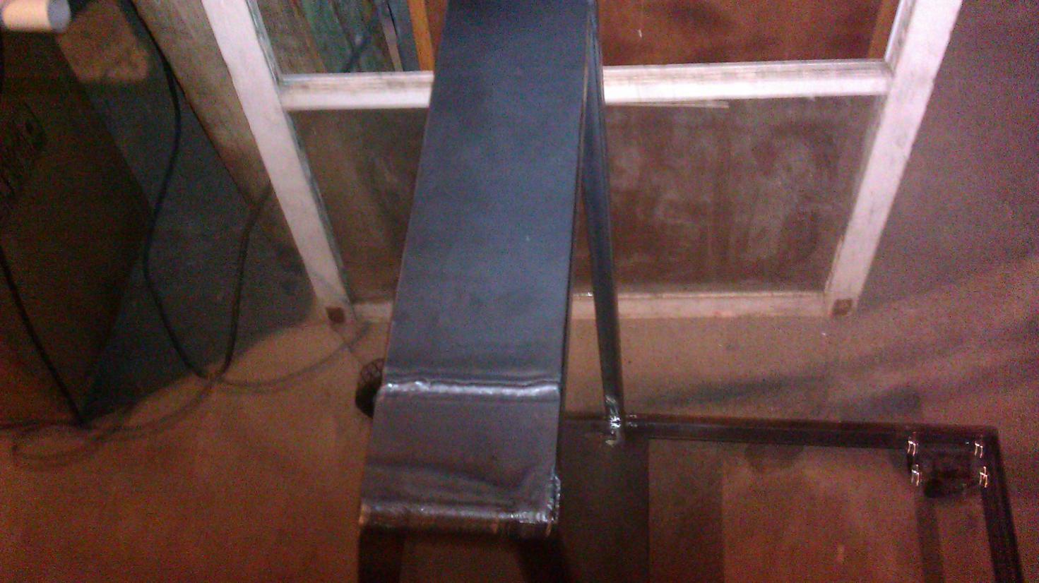

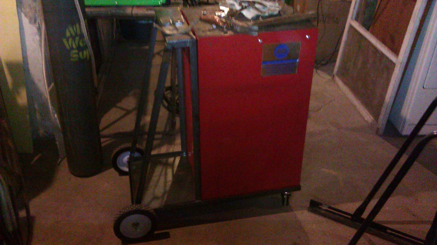

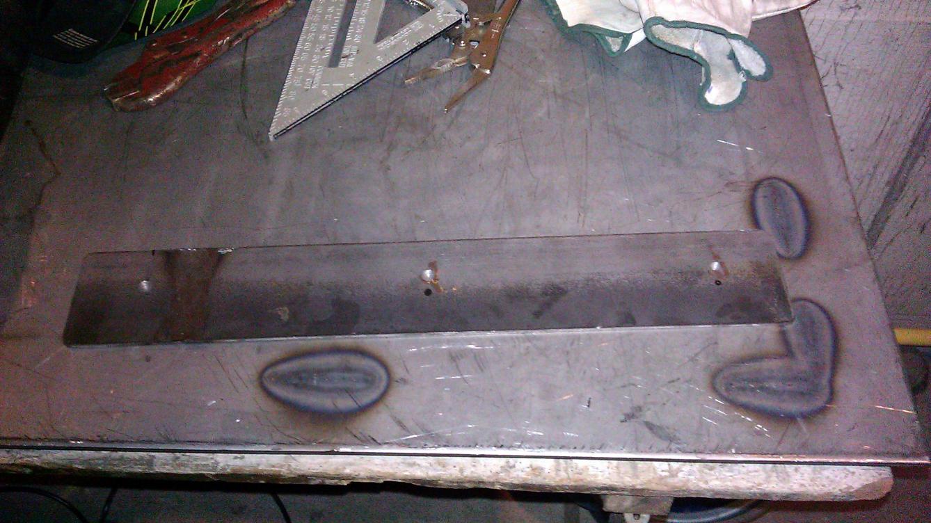

    Got some more done tonight. I ran out of angle iron so had to use some square tubing, also to top plate was to short so it was made in 2 pieces. all I have left to do is the side brackets to mount the cabinet to the cart and the tank strap. some stuff is a crappy lookin , I was in a hurry, Even when Im not in a hurry my stuff is crappy lookin

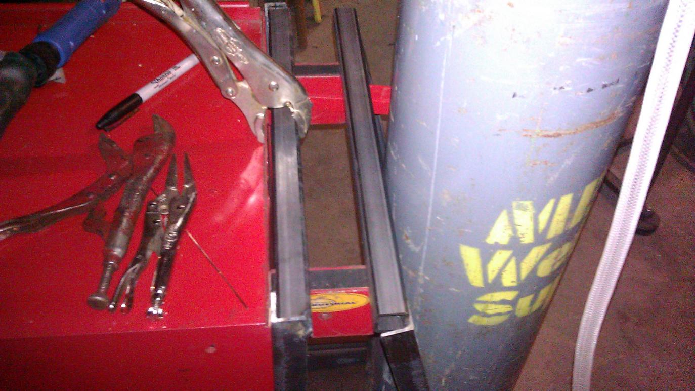

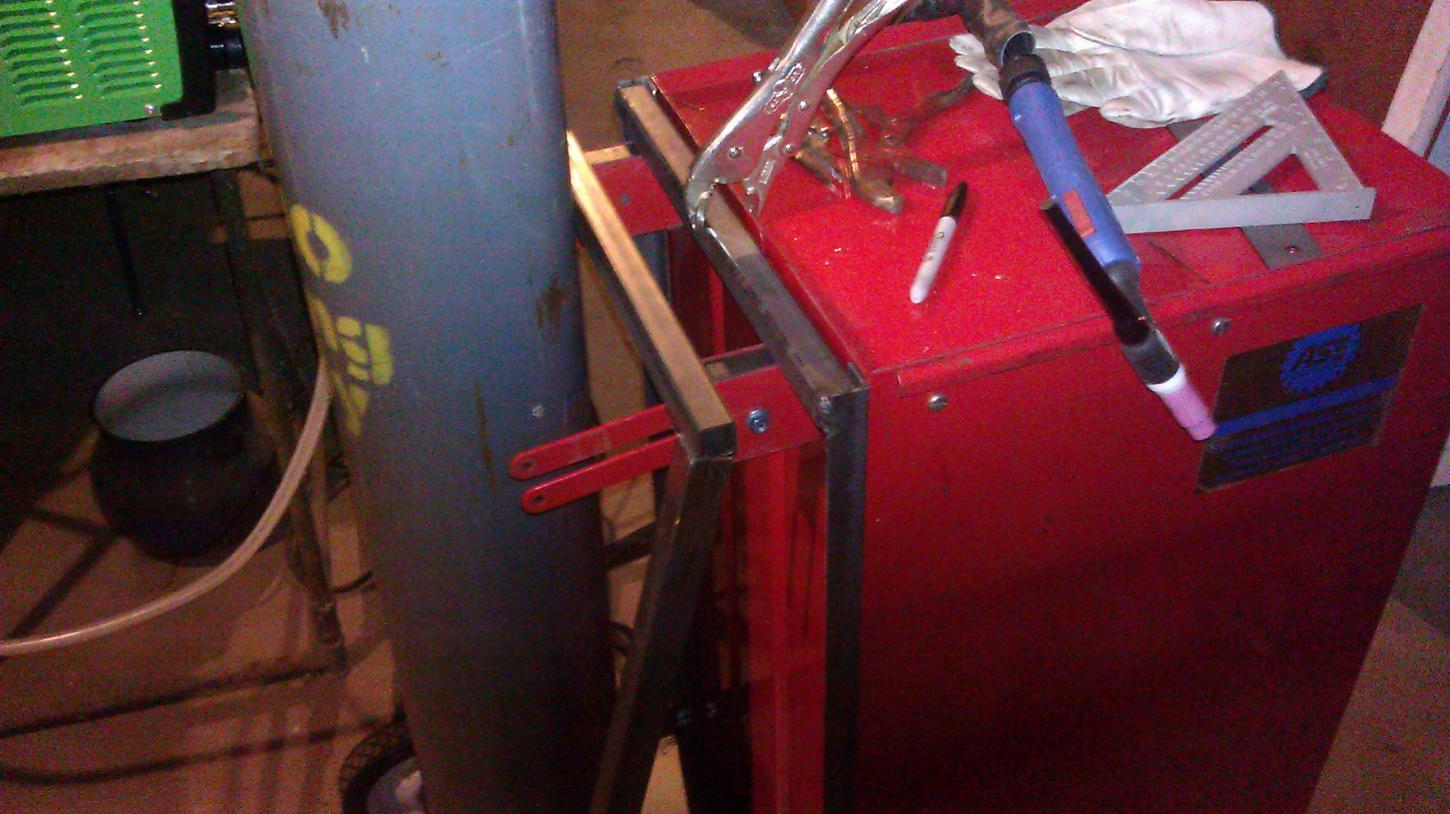

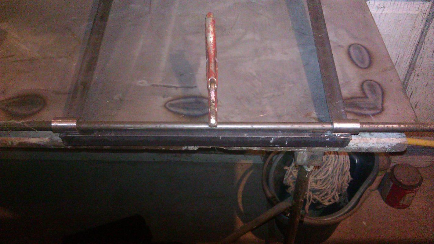

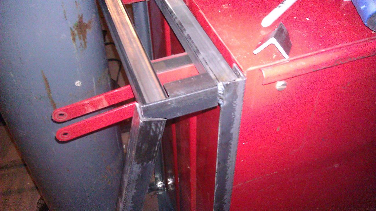

    Well the uprights and table extension is done just have the brackets to mount the cabinet to and the tank strap. then its on to some hangers for it and some filler rod tubes.

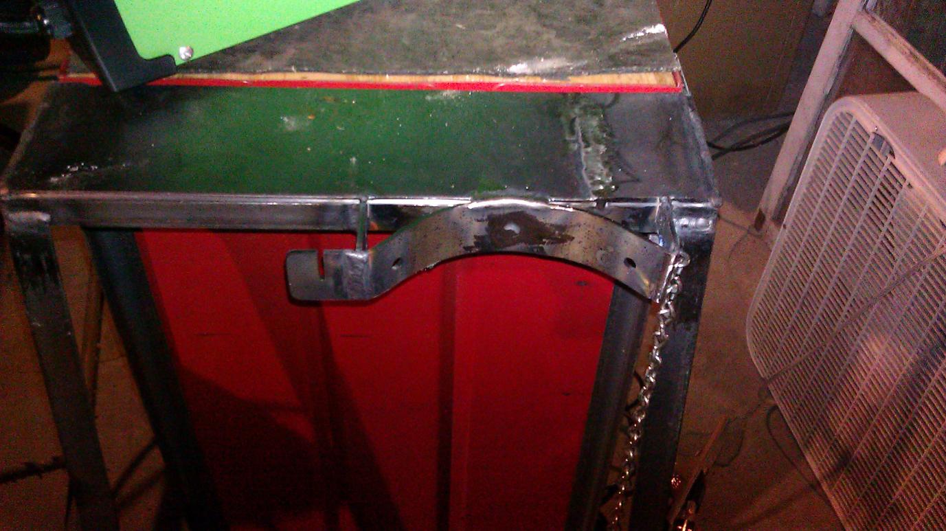

    My impatience really starts to show toward the end of a project. I finished the tank strap and safety chain thingy.

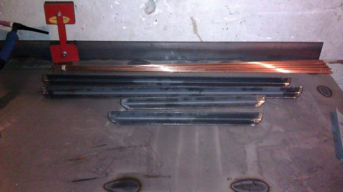

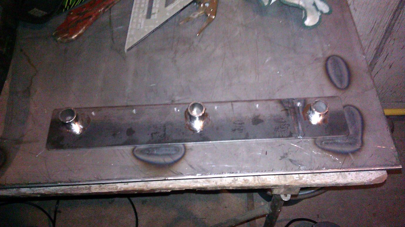

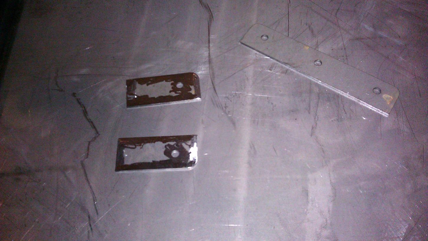

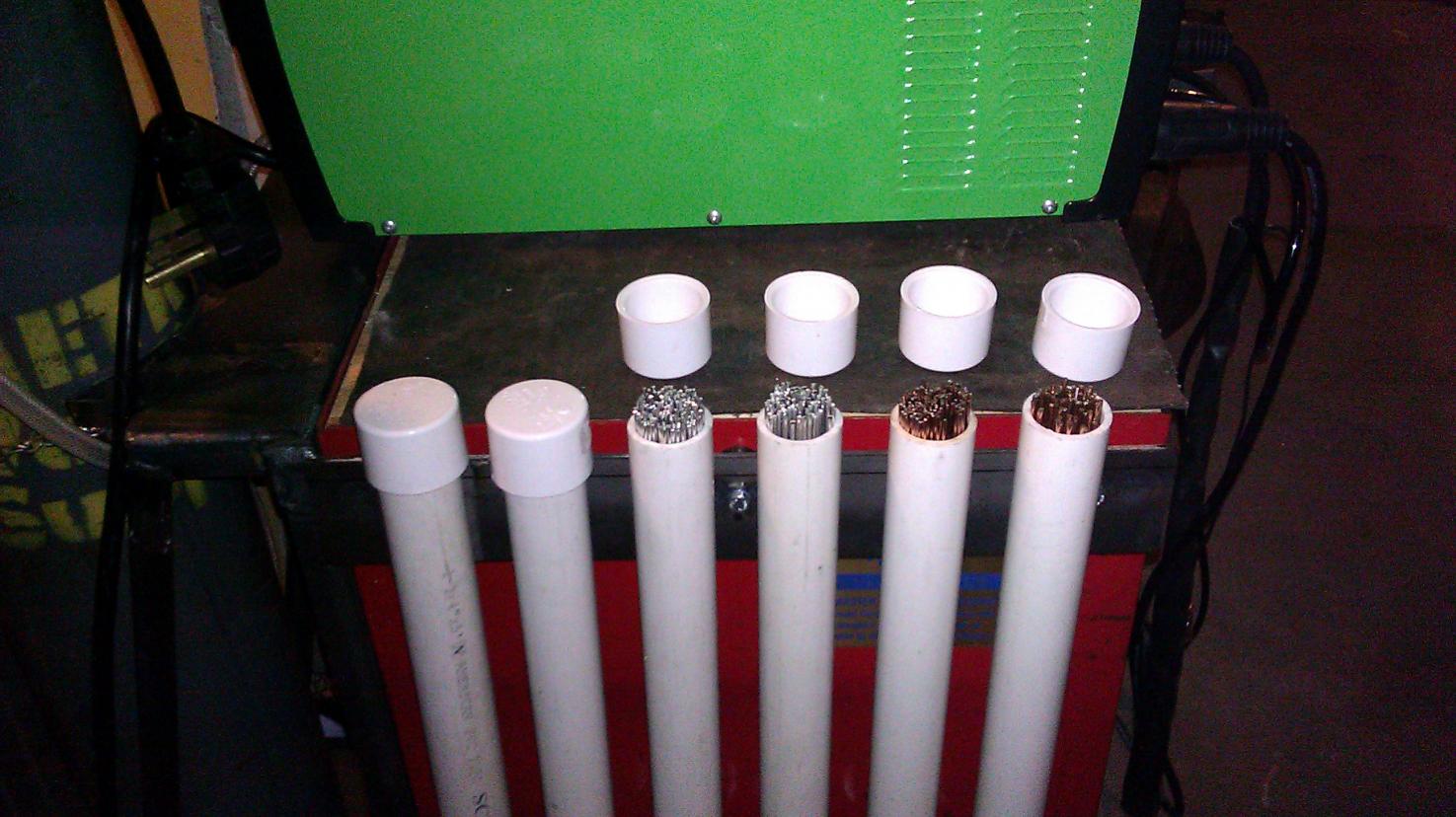

    Ok , I got the side bracket to hold the filler rod container tubes done. This is the second one I made, the first one I screwed up on so I wont bother posting pics.

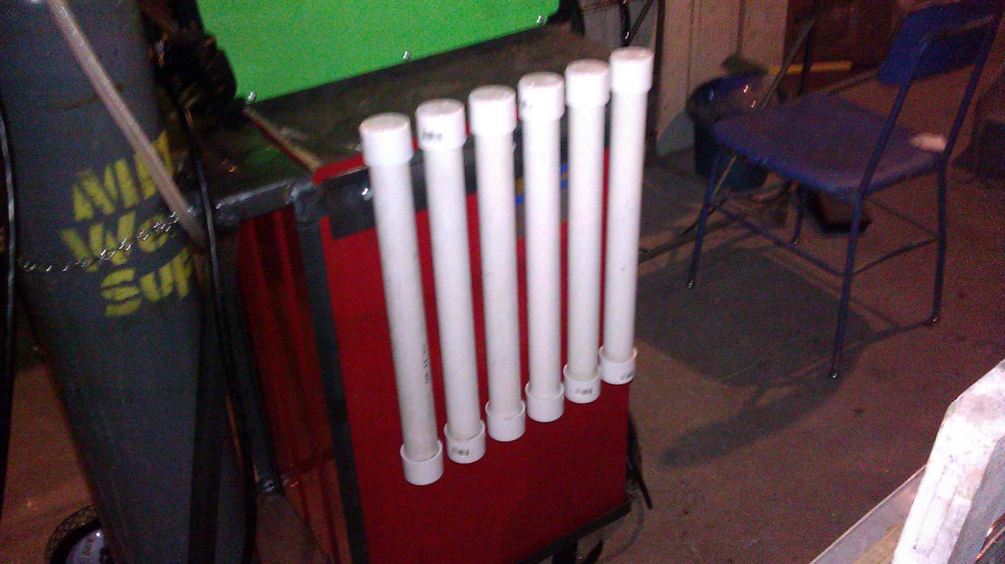

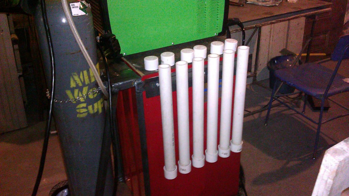

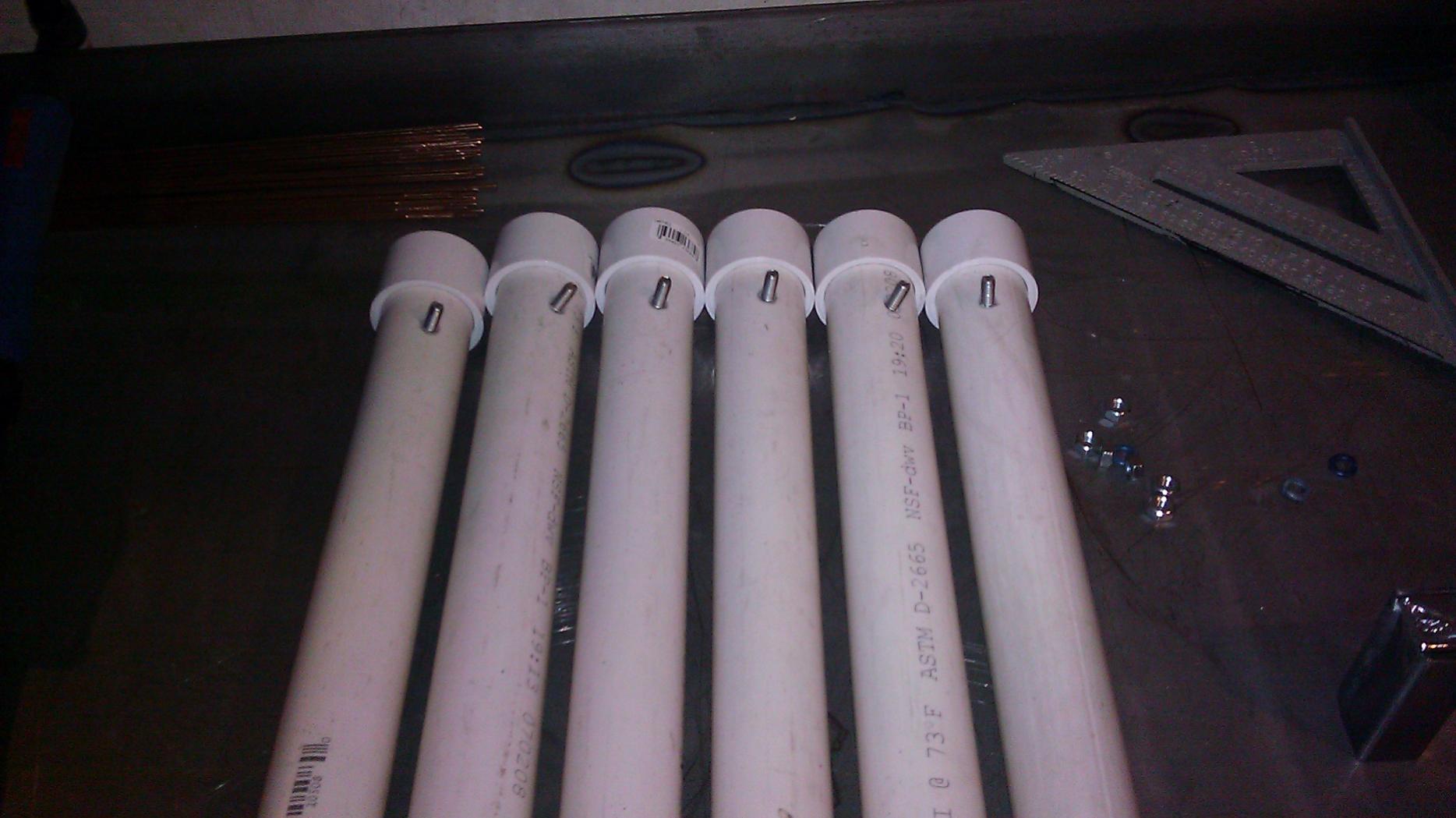

    I used pvc to make the tubes, glued caps on the bottom and bolted them to the bracket, cut my filler rod in half to 18"

    Quote Originally Posted by Buzz View Post
    Good idea Buzz, it is necessary to add in the arsenal
    Ruslan
    EVERLAST Power Tig 255 EXT
    EVERLAST PP256
    PC300
    EWM Pico 162
    MERKLE mobimig 180K
    SELCO Genesis 352 pme
    I thought it was a good idea too but its not mine, I stole from forum member CGCING http://www.everlastgenerators.com/fo...er-rod-holders
