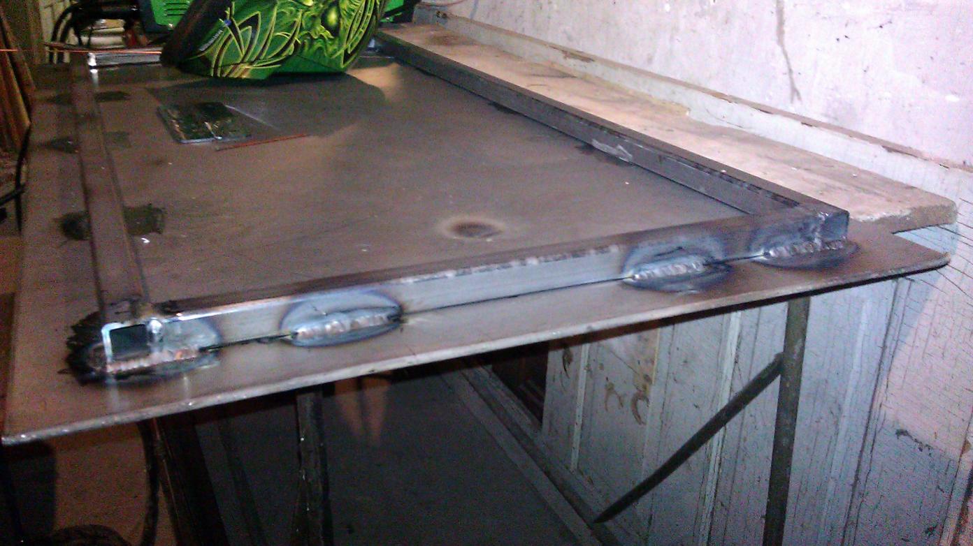

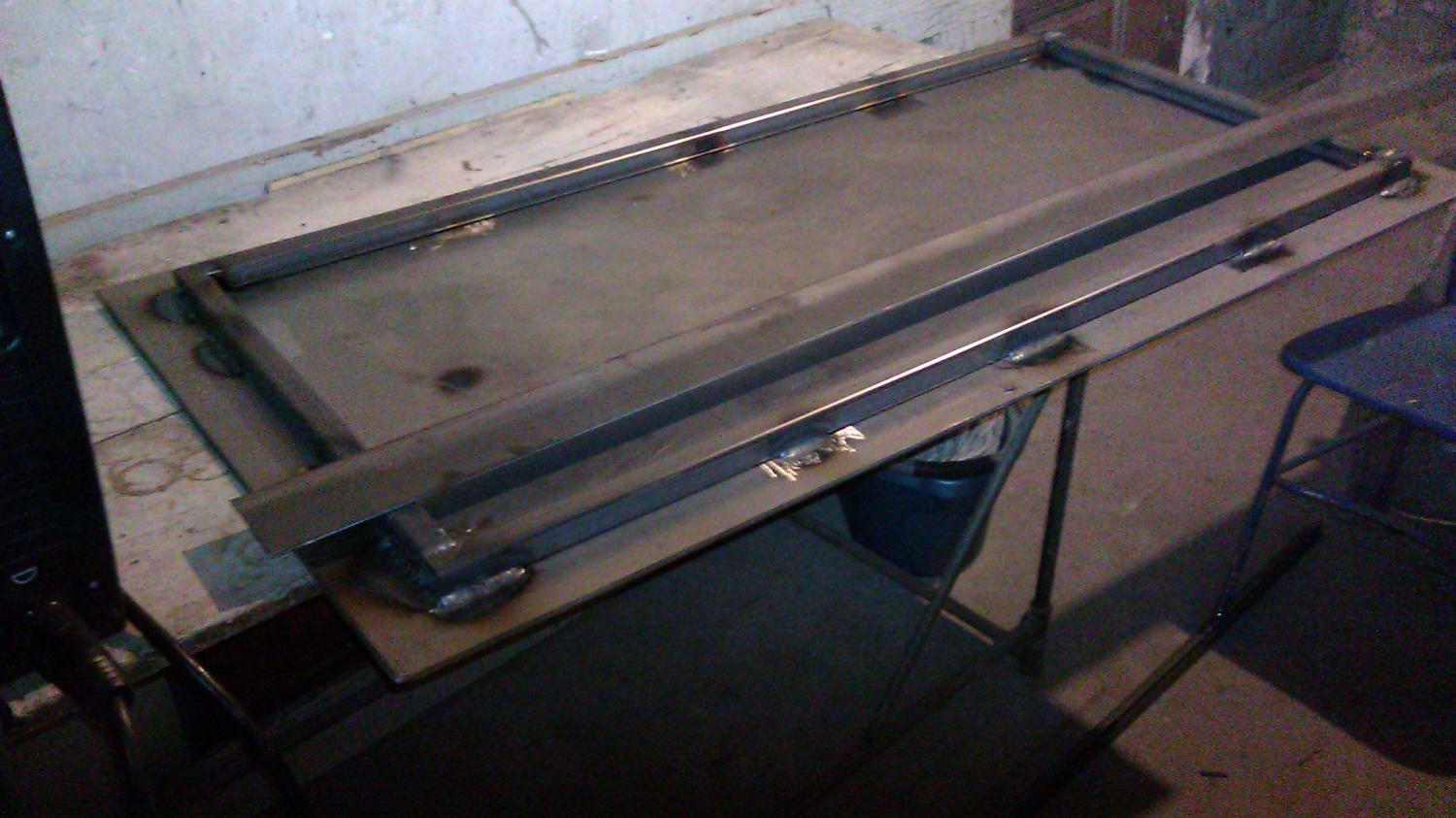

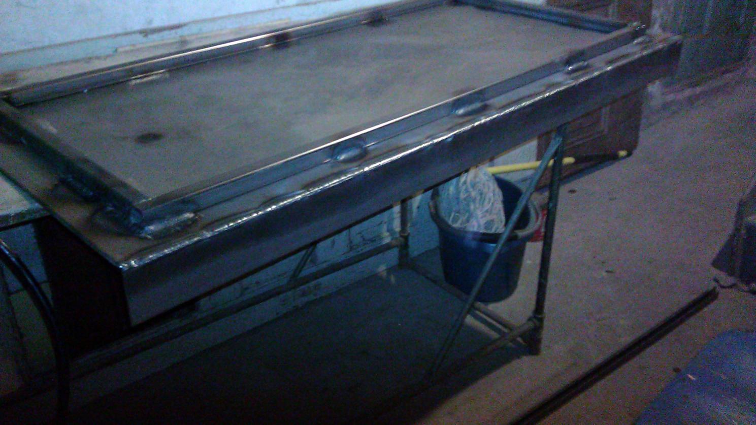

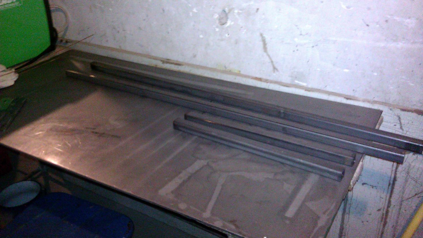

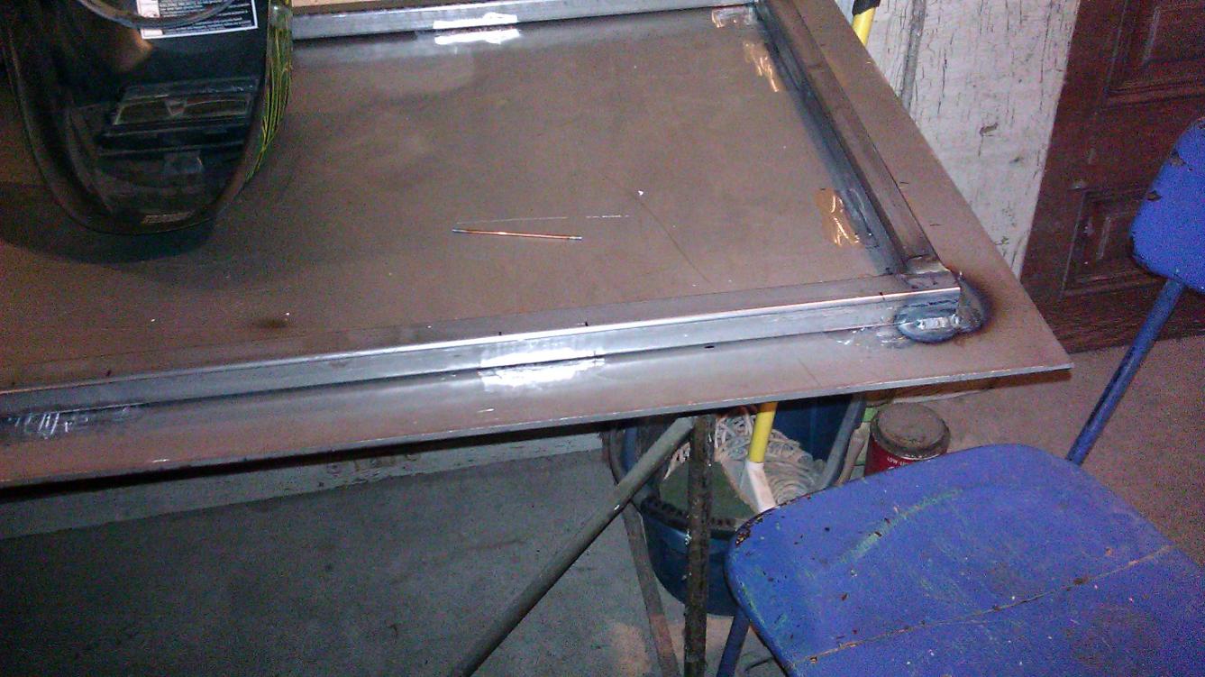

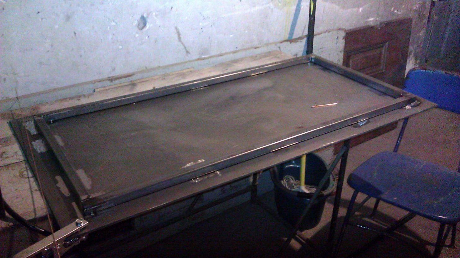

    I wanted to make a table that I can move out from my basement and into the garage, had to be light enough and small enough to carry ip a flight of steps, so this is what I came up with. I picked up a 2ft x 4ft 1/4" plate. I had lying around 1x1 square tubing and a 1/8x4 strip for the back kickup. the photo's are self explanatory. This is my 1st time using the Everlast 200DX other then a few bird turds. Im just using the torch on T2 right now till I get a little better.

    From my calculations, it should be right at about 100 lbs.
    I think your spot on cuz the plate was 80 lbs when I bought it.
