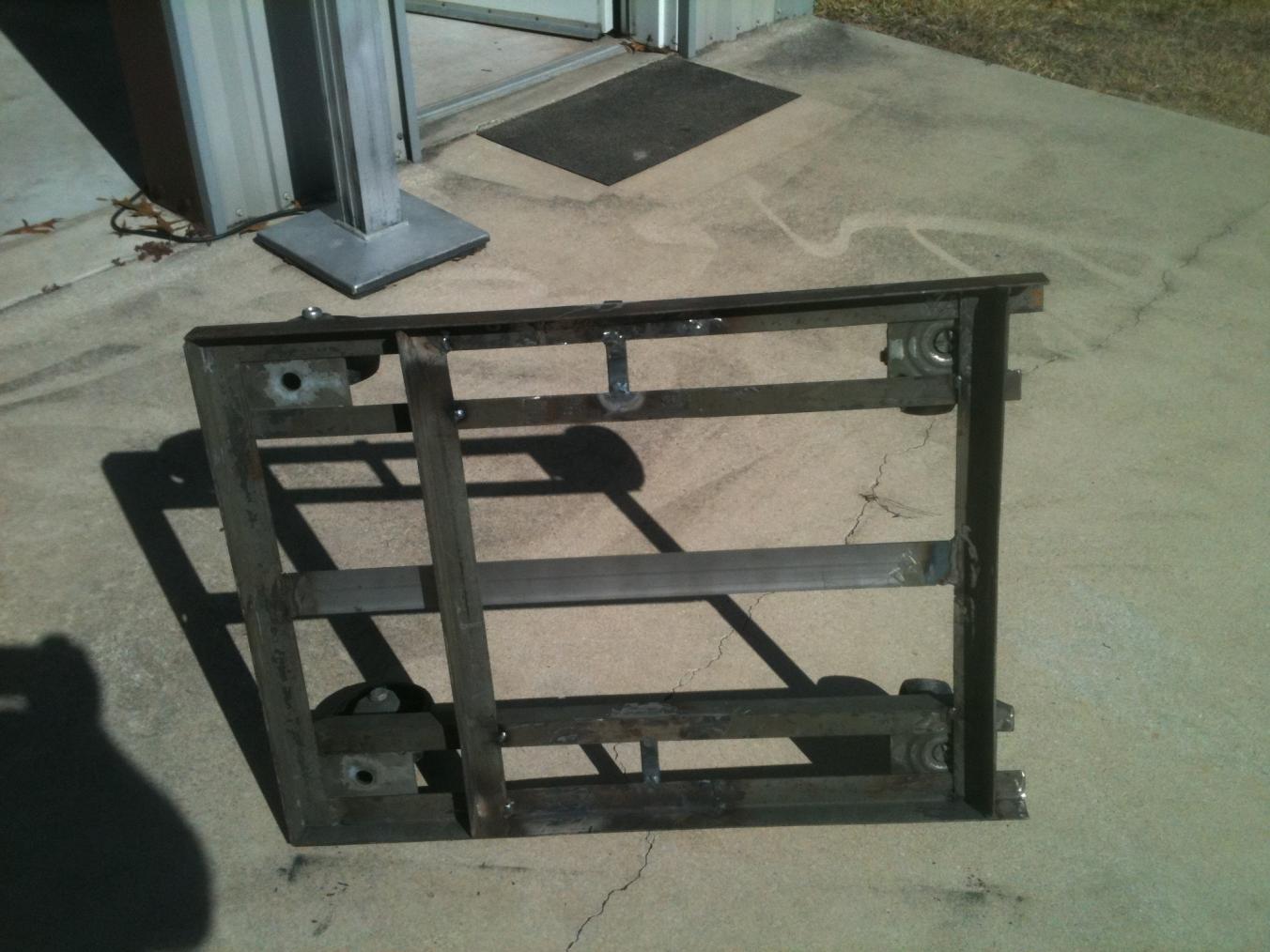

ID:	4591Ok here is project one for me. Ithougt it would be easier to start with a flat dolly that I had what a mistake. No matter how I turned it welder just would not sit right because had two pieces of angle in middle so had to cut off with o/a torch then weld 3/4" square tube braces in middle. Then started to build rack out of 1 1/2'x1/8" square tube for upper shelf and water cooler shelf. So here are some pics will post more as it comes together.

    Here are more pics you can see where I had to remove the two angles from center of dolly and rewelded one further back then add two 3/4" tube braces and 1/8"X2" down center. Frame is mainly 1 1/2" square tube the small square in back is for cooler, welder and hi freq. will sit on bottom shelf and I will put plate and sides on top shelf to hold helmet and tools. More to come.

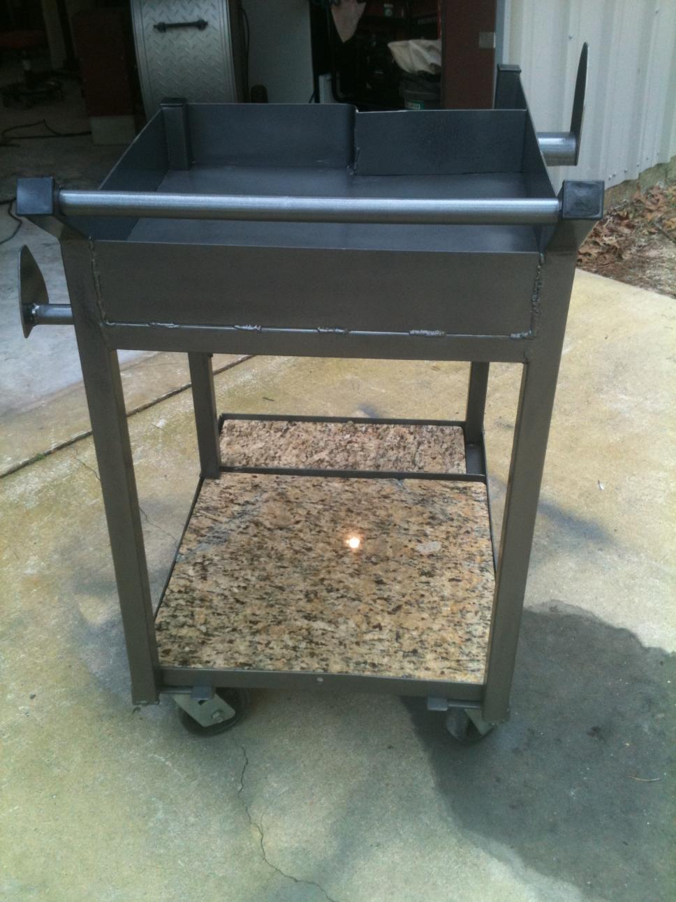

ID:	4834Ok pretty much completed my cart heres some pics. Also threw in pic of shop I built with help of family and good friends. My cart is overbuilt it is a little heavy but it will do.
    Bill
    Looks good, very functional, better to over build than to have a flimsy cart. Shop looks great \, what size is it? If I had a shop like that the first thing Id put in it after 220v and a compressor is a car hoist.
