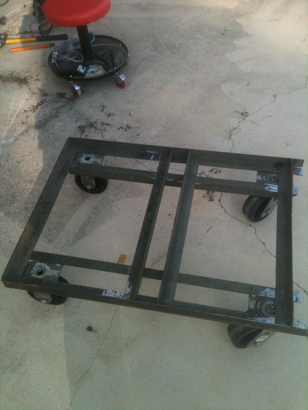

ID:	4591Ok here is project one for me. Ithougt it would be easier to start with a flat dolly that I had what a mistake. No matter how I turned it welder just would not sit right because had two pieces of angle in middle so had to cut off with o/a torch then weld 3/4" square tube braces in middle. Then started to build rack out of 1 1/2'x1/8" square tube for upper shelf and water cooler shelf. So here are some pics will post more as it comes together.

    Here are more pics you can see where I had to remove the two angles from center of dolly and rewelded one further back then add two 3/4" tube braces and 1/8"X2" down center. Frame is mainly 1 1/2" square tube the small square in back is for cooler, welder and hi freq. will sit on bottom shelf and I will put plate and sides on top shelf to hold helmet and tools. More to come.

    No just heavy duty fixed wheel on back and swivels on front. Thought useing flat dolly I had would would make life easier WRONG!!!!!!!!!!!!!!!!!!! Just have to make due for now, think things out little better next time. Still trying to pick up fab. skills. If I can get about half as good as your work I will be very happy. Pratice pratice pratice
