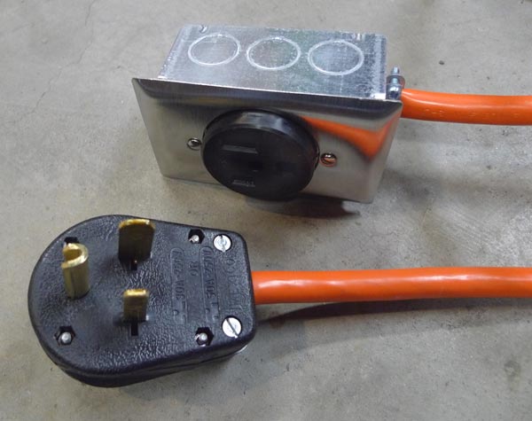

    Earlier (on page 2) I gave a link to an ebay purchase I made of 100' of 10/3 extension cord for 69.99 shipped. Can't beat it at 70cents a foot, and now that I have heat in my shop, it is very flexible. Romex is not to code or recommended for extension cord, but only for in-wall attachment. I cut off the 15amp plug/receptacle from the extension cord and added proper ends for the first 25' one I made. I have plenty left for 'growth'. In my breaker panel I have 6/3 from the 50amp breaker to the wall-mounted welder 6-50R receptacle. Overkill for now, but who knows, I might want an old Lincoln tombstone someday, which requires 50amps. My current welder has max input amps of 32amps. Due to a 60% duty cycle of my current machine, and that extension cords can take duty cycle into consideration versus continuously loaded wiring, 10/3 is more than capable.
    The one issue you may have with 10/3 over a 100' cord is voltage drop. The calculator says that this should be about 12 volts, which could leave you as low as 228V if your utility is at 240V. Just something to keep in mind if you have any problems.

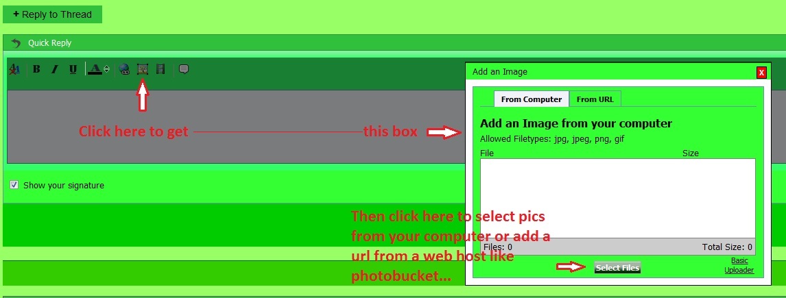

    Ok. How do you post pics here?

    It's best to upload the pics straight fom your computer so they appear as a thumbnail... like this... just mouse over it.
