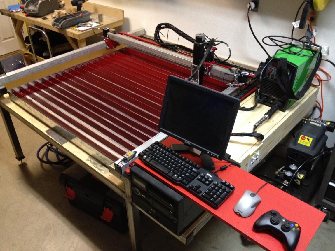

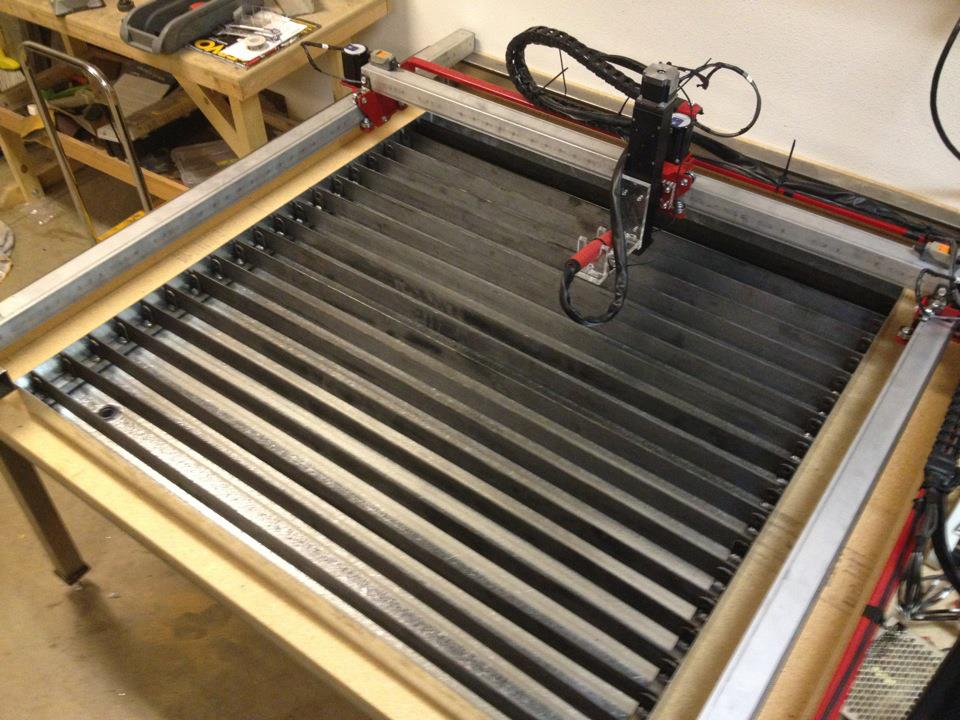

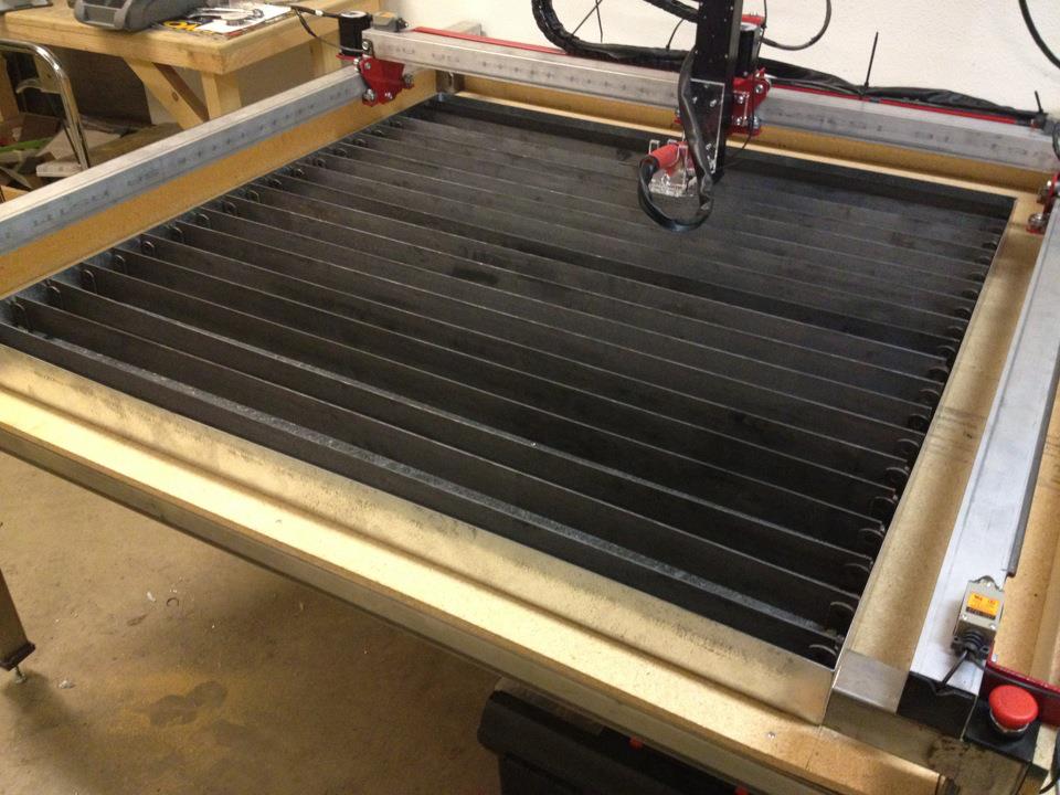

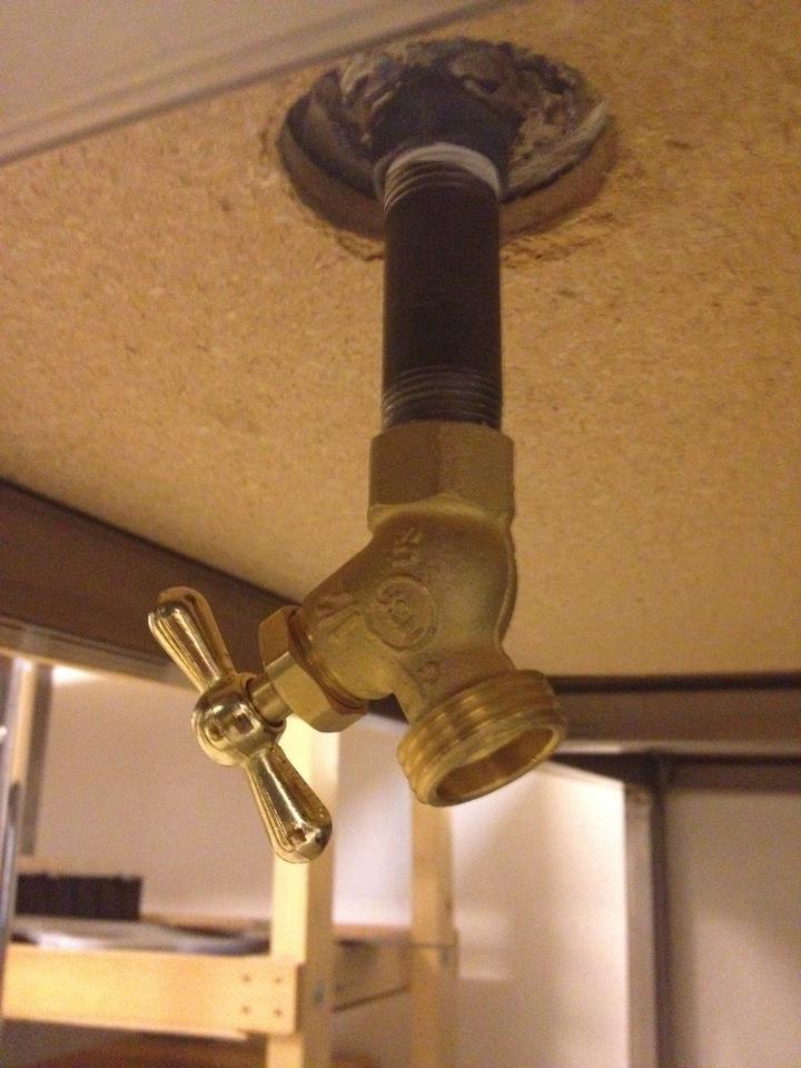

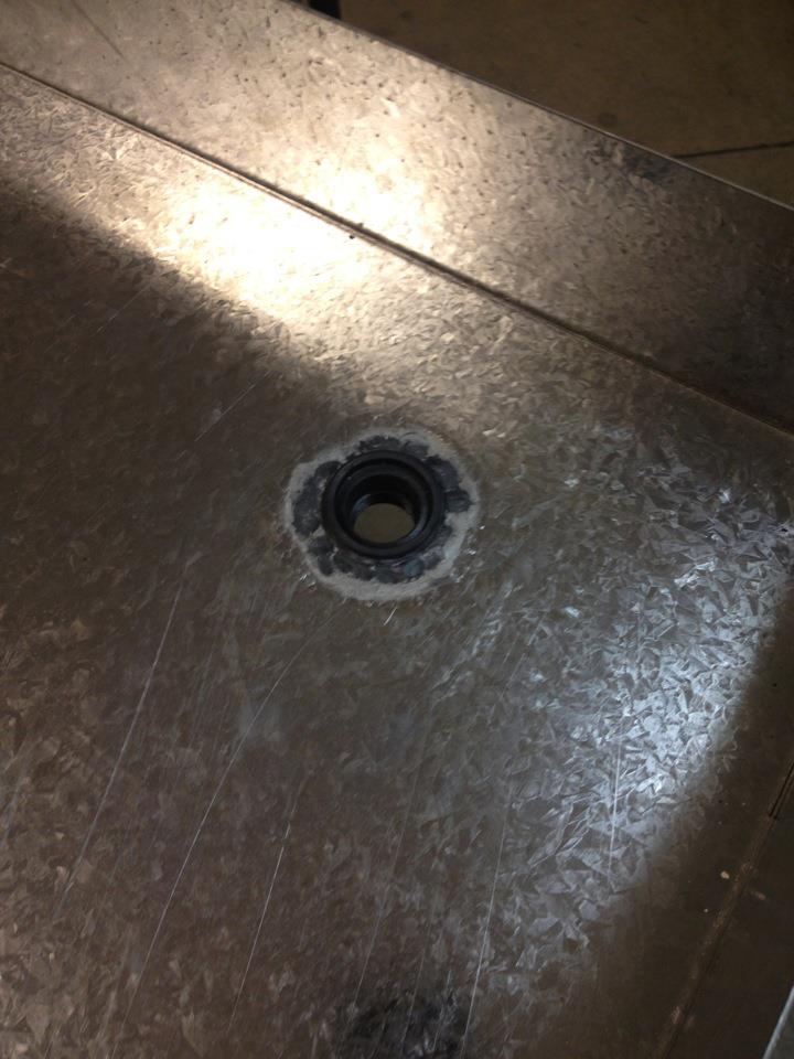

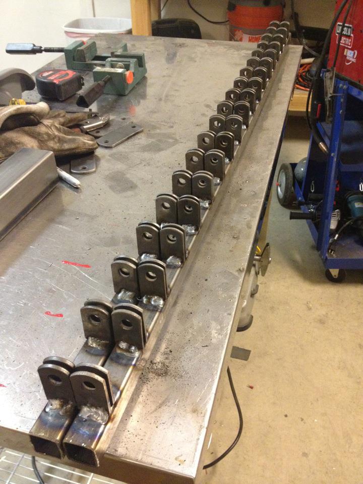

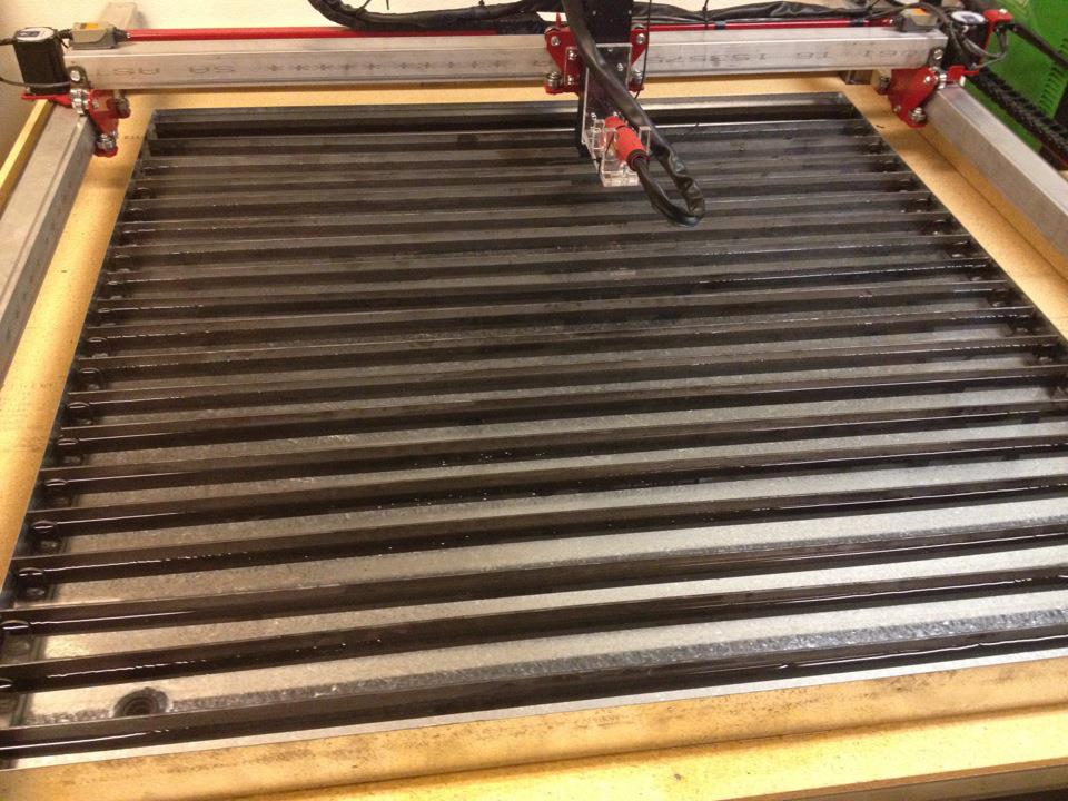

    Yep getting torch heads seems like it might be more difficult than the whole build. But on a good note I finished the waterbed tonight.
    So I finished welding up the racks to hold slates for the waterbed and installed a drain. The pan is 3" deep. The rails are 1" sq tube with 1" welding tabs to hold the slates and then the slates are 2" tall. So they don't touch the bottom of the waterbed and don't get crud in all over them and its cheap to replaced worn out ones.

    Another quick update before i head off to bed.
    So I'm not using anything fancy like THC yet but my everlast power plasma 50 does have a CNC port and I've wired up pin 1+2 to my output #1 on mach3 and it fires just fine. Which means at this point I've finished all the initial goals for this project and I'm onto learning the software. Once I figure out the software and get some good cuts I'll get back to modifying it and adding in THC to the project. http://www.youtube.com/watch?v=dNgLfcWvsyI

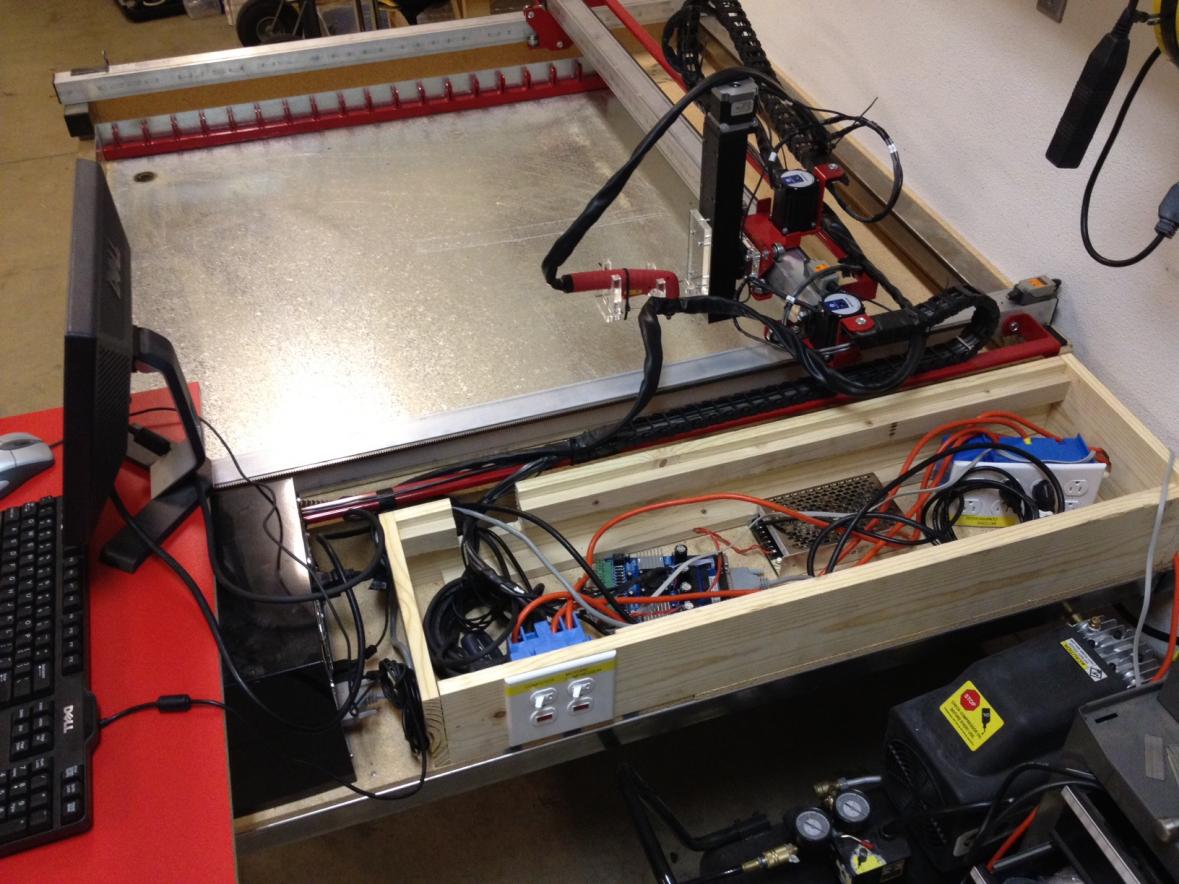

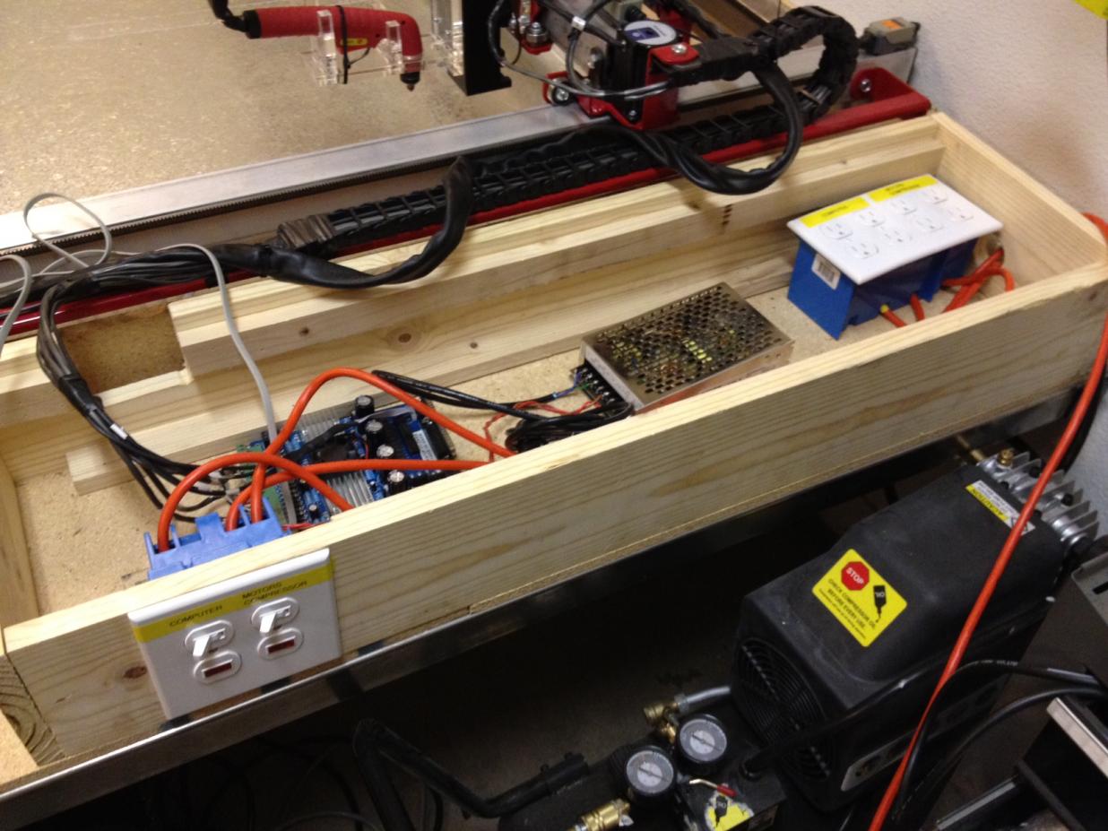

    I'm really close to running my first job on the machine. I've been learning sheetcam and its not bad. I've also been trying out DragonCNC as well and it looks interesting and simple. I've been sick for the week but I had enough energy to work on the electronics box. Basically I just built a wooden box and installed some power switches and outlets to simplify things. 2 switches / 4 plugs each. 1 switch is for the computer side, the other is for compressor and motors. I also painted the slates so they wouldn't rust as fast next time i replace the slates I think i will just go with galvanized.
    But I did run into a problem and I'm looking for advice. It seems that my steppers jerk when they change direction. I have a video showing how it jerks at certain points of drawing a circle. I would love to smooth that out if possible.
