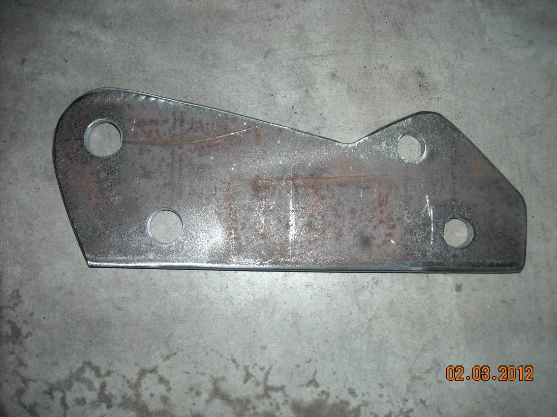

    Quick update: I installed the new Moto Guard M26 filter/dryer, changes the consumables and problem fix. I took your advise and re-wired my shop and now have 2 240v outlets. Everything is working great. Cut my first 1/4 plate bracket.
    I AM NOW IN LOVE WITH PLASMA

    Looks good! Yep, enjoy that plasma! Over all I like the torch you have over the S-45. I like things simple. Thanks for the update. Make sure you keep your duty cycle in mind when you're burning over 30 amps or so, I see you are in AZ, keep it cool
