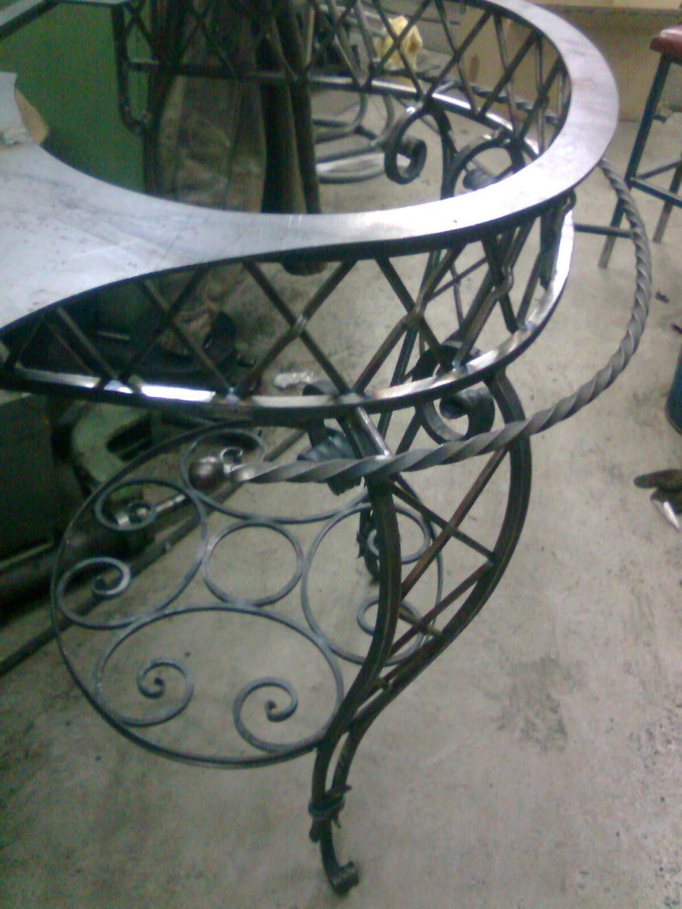

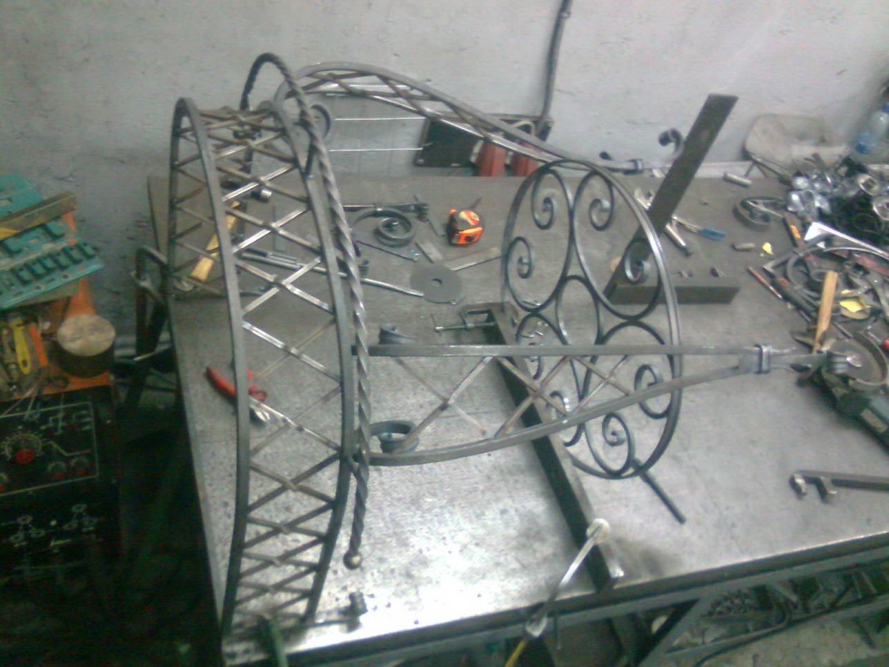

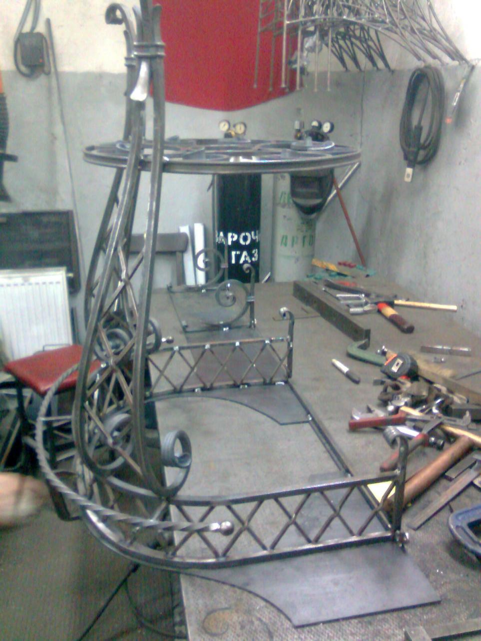

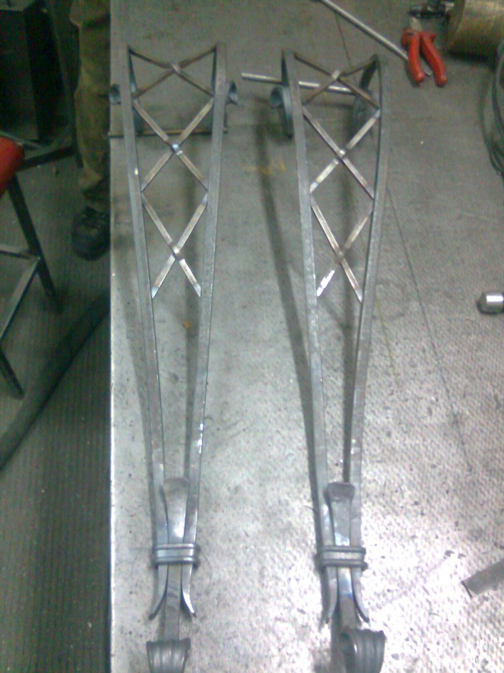

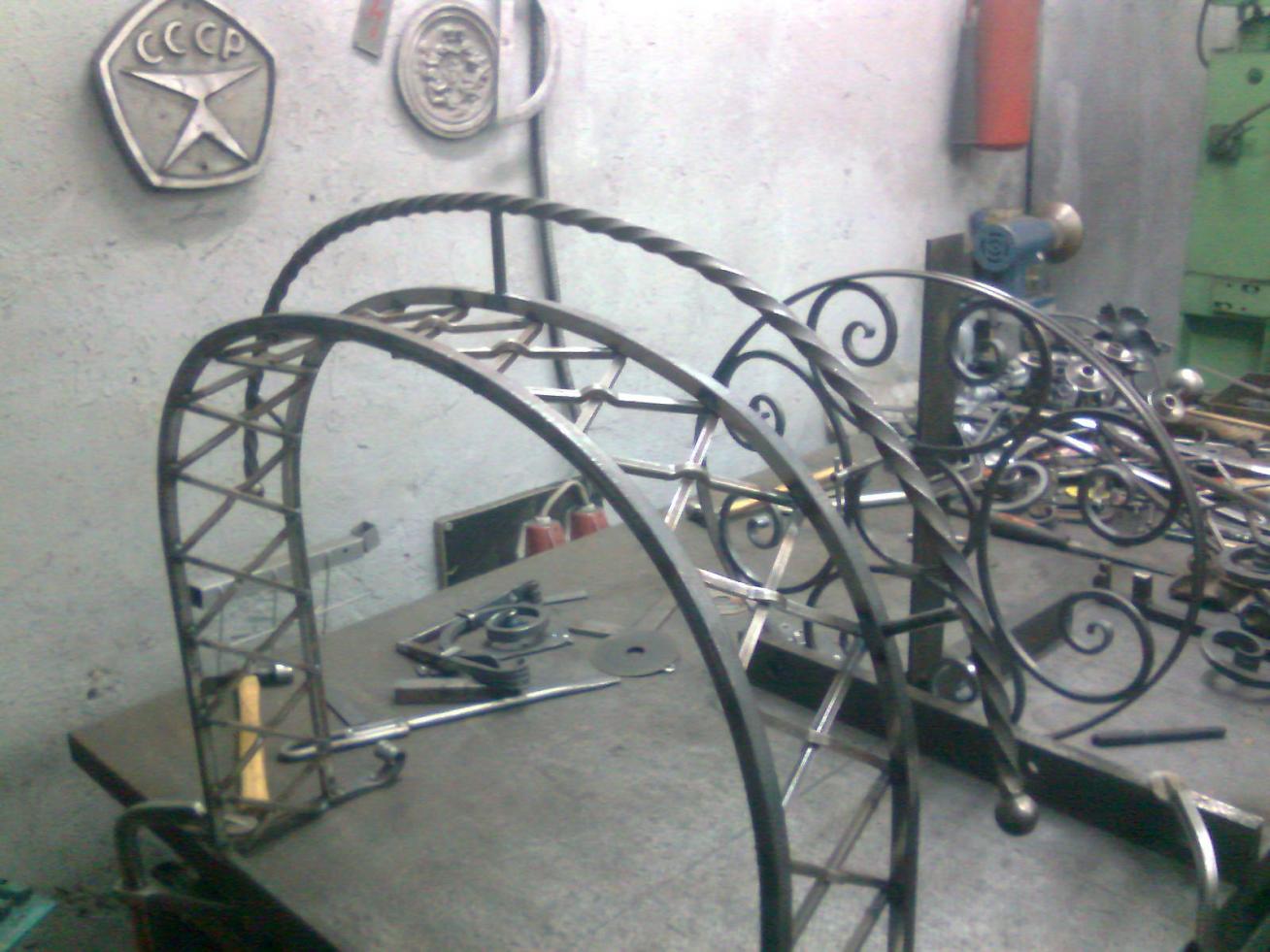

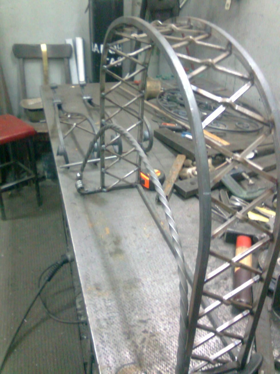

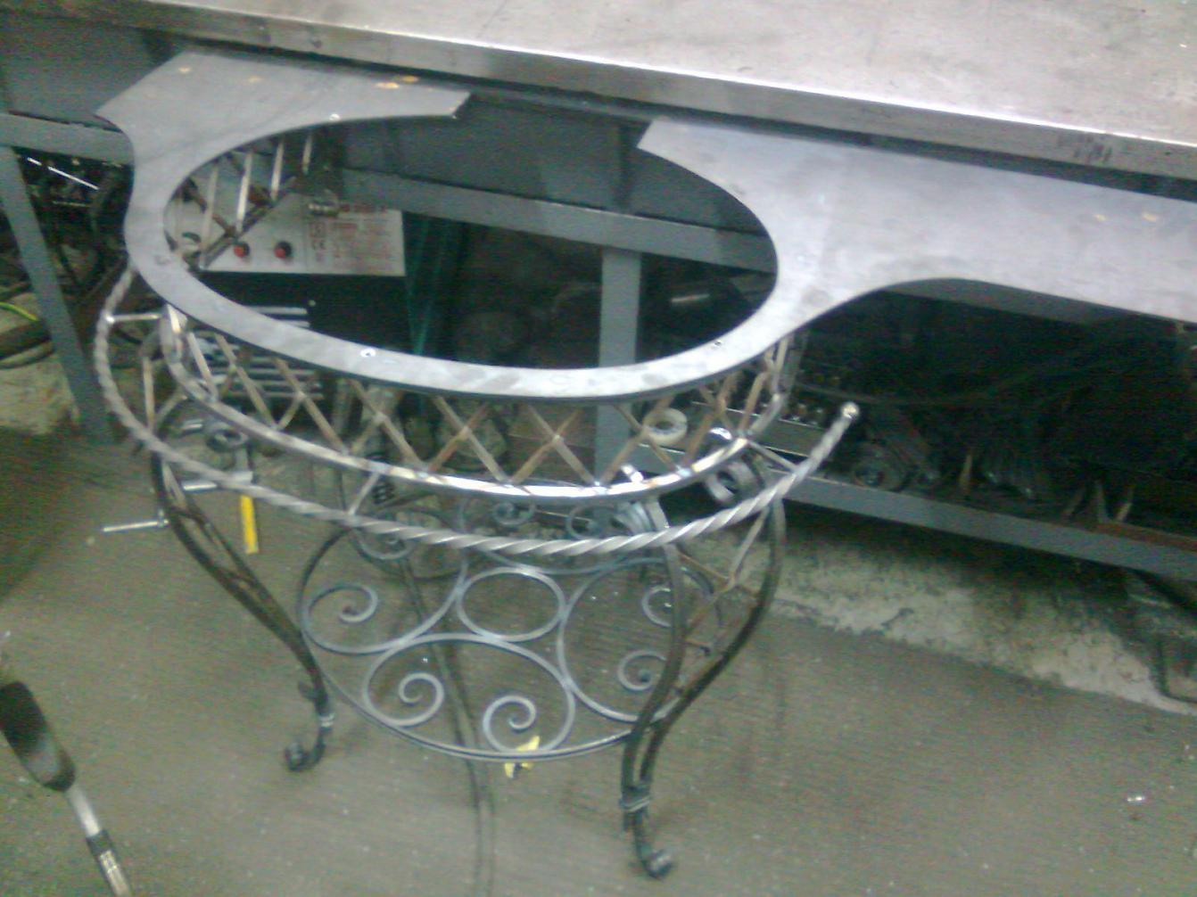

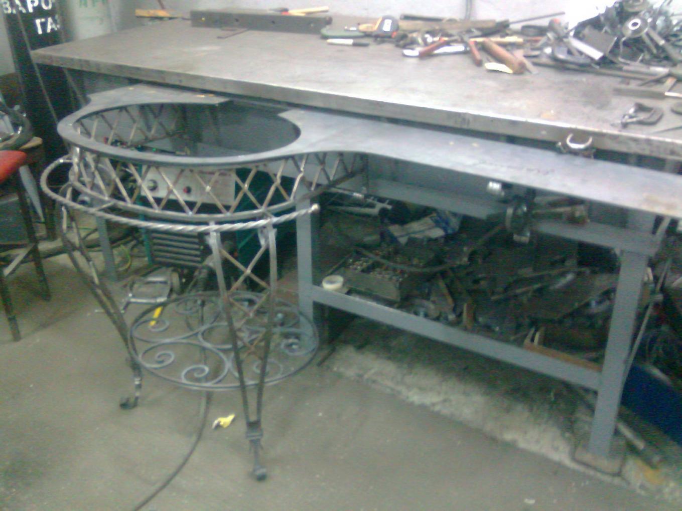

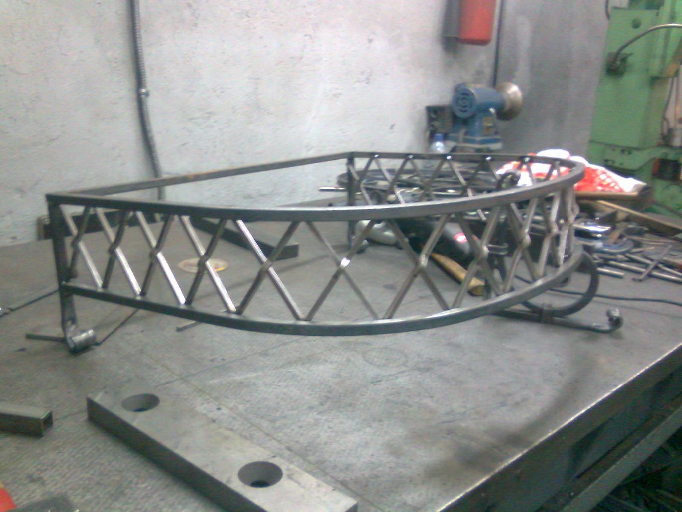

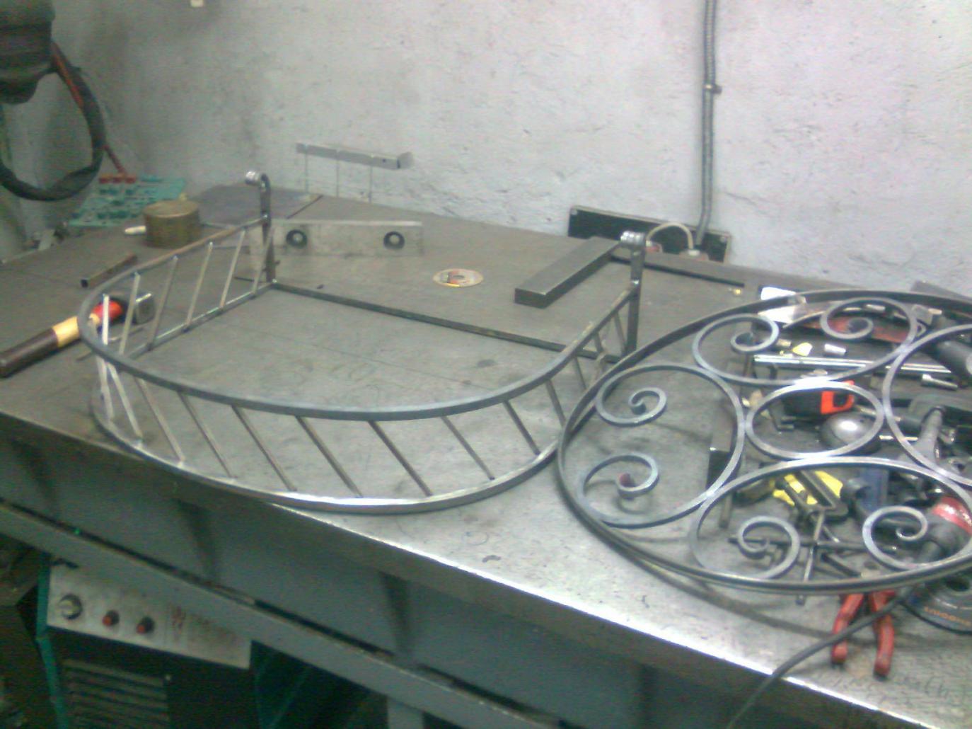

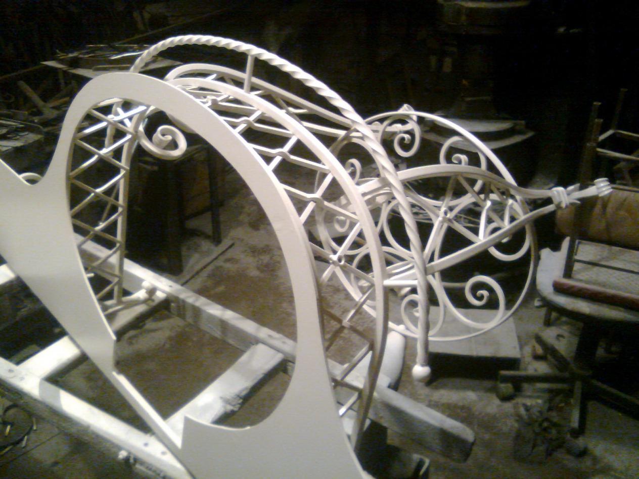

    The forged basis under a stone countertop in bathroom(stepwise assembly)

    Wow that is some project, I have a question how do you get the detail at the end of the scrolls I love the way they look, do you forge them yourself or buy them stamped that way?

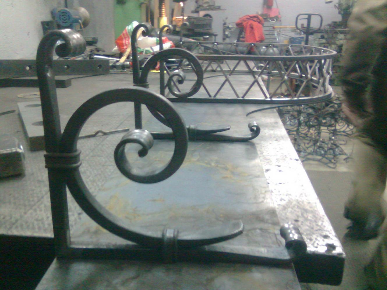

    Quote Originally Posted by Powertig View Post
    in this project all done by hand except for the sheet metal laser cut (all the details that I can not do in the manual I order in a private office "lazerteh").
    regard curls have two options:
    1) manually
    2) Scroll Forms (Quick an easy forming of multiple scrolls).
    This product in interere

    Very impressive! Do you mind describing how you twist the rail around the front? (It looks like a towel rack.) Are you able to put the entire length of square stock into the forge, heat, and twist?
    Dec 2011
    RUSSIA.Sankt Peterburg
    218
    You're right, this rack for towels. First square twists around its axis (without heating)
    and then attach the required bending (without heating)
    by such devices(Scrolling Fork)
    cut to size and welded balls.

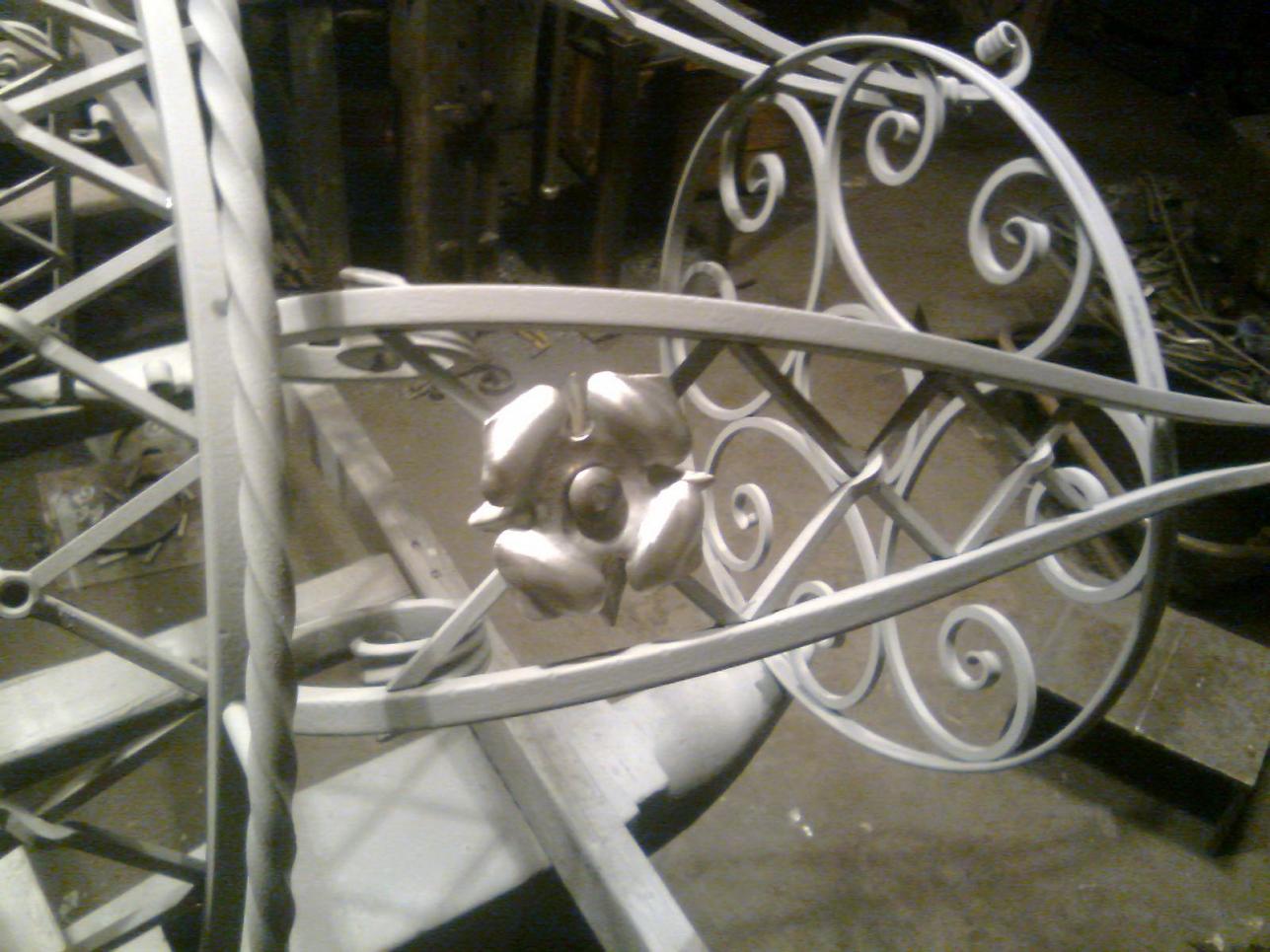

    You are a true artist! How long did it take you from start to finish?
    Dec 2011
    218
    I did this work with the friend and workmate Sergey.
    2 days on the statement of all details with the customer,
    Week of work in a smithy,
    1 day of assemblage, 1 day painted,1 day installation on object.
    Florets has made of aluminium approximately for 2,5 hours
    Here is such sketch has been given by the customer

    Today have established a marble table-top and a bowl.
    Work is made, the customer is happy
