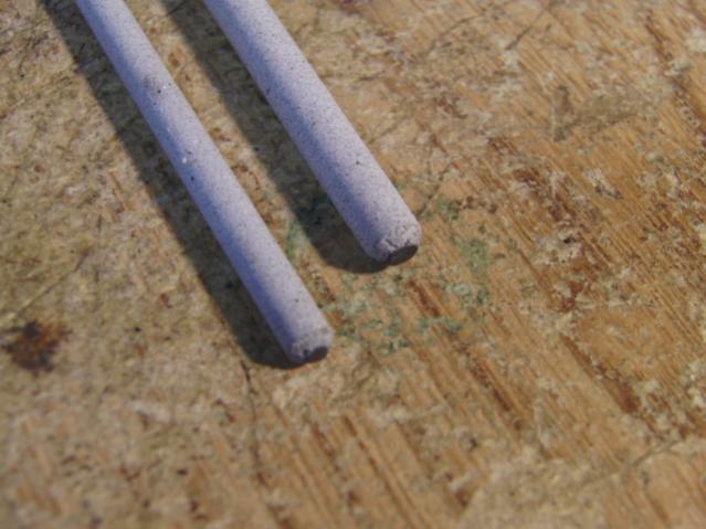

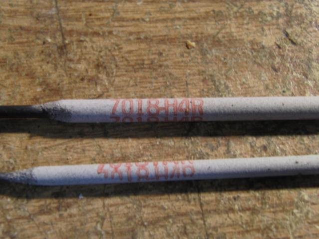

    @ Jerkey. Here are some pictures of the esab rods I use. They dont have the black thing on the tip.
    @ bobwills. I get them from my local welding store. they are about $3.50 a pound. The smallest can they stock is a 10 pound metal can.

    One thing I like about the rods is that there idn't a noticable difference between fresh rods that are kept in an oven and rods that has been sitting out in a tub for who knows how long at the LWS. Thats not to say that the welds the old rods make wont have hydrogen imbrittlement, but its great for practicing.

    so here is the crap esab rod we use. i burned about 75 of these today. out of those 75 most fingernailed during the weld. maybe ten or so the flux just cracked right off the whole rod. they are always kept in a rod oven that is calibrated monthly. basically the whole shop agrees, these rods are cheap crap. also there 3/32" so u dont have to convert

    I gotta wonder if the box had been dropped. It doesn't seem to take much to do some damage to a box of 7018s. Were the rods sealed in a plastic bag? One other thing I notice, although I doubt it makes a difference, is that they have the -1 suffix, which means the welds are more impact resistant.
    Also, by finger-nailing, you mean that a chunk of the flux sticks off the rod and doesn't melt, therefore causing it to long arc and/or arc out the side?

    Its not just this box, we changed to this over a year ago, been through countless boxes, fully sealed, and like i said they go into a rod oven. By fingernailing i mean as you weld the flux cracks off the rod, about a half inch long just above the tip. Its a real pain in the ### and time consuming fixing that. Im just venting as i can probably guess no one else will ever come across this type of rod. And if u do, you will know what i ment in all of this and steer clear of them. Dont know if i mentioned but we did have a box of air liquid blueshield 7018 and they work great. They are kept side by side in the same oven

    PART of the problem is that "boxed" rods, unless sealed in a vacuum packed canister with a pull tab are wet. Holding them in a rod oven does not dry them out properly. You MUST BAKE them at about 600 degrees, or whatever the mfgr suggests to be the proper baking temperature. Just sliding them in the rod oven won't do it. Each rod will react differently if not properly rebaked from brand to brand.
    Those are the "Atom Arc" rods I don't think.
