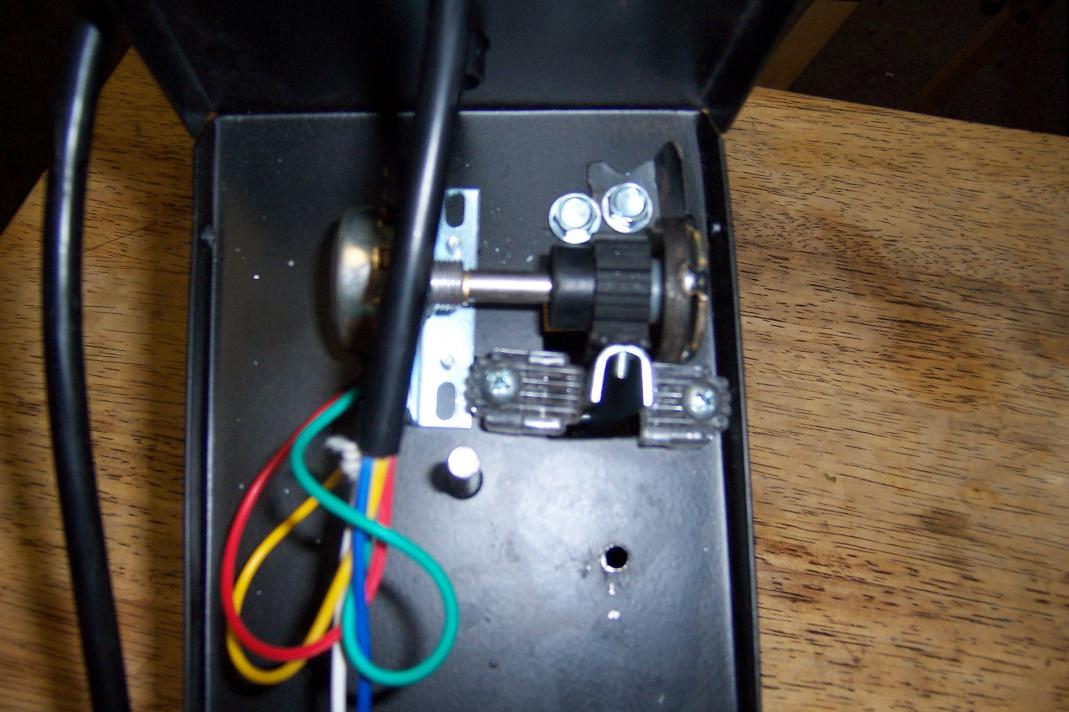

    this mite help . Click image for larger version.
ID:	6161Click image for larger version.
ID:	6162 I did notice pedal unit is sorta cheap built . big problem the cog gear on rheostat is on end of shaft so rheostat not always reads the same since has no support on end of long shaft when i turn the gear with my fingers reads same every time when using pedal it dont and also noticed the micro switch did not work all the time could hear it sticking when pushing on of tab on switch . sorta funny a ford tps switch is a 47 ohm switch just like this but sure made a lot better oh forgot this peddle is for a 250ex tig everlastClick image for larger version.
ID:	6163Click image for larger version.
ID:	6164 some mods i did to my last pedal fixed a lot of problems with it , made a support for rheostat shaft and some guides to keep arm in alignment

    That is a different style pedal than the one I have. On mine it has the pot supported on both sides and the cog gear is turned via a small section of cog belt versus that rack style piece. From your drawings, it appears that both styles of pedals are wired the same though. I didn't get home from work until late so I wasn't able to get anything checked last night. Tonight I should be able to leave at a reasonable time though.

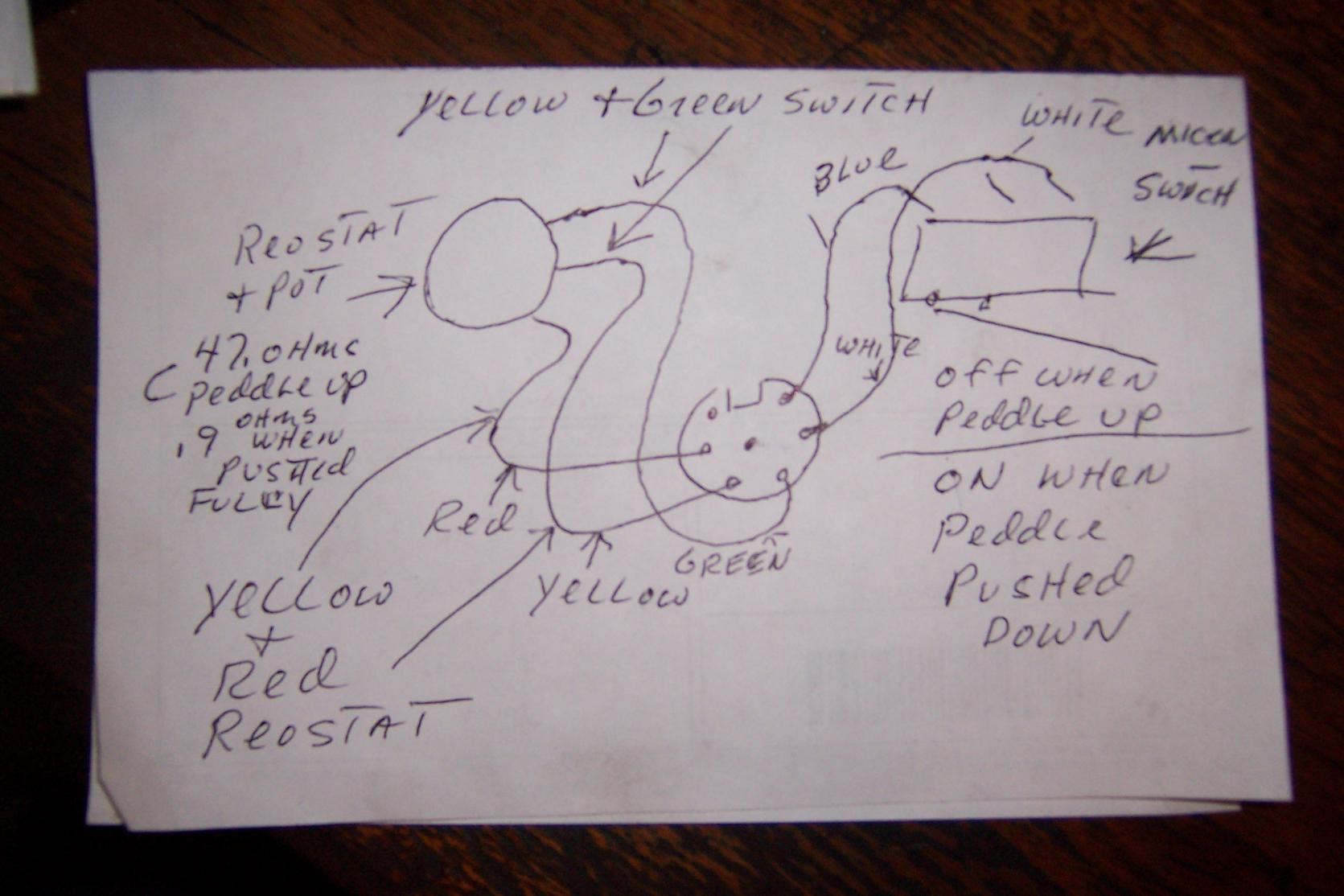

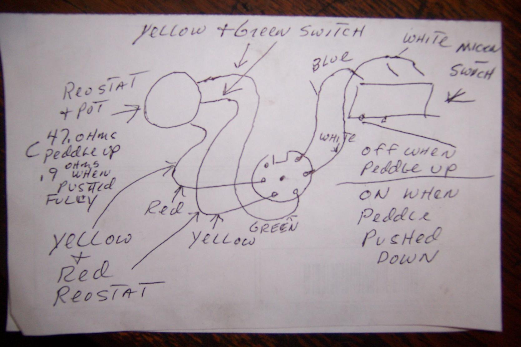

    Not sure if you seen the post above... #23... It is a schematic of the pedal. Not sure how electrically inclined you are. Use a multimeter at the pins on the plug in the picture. (on resistance on a 1x scale) One on the wire from the middle of the pot to one of the other wires. If you hit the wrong "other wire" the resistance values will be the opposite. It would also be good to check both outer wires.
    As you push down on the pedal slowly the meter should swing slowly. (As long as you have a good connection on the pins) it the meter jumps up and down erratically as you move the pedal, that is a sign of dust or a worn potentiometer.
    For the switch just hook the meter's leads to the 2 pins. It should read full scale or nothing depending on switch position.
    Sorry if it seems I was talking down, just not sure if you used a meter before.
    BTW it might be easier to take the pedal apart and use jumper wires with clips to hold the meter's leads to the wires.

    Just to add to the schematic above:
    Pins 1 & 2 are hooked up to the switch. You obviously can test them for continuity by operating the pedal and making sure the switch is operating.
    Pins 3,4 & 5 are the pot. This is where you check the resistance to see if the pot is working. Mine wasn't so unfortunately I don't know what values one should expect.
    Pins 6 & 7 should be shorted together inside the connector. This is what tells the machine to switch over to pedal control. (not sure if this is on all machines or just the machines with the pedal mounted amperage pot)
    JBnID - My gut feeling would be that maybe the timing belt has slipped on the cog pulley for the pot. Have you checked for the maximum and minimum resistance through the pot to see if it matches what you should be seeing. If the pot isn't getting full travel that would limit the amperage just like you are describing. IMO, the stepping of the amperage is a bit weird and not something I would expect out of a slipped pot though.
