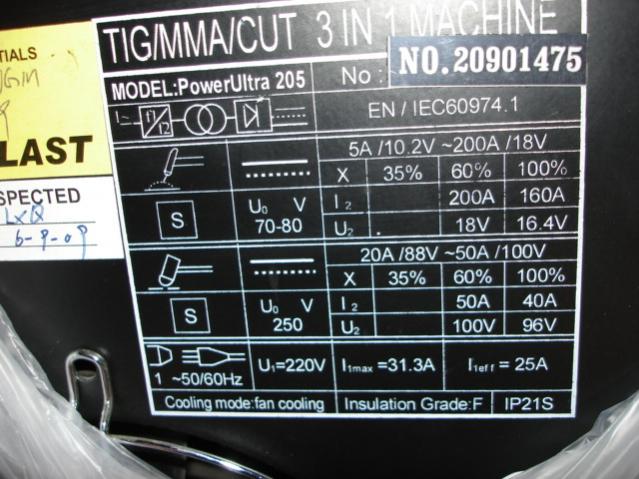

    what are the amps this unit draws from a 220 outlet? could not find the specs in the on-line owners manual. I read the plasma cutter mode draws 25 amps. what about the tig/ arc portion of the machine ?

    I would have to check the plate of unit. However it should not be more than 40 amps when running it at 200 amps.
    You can run it on a 30 amp, just not at full power.
    If you need the number off the spec plate on the back let me know and I take a look.
    Here is the back, 32 amps. Plus or minus an amp. Bottom middle.
