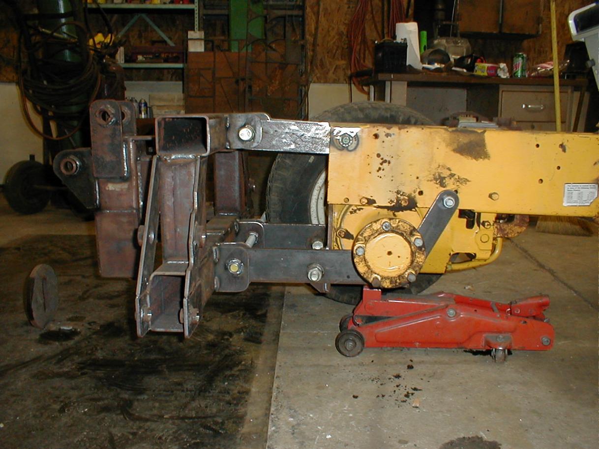

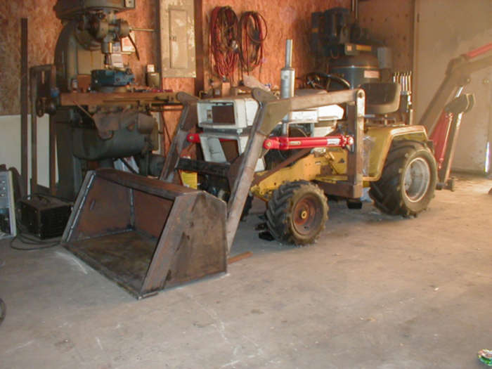

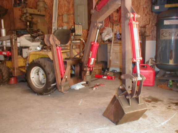

    Here is a few pictures right before It was tore down to get sandblasted and painted.

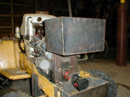

    This pictrues shows the hydraulic tank and shows how I mounted the pump to the front of the motor. I wanted everything to fit under the hood when it was finished.

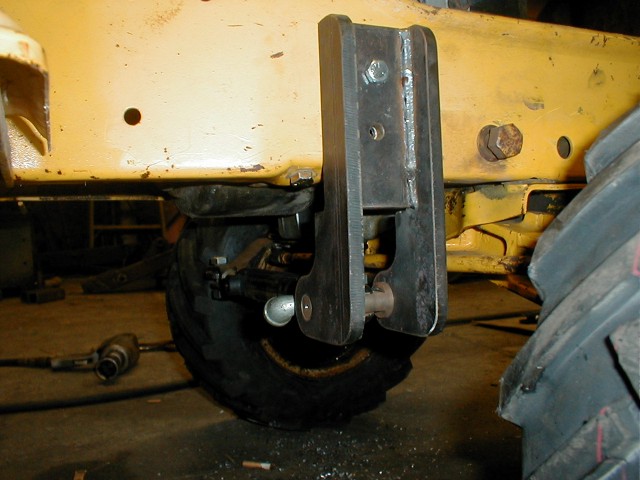

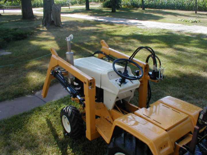

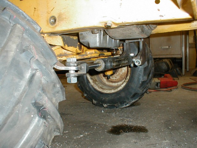

    Here is some pictures on how I did the power steering. I had to add a mount to the frame and modify the original steering bracket.

    This is a picture of the subframe for the backhoe. This attached to the tractor with 8 mounting points.

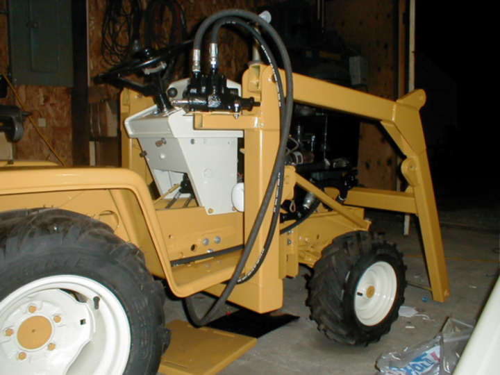

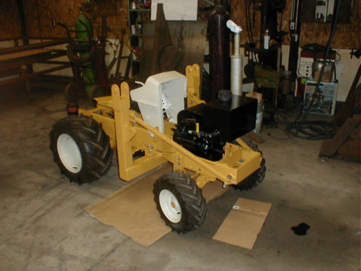

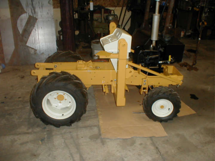

    Here we have some pictures right after everything was sanblasted and painted. One of the biggest challages with this project was to get everything to fit on this tractor and to keep it looking as factory as possable. For example I had to move the motor back 1 3/8" in order to get the hydraulic pump to fit without butchering up the hood bracket. Another challage was getting the power steering to fit and look factory. That was my whole goal with this project was to make a fully functional loader backhoe and have it look like it came from the factory.

    How well does the pump keep up while you are digging? How big is that FEL bucket? It looks quite monstrous compared to the tractor!
    Great work. Did you have another tractor sitting nearby to look at or did you do everything from scratch?
    What size engine is on it?
    It does seem like a fairly light chassis to have all of that on it. Does it dig / lift OK without walking around too much?
    looks nice. Are you going to put teeth on the hoe bucket? What kind of reach and depth are you getting?
    The Bucket is 42" wide and 16" tall. The hoe can dig 5 feet deep and can reach about 8 feet. The engine is a 12 hp kohler and the hydraulic pump puts out 8 gpm at 3,000 psi. I have this regulated back to 1,800 psi. I have added teeth to the backhoe bucket. The pump has no trouble keeping up with the hoe when it is digging.
