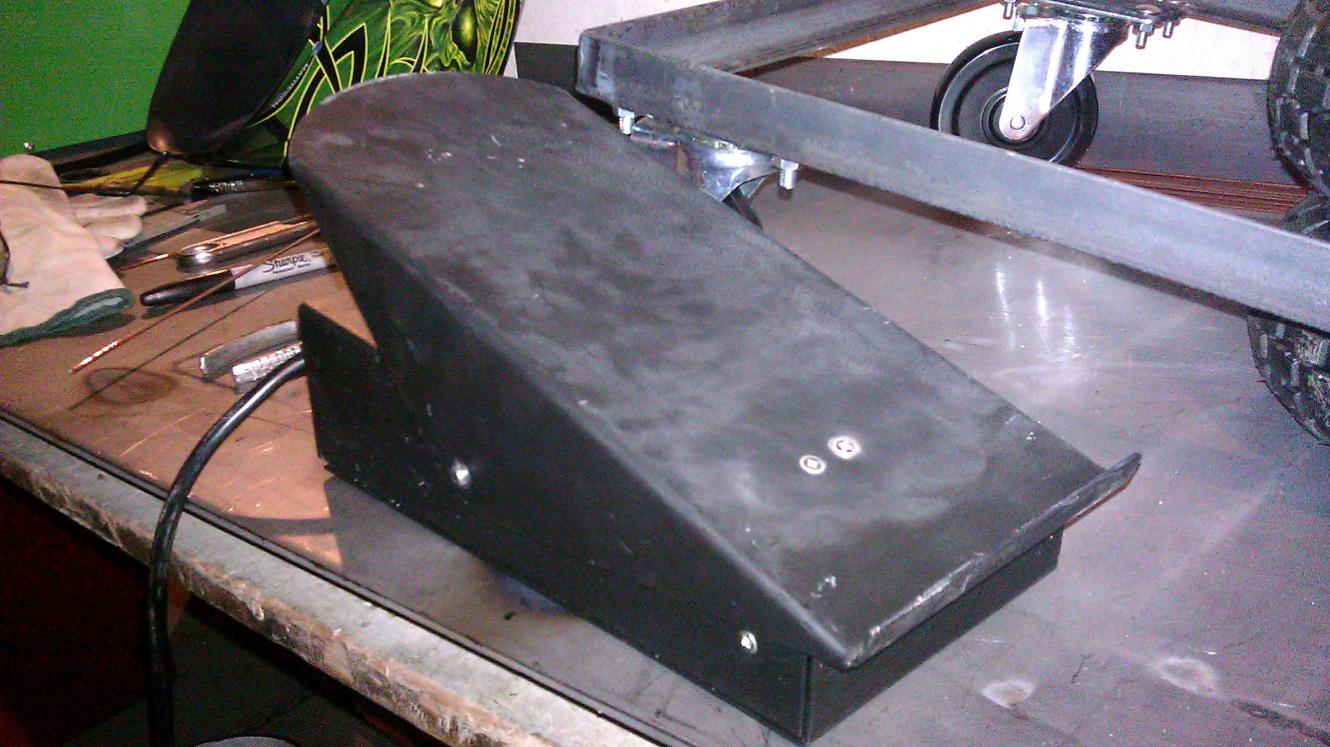

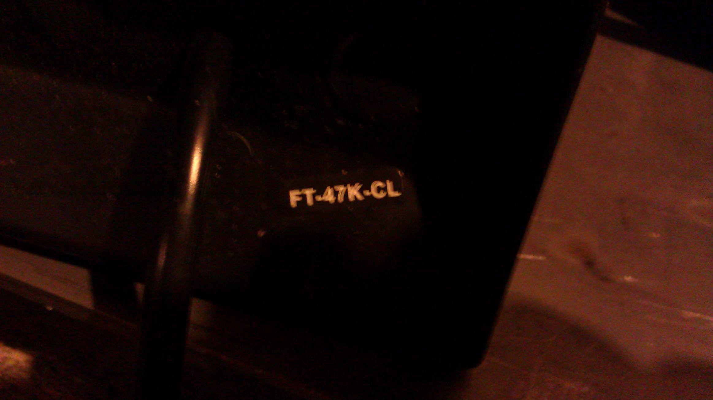

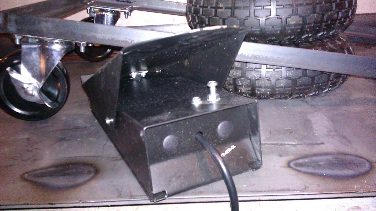

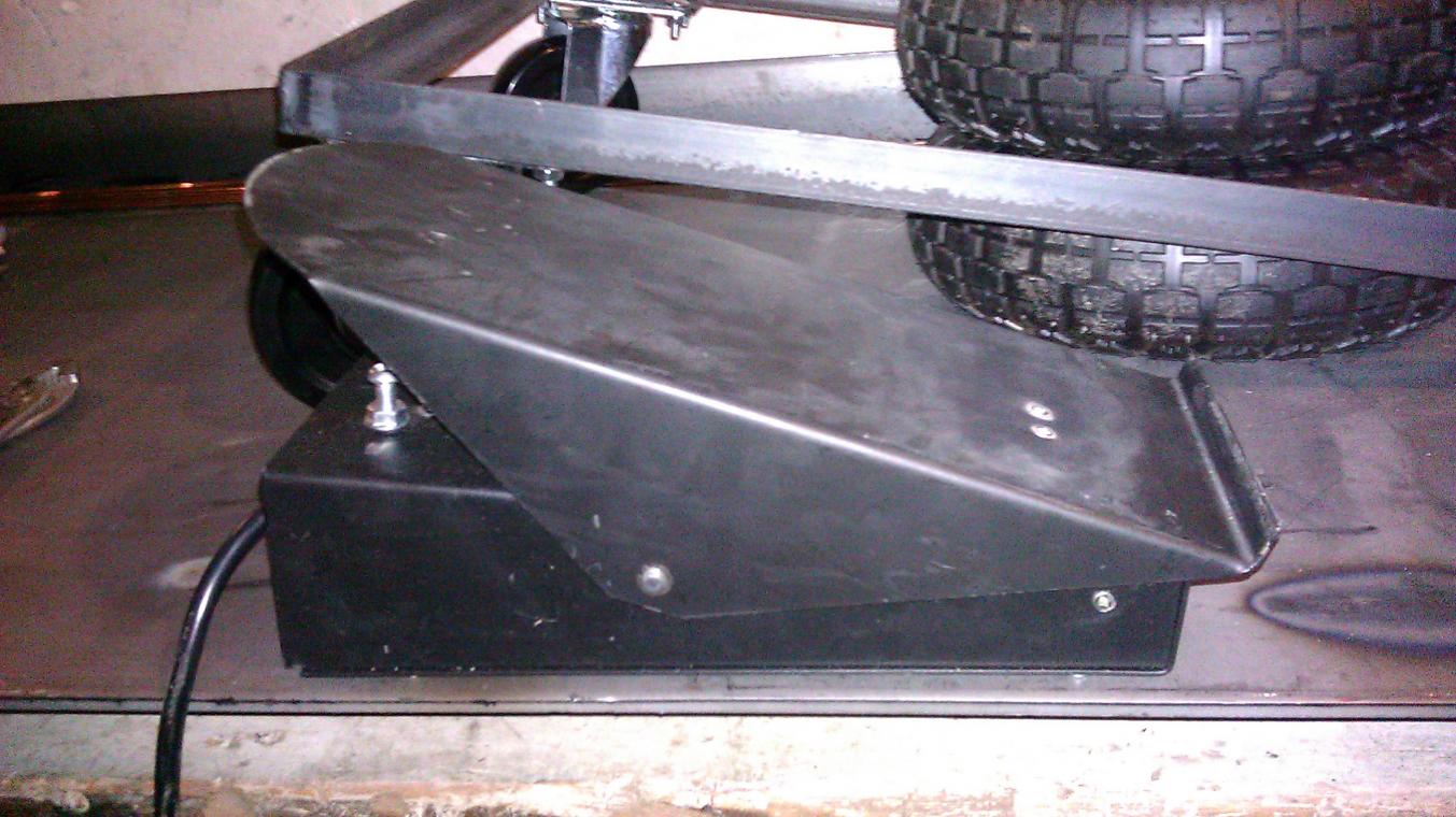

    Here's some pics of my pedal

    My 200DX pedal has a different number on it:
    It looks like you got the 47K pot on yours.

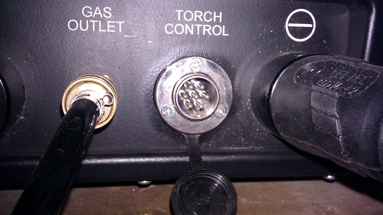

    Pics of my pedal wire connector and the machine itself.

    Whats the difference? Im assuming the pot is the potentiometer

    Externally my pedal looks just like the one that Buzz has but it's got the adjustment pot/knob to the left of the cable. The part number is the same as Joe's (FT-2.2K-CL) so I'm guessing that Joe and I have exactly the same pedal. I took a good look at mine when I first rec'd the unit and made a few resistance measurements. The pot that's operated by the pedal measures about 2.3K ohms at max resistance, close enough to the 2.2K I figure is indicated by the pedal part number. The knob pot measures 48K ohms at max resistance. I looked at the schematic of the "new" pedal in the forum and mine is close except the schematic shows only a single 47K ohm pot. Maybe that's the one Buzz has?
    My pinout looks like:
    1 - 2 = The start switch closure.
    3 - 4 = The pedal pot resistance.
    3 - 5 = The knob pot resistance.
    6 - 7 = Connected together.
    I'd have to take the pedal apart to make sure I've captured all the connections. Perhaps Mark can confirm that the schematic posted on the forum is the FT-47K-CL version that Buzz has and if there is a schematic of the FT-2.2K-CL available?
    I should have some time later today to fire up my 200 DX and make a few more observations of how it operates vs. the one that Buzz has :^)
    It would be quite nice if the only difference between the way our units operate is the pedal but that may be wishful thinking until we get more answers or we dig into things a bit more. Mark we're not trying to drive you crazy with all these detailed questions but you may be dealing with a couple or few perfectionists in this post :^)
    Gary
