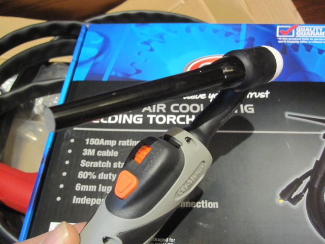

    I will be hooking up a new torch to a number of our units over the next few days, The torch in question will be available for all Everlast Welders and it will simply be a matter of swapping out the switch case that has the variable amp control built in.
    From our point of view this makes for a very simple procedure that we can do before shipping out to ensure our customers have the correct values for the welder they have
    The only question we have at this time is to make sure we have no RF interference with individual units . Once this is done to our satisfaction we will have these in stock .
    As a FYI i am planning on using this torch on both the Micro Dual voltage 185 and a new HF Stick Tig PowerArc 160 unit that is also dual voltage.

    Nice looking addition. I just got my 200 DX and did a few aluminum repairs just using the torch switch. It worked fine but I'd learned with a pedal and there's just something about having that level of control that I like. I've had my old ThermalArc DC tig for a while and built a pedal for it that's great for most work. I haven't used the pedal with my 200 DX yet but I can think about a lot of times when I'd like to have the amperage control where using a pedal isn't practical. Some questions... Will this control be usable with the 200 DX? Since I've already got the unit would it be possible to get just the switch case for my 200 DX? My 200 DX pedal has the knob pot on it. How would this torch control work on it? Would it control amps 0-100% or would the 200 DX front panel amp knob control max amps?
    If it would be available as a retrofit, any idea on the approximate cost?
