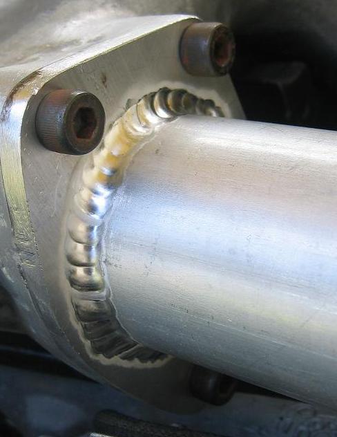

    I think I've got his style figured out. He uses a Helium/Argon mix; which cuts down on the excessive cleaning action of pure Argon, and makes really nice, shiny looking weld beads. Of course he has developed good torch manipulation skill (applying the right torch angle, etc repeatably on every one of the welds in his manifolds), got his machine settings dialed in, etc.
    http://www.everlastgenerators.com/fo...with-He-Ar-mix
    He also sands / "grains" his aluminum stock prior to welding, to give it that "satin brushed" appearance. (In above pictured example, I didn't do that. It just takes some extra time and elbow grease.)
    The consistency of the weld quality throughout his projects is impressive - that takes lots of practice.

    I tried running a mixture of Argon and Helium on my 250 EXT this weekend and found it don't like it at all.. The puddle is completely out of control and the heat runs away at an unreal rate... Now later on I had to figure out why this was happening when I've used it for years on every TIG machine I've ever used without issue.. I came to this conclusion after several attempts to correct the issue..
    What I found is the inverter machines operate so much more on DC-EN that the heat gets out of control even backing off the foot pedal.. I discovered that if I set the machine up at 60 HTZ and around 60-40 on the AC balance like a syncrowave type machine that the Helium was well accepted like any other TIG rig... The good news is the Helium at $90 a 330 bottle isn't required on 95% of anything you will do. Why make a modern welder operate like an outdated machine just to use another bottle of gas? I couldn't find a reason to myself...
    If anyone else had experimented with the Helium mixes as well please post up what you discovered as well.. I always enjoy learning new information that will help me and anyone else I may be helping at some time or another be a better welder..
