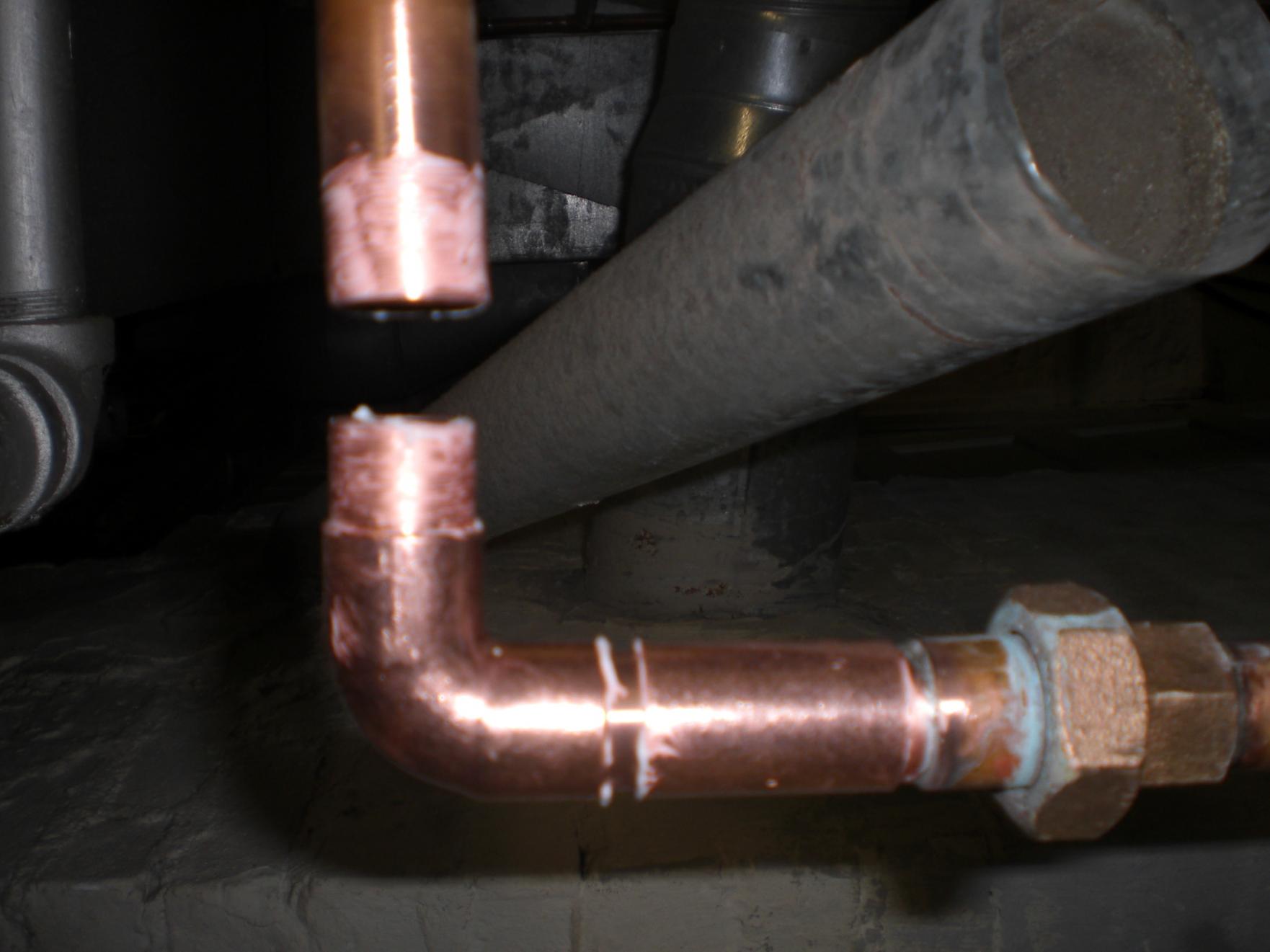

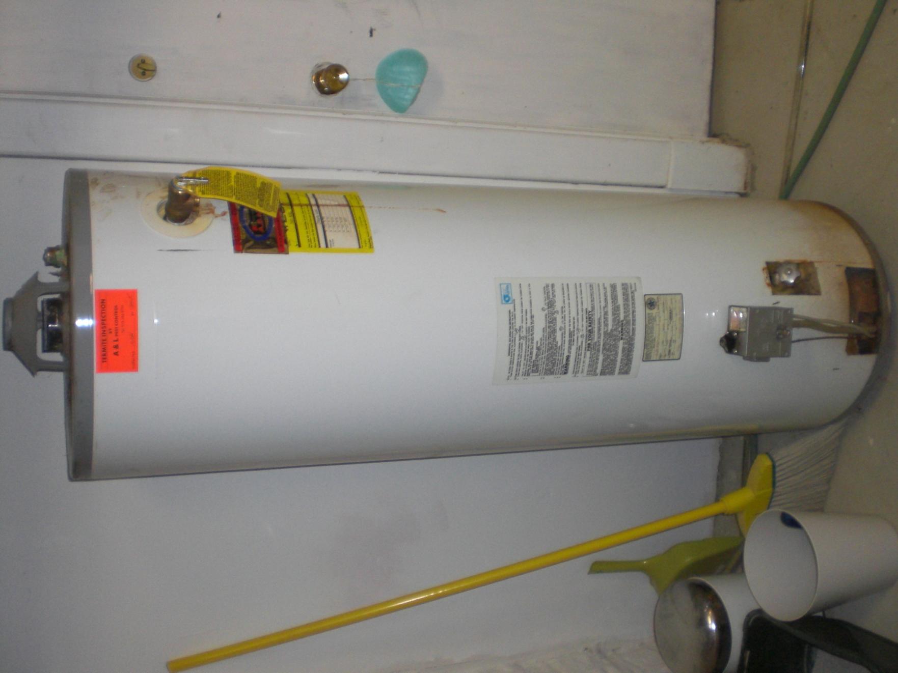

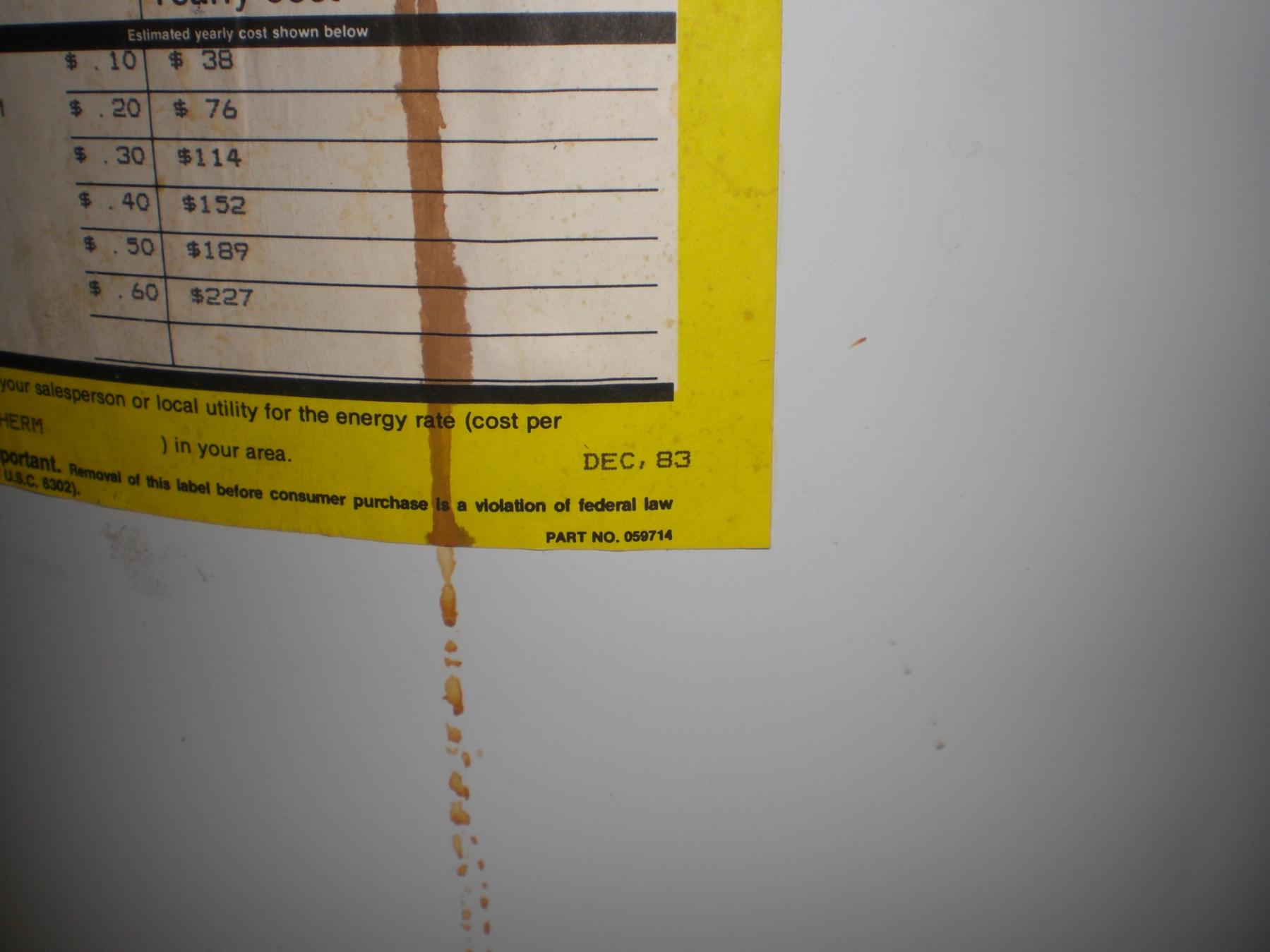

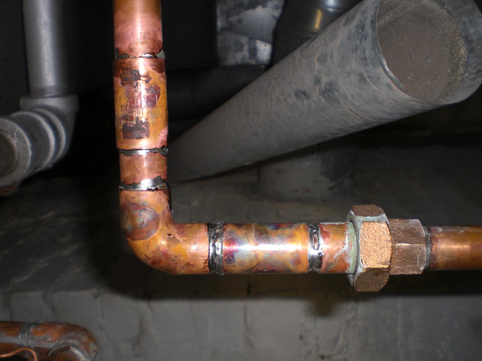

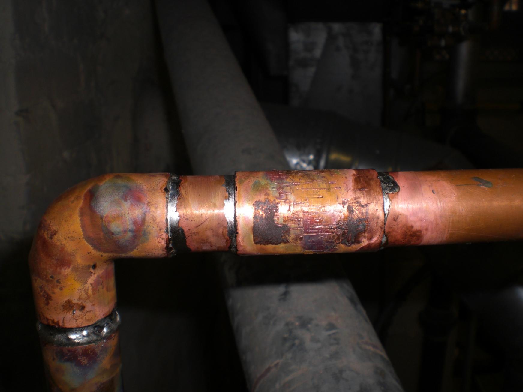

    A gas leak from the water heater control valve results in swapping out the 30 year old water heater and being ready to shower at 11:00 pm. It was not as fun as a welding project but I got to use fire and melt metal so I guess its better than doing taxes... Do yourself a favor and just plan on cutting out the old unions. I broke one loose but twisted the pipe doing it the other one broke a solder joint and I ended up cutting it out anyway. I didn't find the leaking joint until the next day. these are pics of the repair of that leaking joint. Man Copper is expensive. I guess that won't be getting any better so I need to get used to it.

    Had a contracting company for five years or so, so did a lot of connections with old plumbing, wiring, etc. Its a total pain with old copper, often we would just do a joint and run PEX if we could, its easier and more reliable, since you can do loose corners without joints.
    I find soldering on old copper a real challenge - getting it clean, clean, clean makes it work. Its also hard if there is any water left in the lines - you either boil it out, or hope for the best. you can even have issues with soldering a final joint closed and the air pressure from the warming up air inside the line will blow the joint... LOL!
    I usually would do what you did - cut as much of the old crap out of the way if it looks marginal and replace it. You are right though, Copper pipe is very expensive now - which is why PEX and other products like it are so popular!

    Pex would have been a great way to go... I was just in a pinch.. I had delusions of grandeur and swore my next water heater would be a tank less but then reality set in when I saw the wife's face when I told her when she would be able to shower again and she told me how much money was in the account. I will be learning how to use pex for future projects...

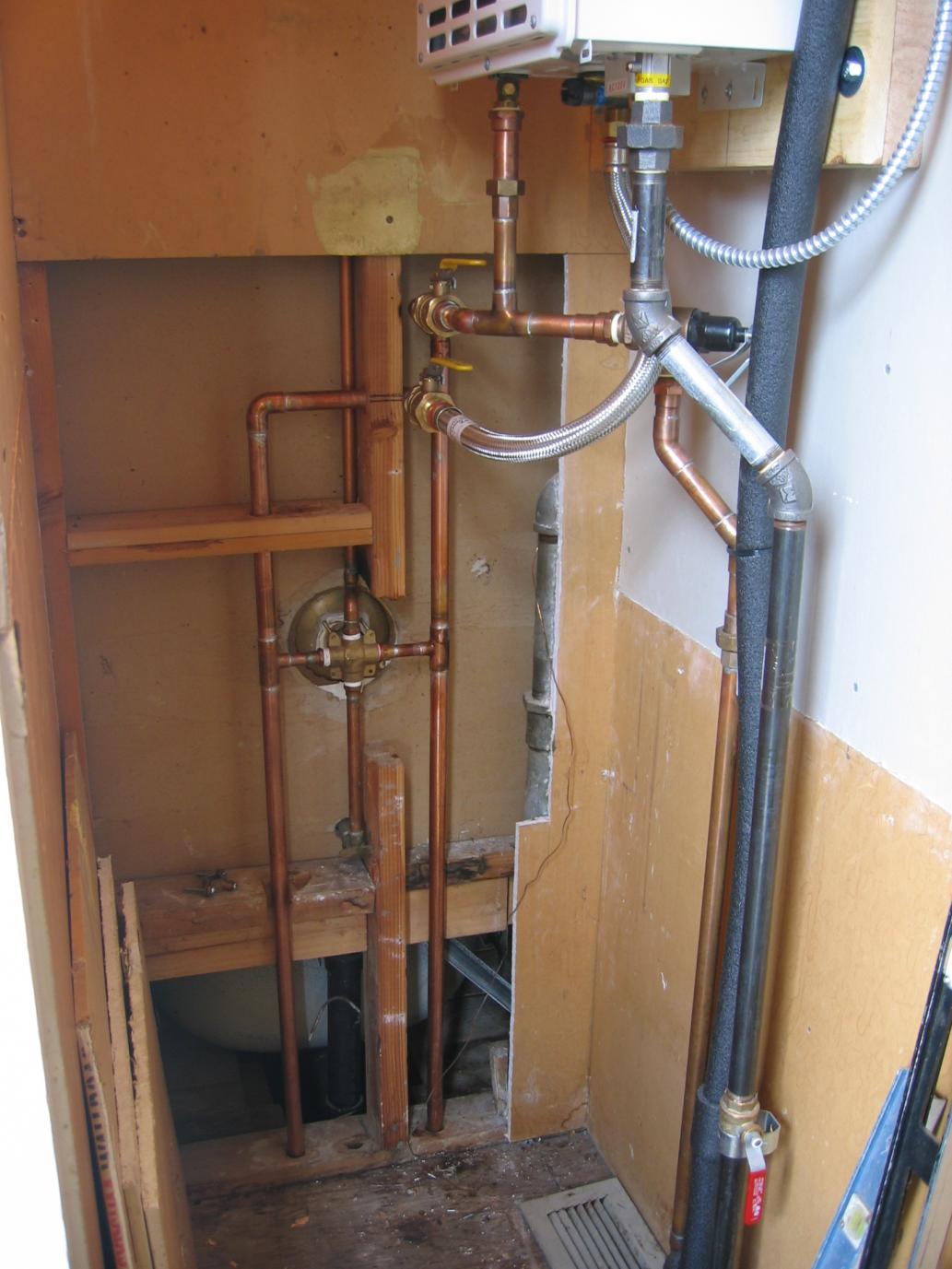

    Here is a tankless water heater I installed at my place a while back, (replacing an undersized 40 gallon tank that could not be enlarged, due to the restricted "closet" space available.

    I also ripped out the galvanized pipe in the wall and in the crawlspace (and actually, even in the ground between the water meter and my home's foundation... that was a pretty deep trench) and replaced with copper.

    Needless to say, the problems with the shower pressure dropping when someone flushes the john (as well as the rust "chunks" clogging up the fixtures, from the ~50 year old galvanized pipe rusting itself away) are gone.
    Actually, I've still got a couple short lengths of galvanized piping behind my kitchen sink (in an exterior wall) that I need to replace with copper... maybe this summer.
