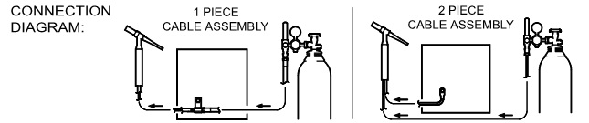

    Why the 2 piece cable ?
    Ha..... I'm glad you asked that question because I thought that I needed a 2-piece. I went back to your original post and realized that you ordered a one-piece. I just thought that there was a typo (N/H 2/1-piece) in your original post. So are the 2-piece set-ups for water?

  18. #38
    I believe two piece cables are use where the welder doesn't have a gas solenoid... the extra hose goes straight to the flow meter or regulator. Click image for larger version.

  19. Default
    That’s where my confusion came from as I thought that the gas flowed thru the dinse connector making it a 1-piece. So I guess that both setups will work but the 1-piece is the way to go. The diagram below is better I think.

  20. #40

    Through dinse = power and gas come from the female dinse connector... in other words, the post on the male side has a hole in the end.
