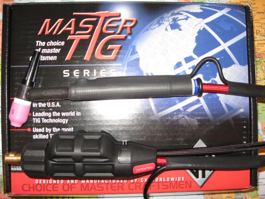

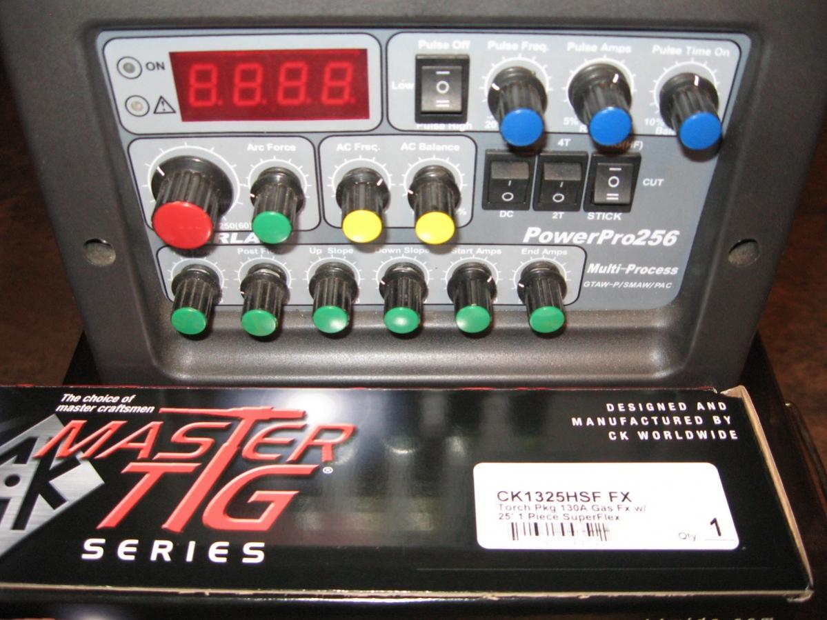

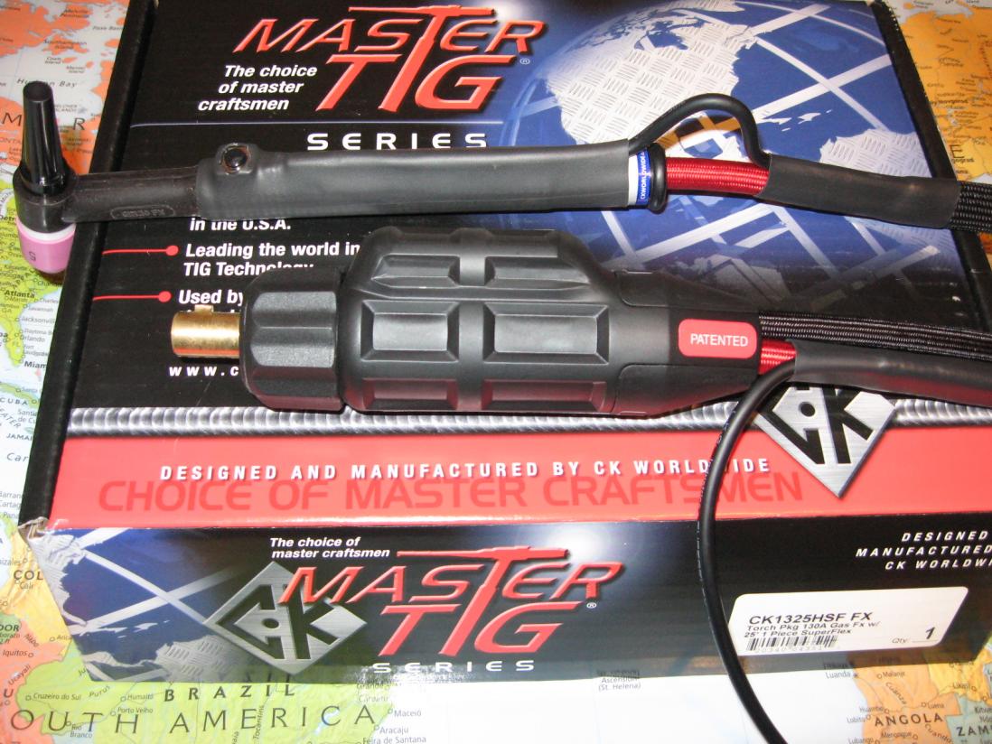

    I wanted a small light gas cooled torch for the PP256 that uses 9/20 size consumables with a lead that I wouldn't have to fight while welding. And here it is...

    130 amp at 100% duty cycle and a 25' lead that's as limp as cooked spaghetti.
Size:  444 Bytes Everlast sells CK now
    1 x CK Worlwide 150 Amp Large Dinse Connector (CK-SL2-35)
    1 x 130Amp Flex Head Torch Pkg W/ 25' 1 Piece SuperFlex Cable (CK1325HSF FX)
    I trimmed the 6 foot black gas hose (comes with the dinse) to 18 inches and pushed an everlast male quick coupling into it and added a piece of heat shrink
    . Thats all.
    This same setup should work on the 250EX and 200DX.

    That looks very nice for doing anything thin/light... especially stainless steel sheetmetal. (I'd recommend a #7-#8 cup on it for that.)
    I have a CK "trimline" 200 amp 100% duty cycle aircooled torch I use for everything, with the one piece superflex hose, flex neck, and it's great. It's like your torch's older brother.

    The black 18" gas hose came off a different torch?
    The black hose was 6 feet long and comes with the dinse connector. I cut it back to 18 inches and pushed the brass male quick coupling into it (from my oem 26 that I'll never use) and added a piece of heatshrink.

    Will this torch work on the 200DX?

    I also have a wp-9f... the difference between it and the ck superflex lead is night and day for flexibility. There's a big difference in the torches also... the wp-9f is rated at 125amp DC @60% duty cycle/80amp AC @60% duty cycle. The CK 130 is rated at 130amp AC or DC @100% duty cycle and only costs a few dollars more.

    I missed your post somehow but yes the same setup will work on the 200dx.
