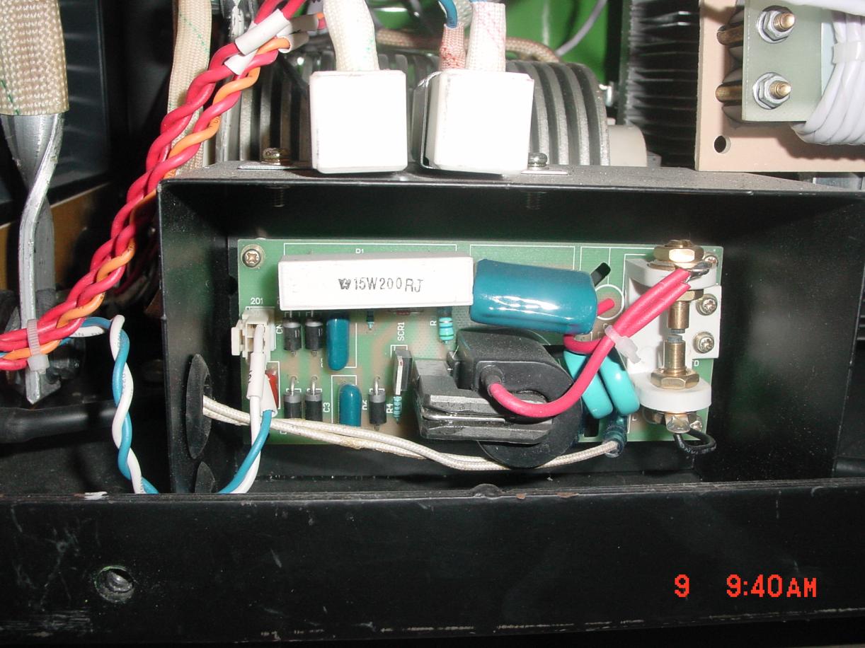

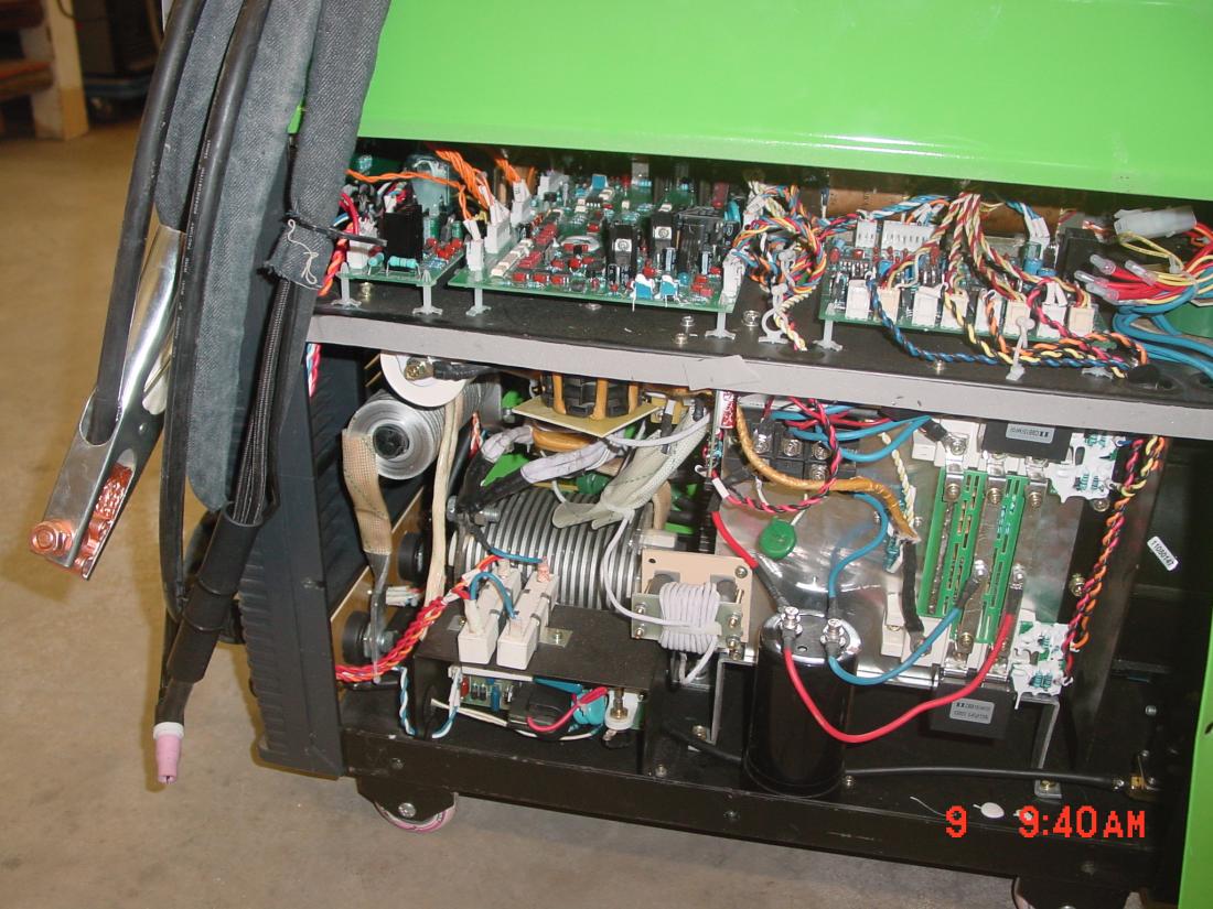

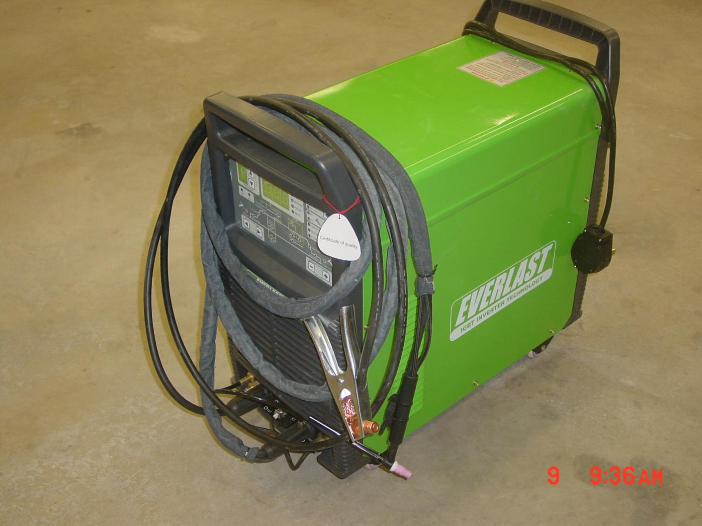

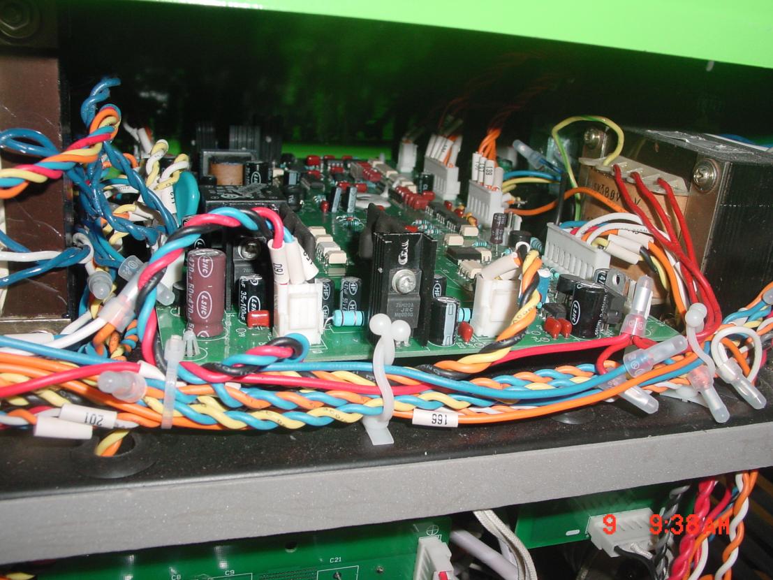

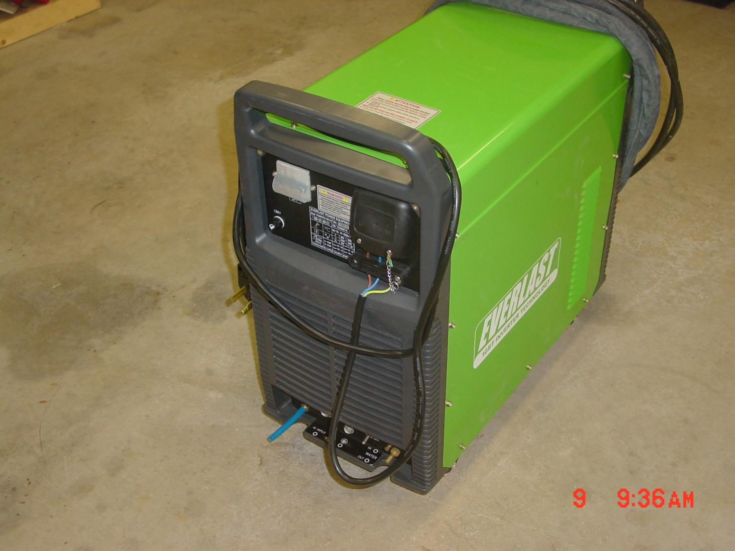

    Thanks for posting the info on your guys 250EXT's, todmorg and DVA!
    One question - how loud is the cooling fan? I've gotta say that's one thing that turned me off about the 250EX. (The fan that is so loud, you can't have a conversation near it without raising your voice.)
    Also, anyone got any pictures of the inside? I'm sure others would love to see what it looks like under the cover as well.
    I'm curious which components are substantially contributing to the 140lb rated weight of this thing... Big transformers? Massive heat sinks? Thick gauge steel frame? All of the above? That mass is coming from somewhere.
    Also, it is really true that if you set the amperage (EP) to the max (250), and also set the AC Bias (EP/EN boost) to the max (+ 30%), that it effectively gives you an EN current output of 325 AMPs? If so, that sounds pretty decent. ...and, I've gotta say I'm pleasantly surprised how it was conservatively marketed as only a 250EXT rather than a 300-325EXT.
    Also, from the specs, it looks *very* power efficient for its class.
    It is a larger unit, but there is no wasted space, it is built very industrial. One of the heat sinks is a solid machined aluminum block 12" high 10" long and 1/2" thick with huge fins hanging off the back. The other heat sink is almost as big. The fan is large, about 10" diameter, it's louder than I would like, but I am used to my silent sycrowave, where the fan only turns on once in a while. The fan is a little louder than the syncrowave when its on, about the same as a millermatic mig and quieter than a hypertherm plasma. With the wind tunnel design, I can see why there is a need for constant air flow, but a 2 speed or variable speed blower would be great for when the unit is sitting idle.

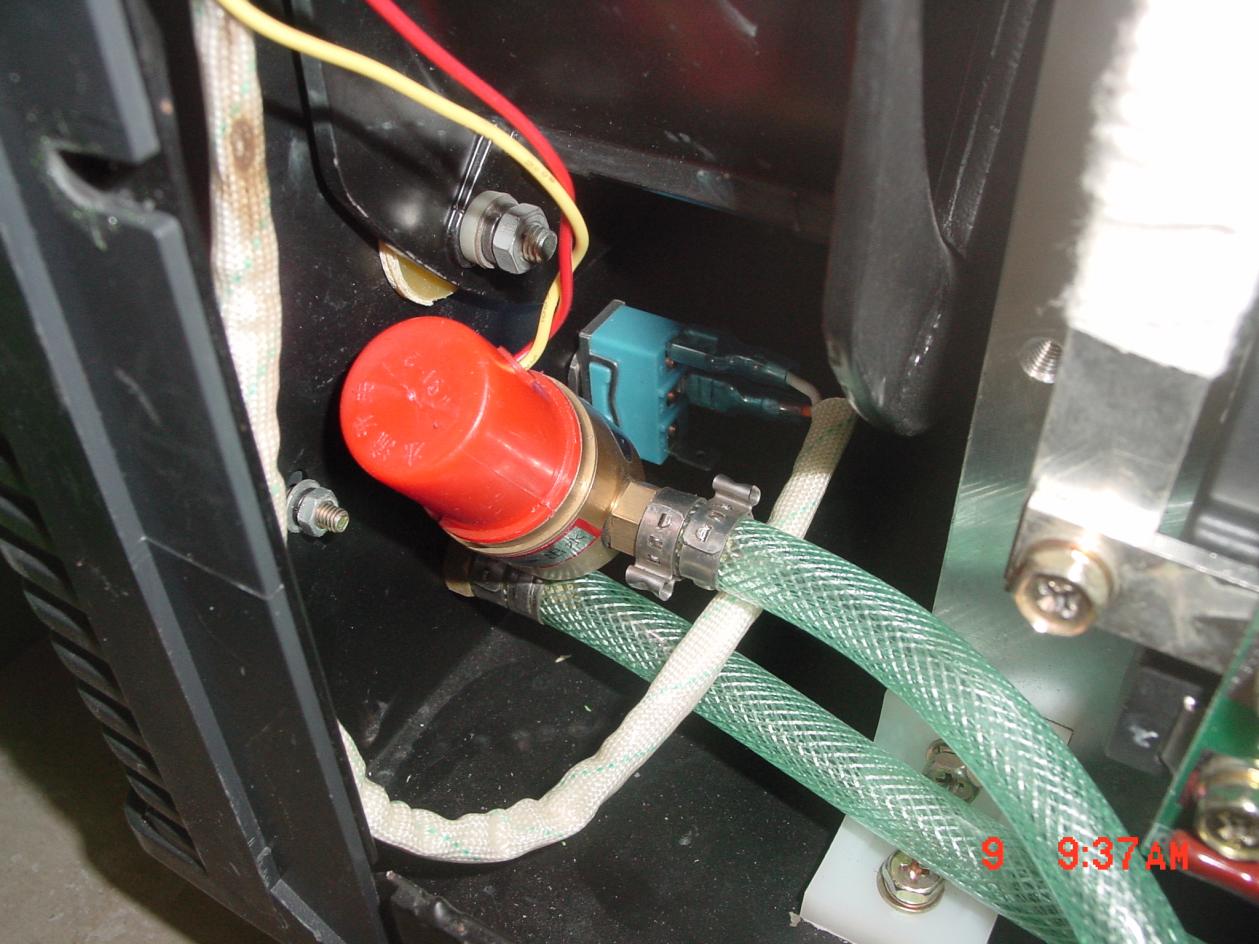

    There is a flow switch in the water line that has me scratching my head, I've only been using the unit with a gas cooled torch until my cooler arrives, but I am curious to the function of the flow control, it must be some sort of torch protection.
    The cover is a neat 3 piece design, any one panel can be removed while leaving the others.
    Here's a bunch of pics -

    The water switch should switch open up when the power is fired to the torch. I think Miller used to have a similar setup. However for the future this should be completely eliminated. This is for an "on demand" water cooler, or for a loss type cooling circuit.
    NOW as for the orange tubing, it is for use with an argon regulator. The tubing slides over the rear hose barb fitting, and the brass fitting screws to the base of the regulator. This helps prevent that "burst" that we see sometimes with the softer tubing. It is something they threw in. I do believe from the looks of it, when you receive your regulators, that this will fit up to the base of ours.
