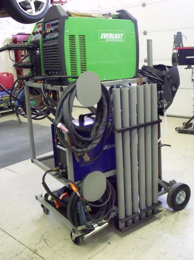

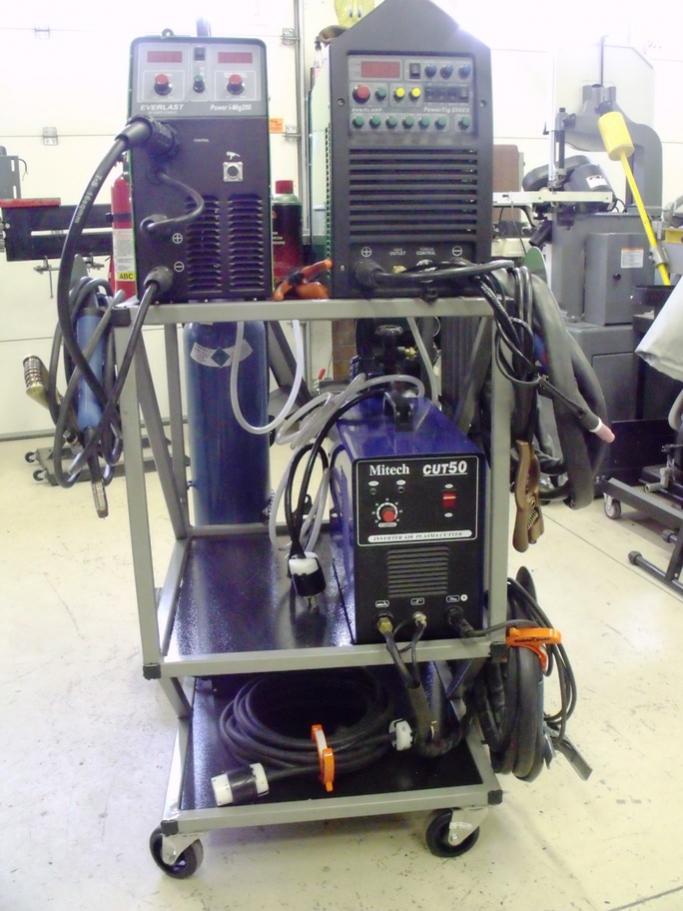

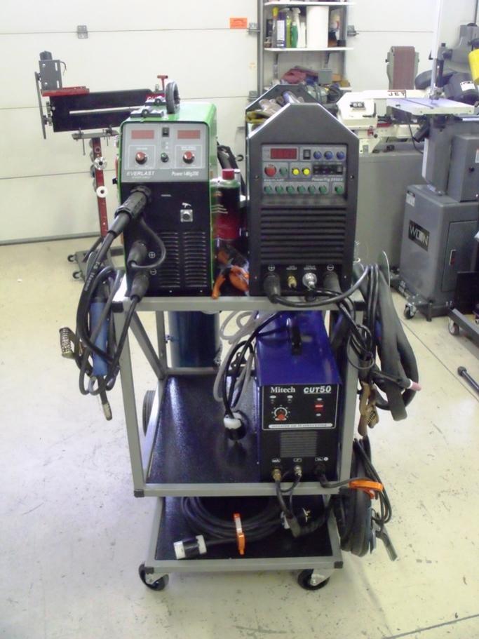

    Default Here is one I built
    It holds my mig, tig, plasma and cooler More like a welding condo
    I have since added the DIY cooler and now have a 205 mig on a riser I build in place of the 200 in the pic. I also have larger tanks now.
    I can give you the measurements if you like.

    Nice cart I am getting ready to build one and I really like you design what gauge 1x1 tube did you use and what gauge sheet steel did you use for shelf is there cross bracing under the shelf? I have to get by with my encotig which weighs about 200 lbs. while I save my pennies for my 250ex or ext, your design looks like it will be perfect for putting my tig on second shelf and my hf251d-1 and cooler and plasma on top shelf any tips would be apprectated. Thanks Bill Nice SS in background.
    Bill
    Bill

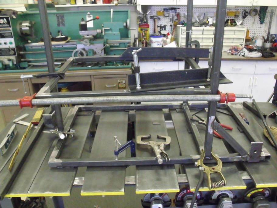

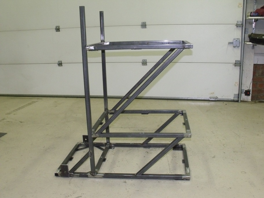

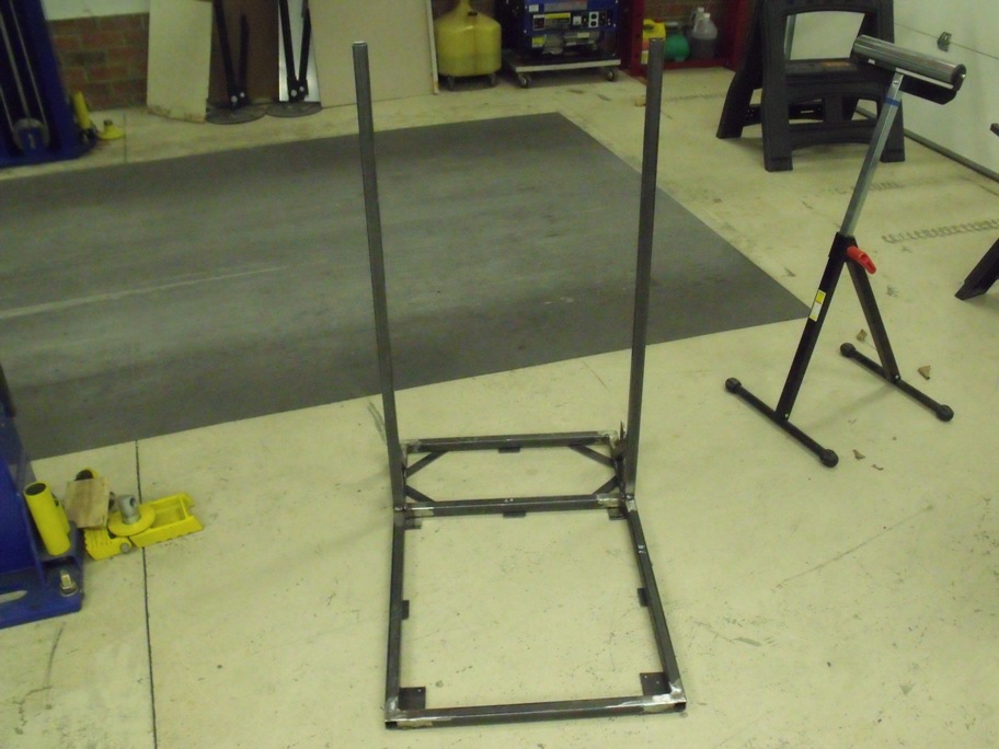

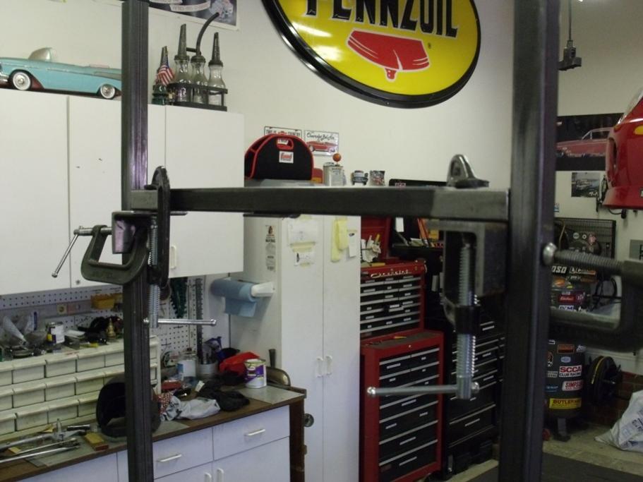

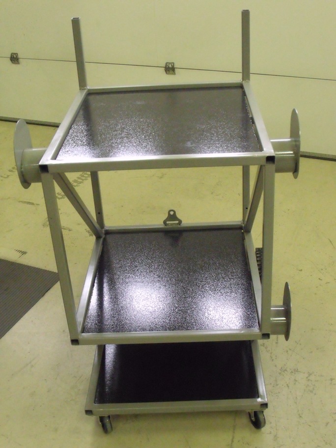

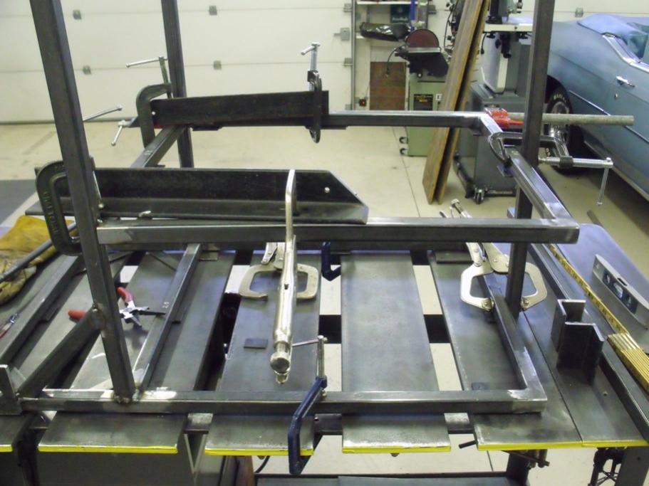

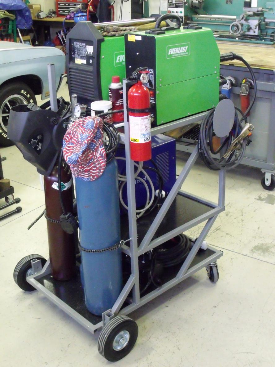

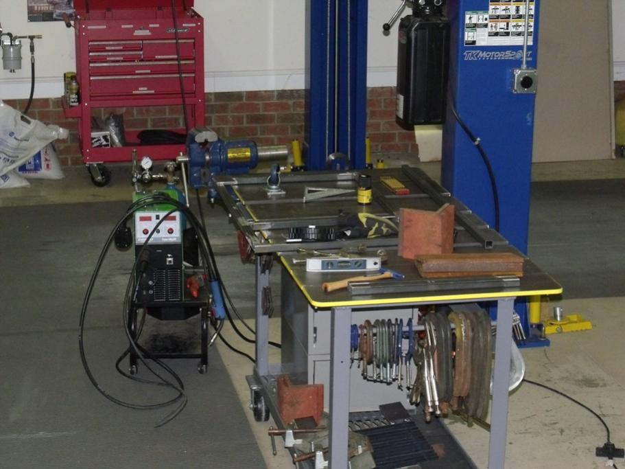

    Here are a few pictures of the build.
    The sq tube is 1x1x14ga. For the shelves I used Corian counter top material, there is a counter top shop near by and he let me have some scrap, I just welded 1/8 thick short tabs and dropped in the Corian. Painted it with fusion paint and it holds up better then I expected.
    If you have all the measurements of your welders and future welders use those to size your cart, thats the great think about DIY you can tweek it to fit your special needs Thats what I did.
    The water cooler needs no regular maintenance so is a good candidate for the lower shelf.
    I designed and built the welding table in the photos also. The shop is my three car garage attached to my house
    My Chevelle is not an SS just a Malibu but it is a convertible with small block power
    Ray
