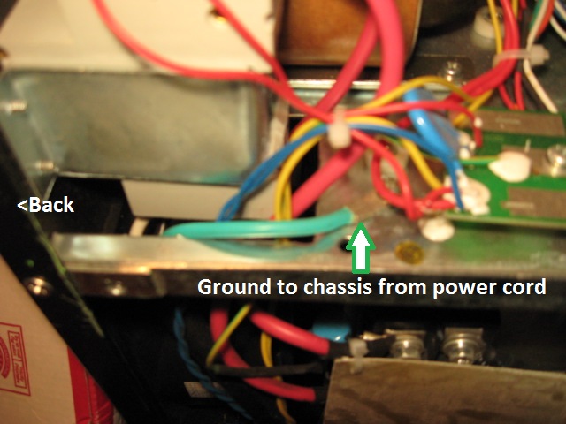

    Don't disconnect the ground going to the panel from the machine. If the machine internally shorts one of the live mains input wires to the case, the ground wire will carry the current back to the panel and trip the breaker. A separate ground rod won't carry the current back to the panel so the breaker can trip. In that instance, the case could be electrified and nothing happen until you touch it.

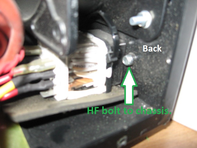

    all zoama said was the HF ground was to the chassis, as well as the ground from the power cable. my logic says then that the whole unit is grounded via the ground from power cable. so unless your ground in your power cable isnt grounded from your main panel, all should be good.

    I think the crux of what I was trying to say was to not install additional grounding rods in the ground. Run your second ground if you like but run it straight to the rod that is currently serving the rest of the household. You now will have two paths to ground assuming your power source/cable is grounded at the box. Multiple grounding rods allow for the possibility of potential to develop between them causing safety and other issues.
