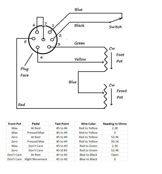

    I am using the foot pedal and have a question about Amps. With the setting on the machine reading 144 amps Butt welding 1/8 steel on DC I get readings anywhere between 54 and 85 while maintaining an arc with the foot pedal fully depressed. I get no penetration. Being pretty new to Tig Is it something I am overlooking or could there be an issue with the foot pedal or welder?

    I took the foot pedal apart and there is just a bit of movement left on the pot at both Min and Max. as it should be.
    I turned on the welder and rotated the pot by hand from Min to Max the readout at the welder was set at 127 amps and when I rotated the pot the amps increased up to about 73 amps at about half way then as I kept increasing the pot my readouts actually decreased to about 45 at full max.
    Bad pot maybe

    Sounds like a faulty pot. It's a common 47K pot. Either you can give EL a call, or any good electronics store like radio shack should have one. A 50k pot will work just as well.

    I agree it sounds like you may have a faulty pot (potentiometer). To verify, if you have a multimeter, put it on the pot wiper (middle leg) and an outer leg, and as you rotate the pot, observe for any "sudden jerkiness" in the ohm value reading. With a good pot, the ohm value reading should change smoothly / continuously. If you find the ohm value is "spiking" or jerking around, it's time to replace the pot.

    Anyway, Turn off the up slope/downslope and the start and end amps. Make sure it is on 2T and use the torch switch and tell us what you have.
    Mark
    I hooked up the original torch and ran it in 2t set readout at 101 amps and read 98 to 100 while maintaining an arc, the puddle was like it is supposed to be. So I am guessing (hoping) it is the pot on the foot switch? Do you know if the low profile foot switch is available yet? The high one is somewhat bulky and uncomfortable and if I need to replace it I would just as soon get the newer version.

    Sounds like it is your pot. I'm thinking of getting a low profile pedal myself. I would of course keep the OEM pedal for backup. I did change out the pot on it though. It's a simple r@r for most of us on this forum.
    I was just at a radio shack last night, and can verify they have a 50k pot. It looked decent quality, and only cost $3.xx.
    IMO, you should have your footpedal adjusted so it can reach as close to 100% max power output the machine is capable of as possible (i.e., with pedal at full down, and current adjustment knob cranked all the way up.)
    A two watt is required.
  20. Default Pot schematic
Name:	200ever foot pedal.jpg
ID:	4019Here is a pot schematic and it is a 50 k pot to test with an ohm meter.If you want to go to a Miller style check out scc electronics, they have everlast pedals.
